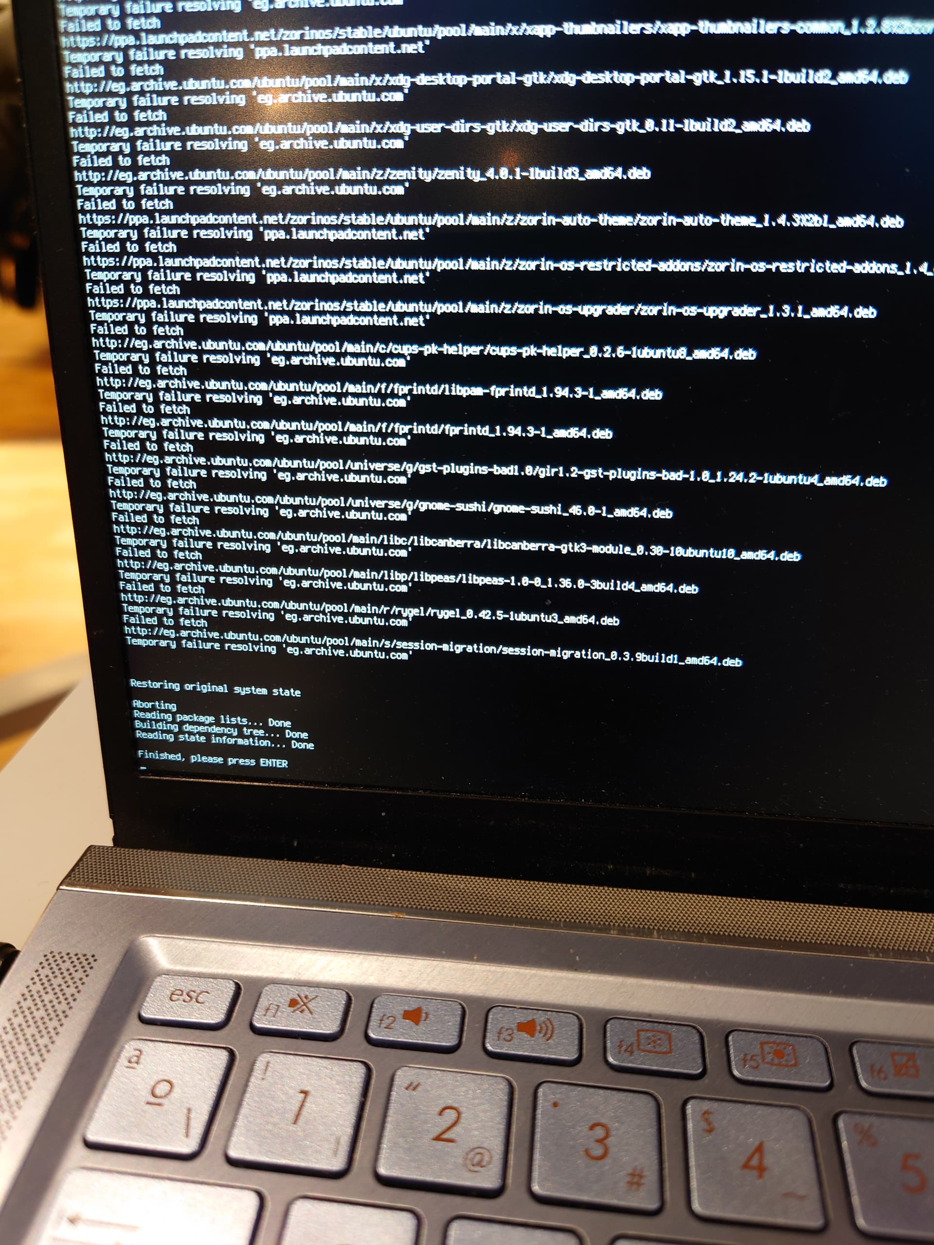

Repairing packages gave this

In your repairing packages portion, it states it's not able to fetch the packages. I would wager this may be because your wireless on your laptop isn't functioning at that point in time with the system. Would you be able to plug in via ethernet (or USB sharing internet with a cell phone) in order to get a physical connection to an internet source? Just to see if repairing with a physical connection can get you up and running again.

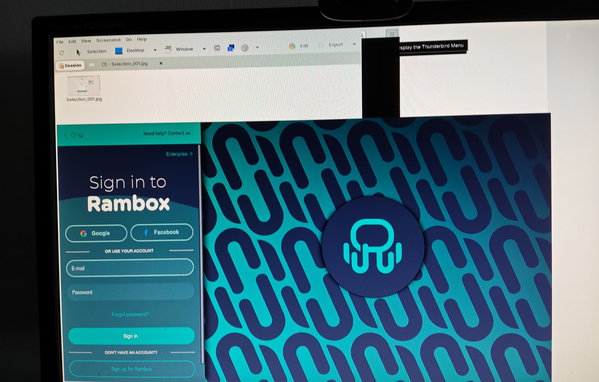

I had the Oops Something went wrong screen twice trying to upgrade from 17 Pro to 18 Pro. On the third and later attempts, it loaded to a Thunderbird, Deja Cup and Rambox screen and froze

Sharing internet with phone+usb didn't work.
