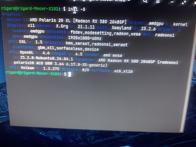

and now
inxi -G
Graphics:
Device-1: AMD Polaris 20 XL [Radeon RX 580 2048SP] driver: amdgpu v: kernel
Display: x11 server: X.Org v: 21.1.11 with: Xwayland v: 23.2.6 driver: X:
loaded: amdgpu unloaded: fbdev,modesetting,radeon,vesa dri: radeonsi
gpu: amdgpu resolution: 1920x1080~60Hz
API: EGL v: 1.5 drivers: kms_swrast,radeonsi,swrast
platforms: gbm,x11,surfaceless,device
API: OpenGL v: 4.6 compat-v: 4.5 vendor: amd mesa
v: 25.2.8-0ubuntu0.24.04.1 renderer: AMD Radeon RX 580 2048SP (radeonsi
polaris10 ACO DRM 3.64 6.17.0-35-generic)
API: Vulkan v: 1.3.275 drivers: N/A surfaces: xcb,xlib
am i missing drivers?
no don't worry,
that is the most important, inxi doesn't parse correctly the driver status
you can test and tell me
how do i test it?
