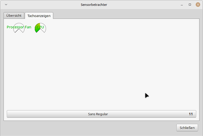

These are the settings of the plugin:

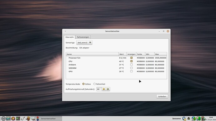

I had to enable the sensors in the tab sensors (and I also disabled the title, but that is not neccessary)

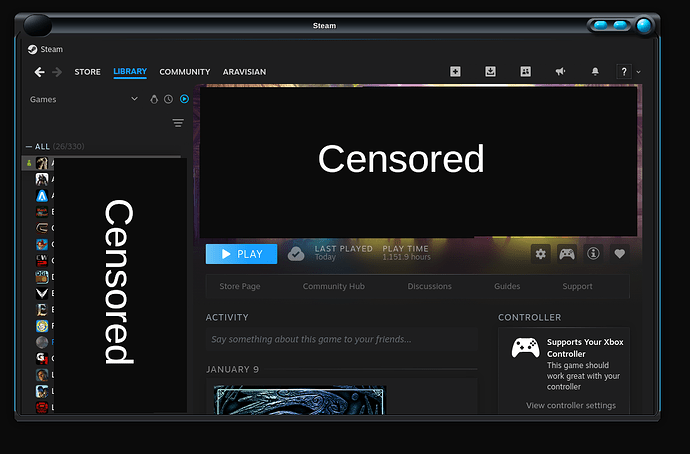

I find it rewarding in that those steps lead to steps that allow further control: For example, I tied Steam into it so it respected not just the icon, but the entire System Theme including window borders, which Steam UI really does not want us doing (And I don't like being told what I cannot do.)

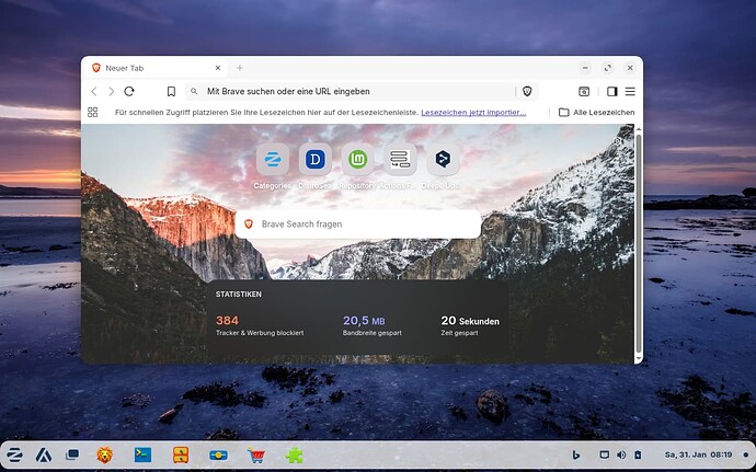

Until just now, when I opened Brave Browser in my Zorin 17 lite VM, only the icons pinned to the taskbar were visible and no new icon for the Brave Browser tab appeared when I opened Brave.
Unfortunately, I clicked on a different layout in Zorin Appearance because I wanted to simulate the LM look and my taskbar settings were reset. Now I can't get it back to how it was. Previously, no indicators for running apps were displayed, but now they are.
In any case, the Brave browser icon is displayed correctly in Zorin 17 lite, except in the workspace overview.
Not so on LM XFCE based on ubuntu 24. Maybe something has been changed or it is a problem of the icon theme.
Bildschirmfoto_2026-01-31_08-06-46
I´d like to have it like in my gnome session. The browser is opened at the icon, there are not two icons for the browser. The screen capture don't show the indicator, but there is a line under the icon of Brave browser so that I see it is opened.
