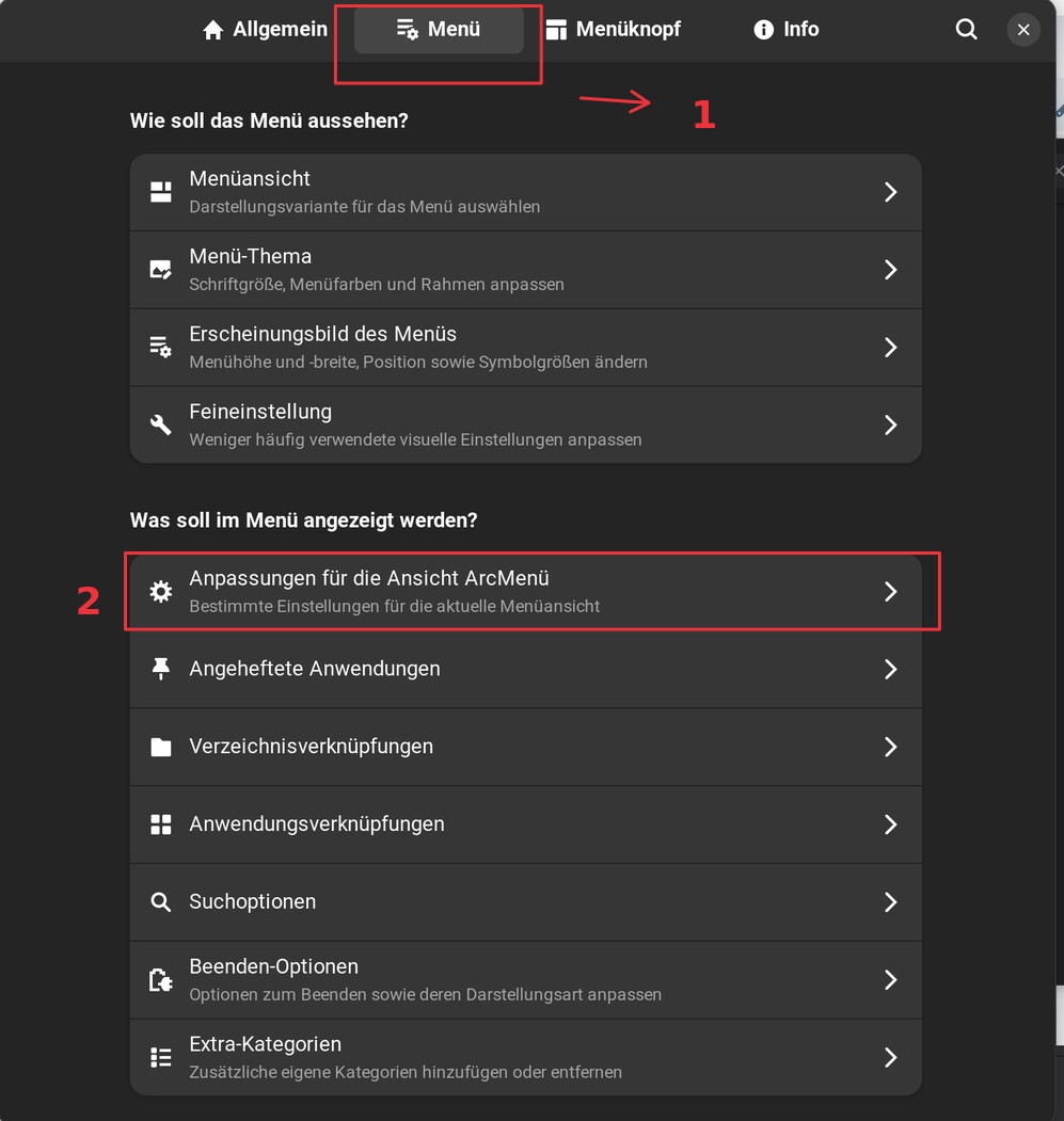

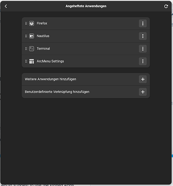

But You want add manual Apps. For this, I would suggest to take the Option ''Pinned Apps''. With that, You can in the ArcMenu Settings add Entries for that.

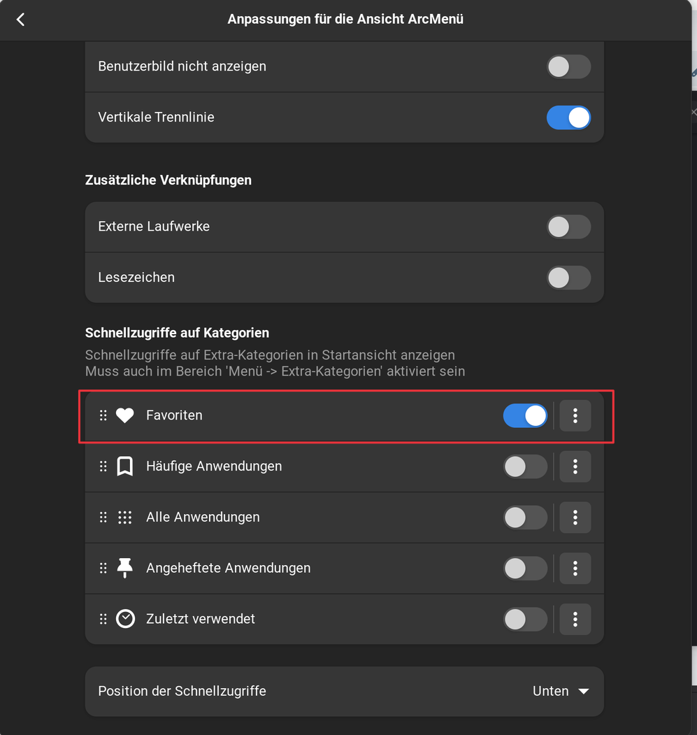

To activate Favorites, open the ArcMenu Settings an then:
1:
2:
3:
4:
Then You get the ''Favorites'' Menu entry filled with Favorites:

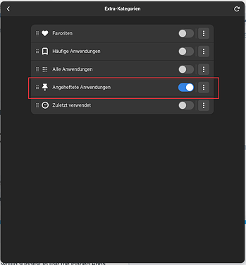

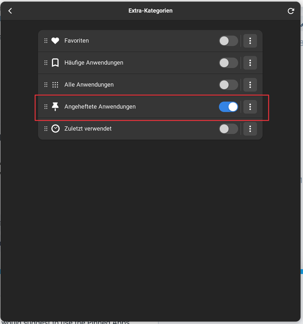

But when You want fill it by Yourself, I would suggest to use the Pinned Apps Option:
1:
2:
3:
4:
5:
6:
And here You can manually add Programs and sort the Order.

You can set this at menu>What shall be shown in menu>Settings for [mint] layout>open categories with mousetouch

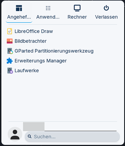

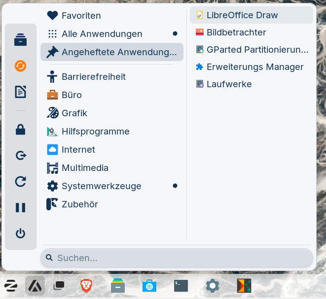

Here is a screenshot of my arc menu. I added "pinned apps" because at "favorites" only the apps from my taskbar are shown. You can add the pinned apps in menu>what shall be displayed in menu>extra categories (I don´t know the exact name in English)>enable pinned apps here.
When I move the mouse over "pinned apps" they are shown and I can open them. On the left side I also added some for faster access. I can choose any of my installed apps.

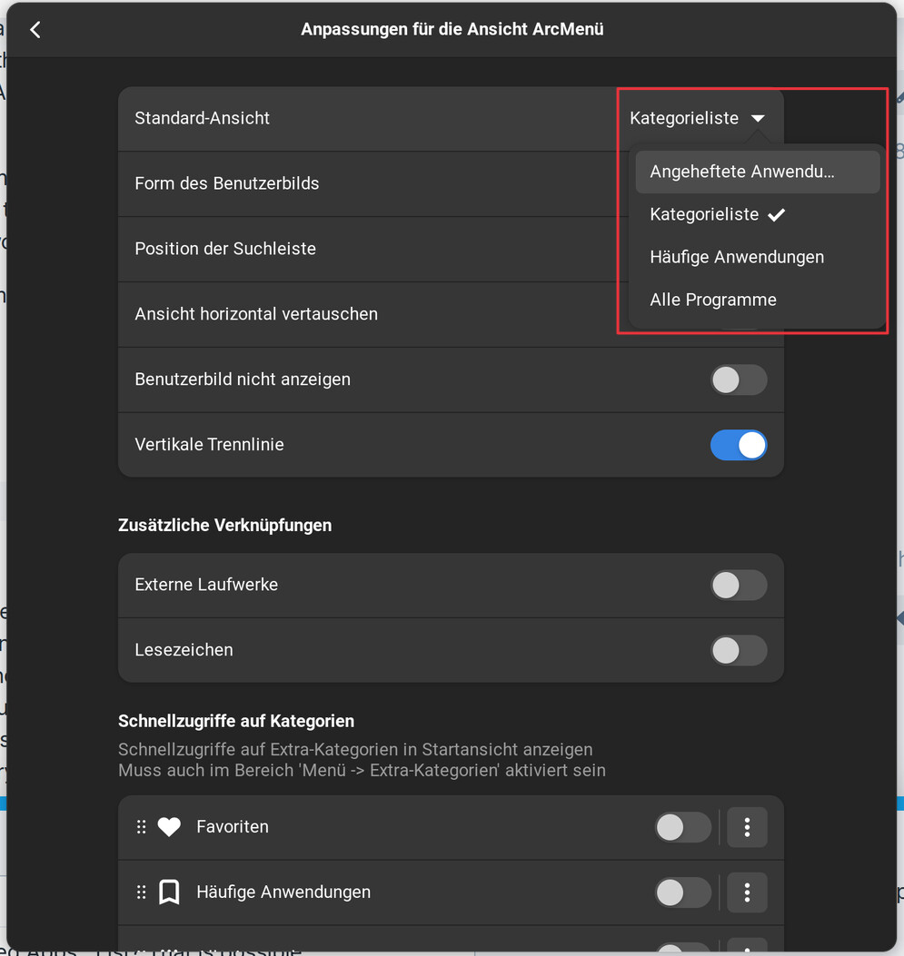

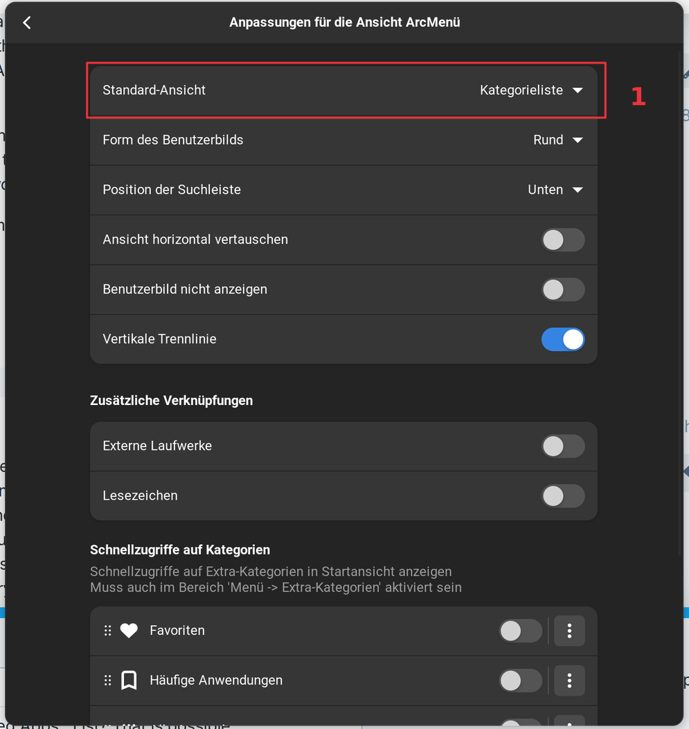

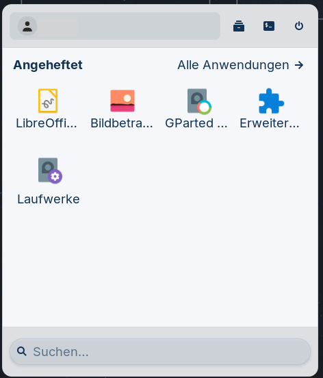

So, You want directly be in the ''Pinned Apps'' List when you open ArcMenu? That is possible.
1:
2:
3:
So, choose in the Dropdown Menu the Option for Pinned Apps. And then You should see in ArcMenu directly the List with all Your Pinned Apps. I tried it by myself and it should work.

Enable all apps, favorites and pinned apps or further ones at "extra-categories" at tab "menu" then you should be able to set them here.
Here are some ideas for the menu. There can be displayed all apps or only the pinned apps when click on start menu. It depends on the layout, also if they are displayed as list or as tiles.
