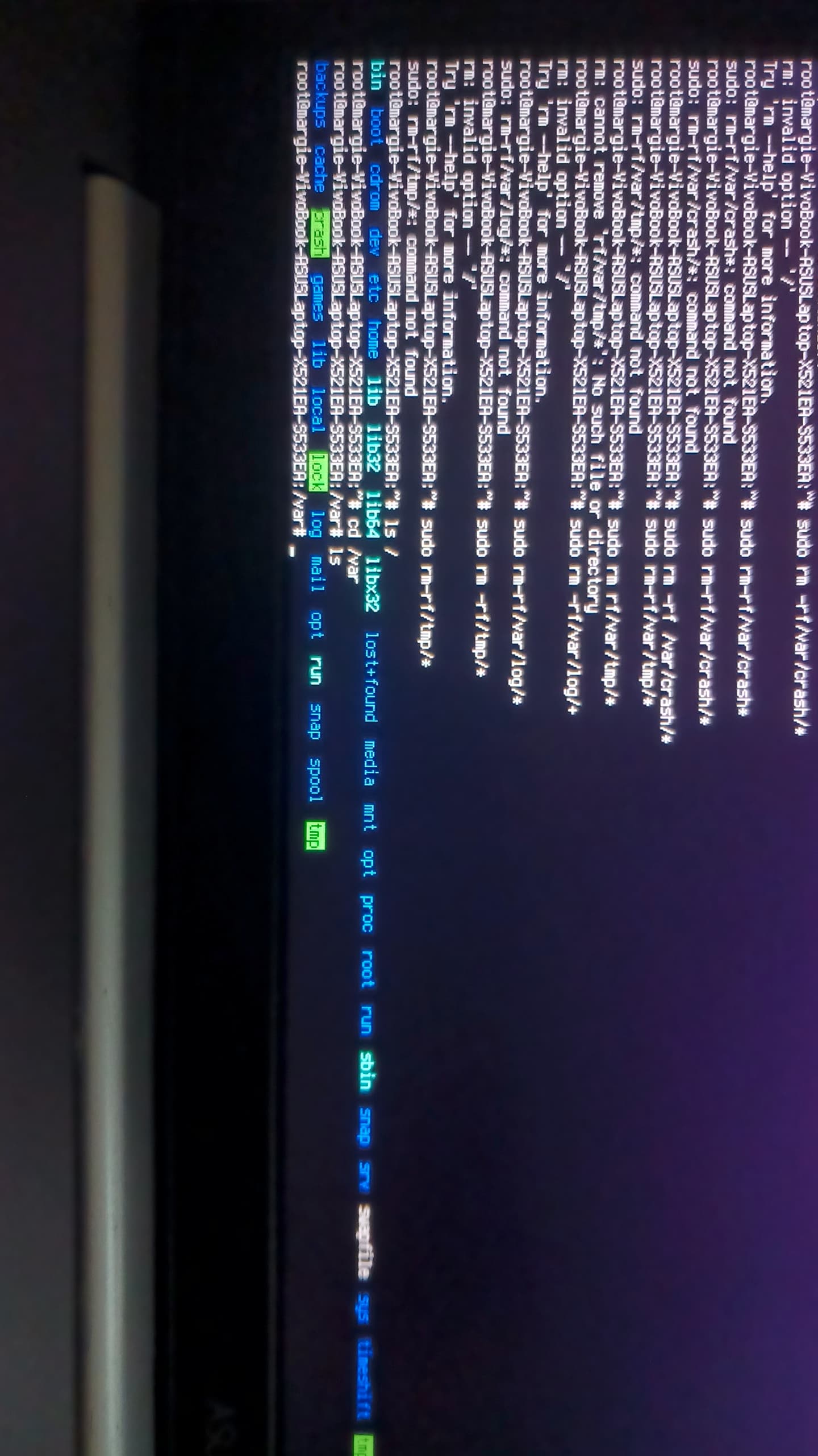

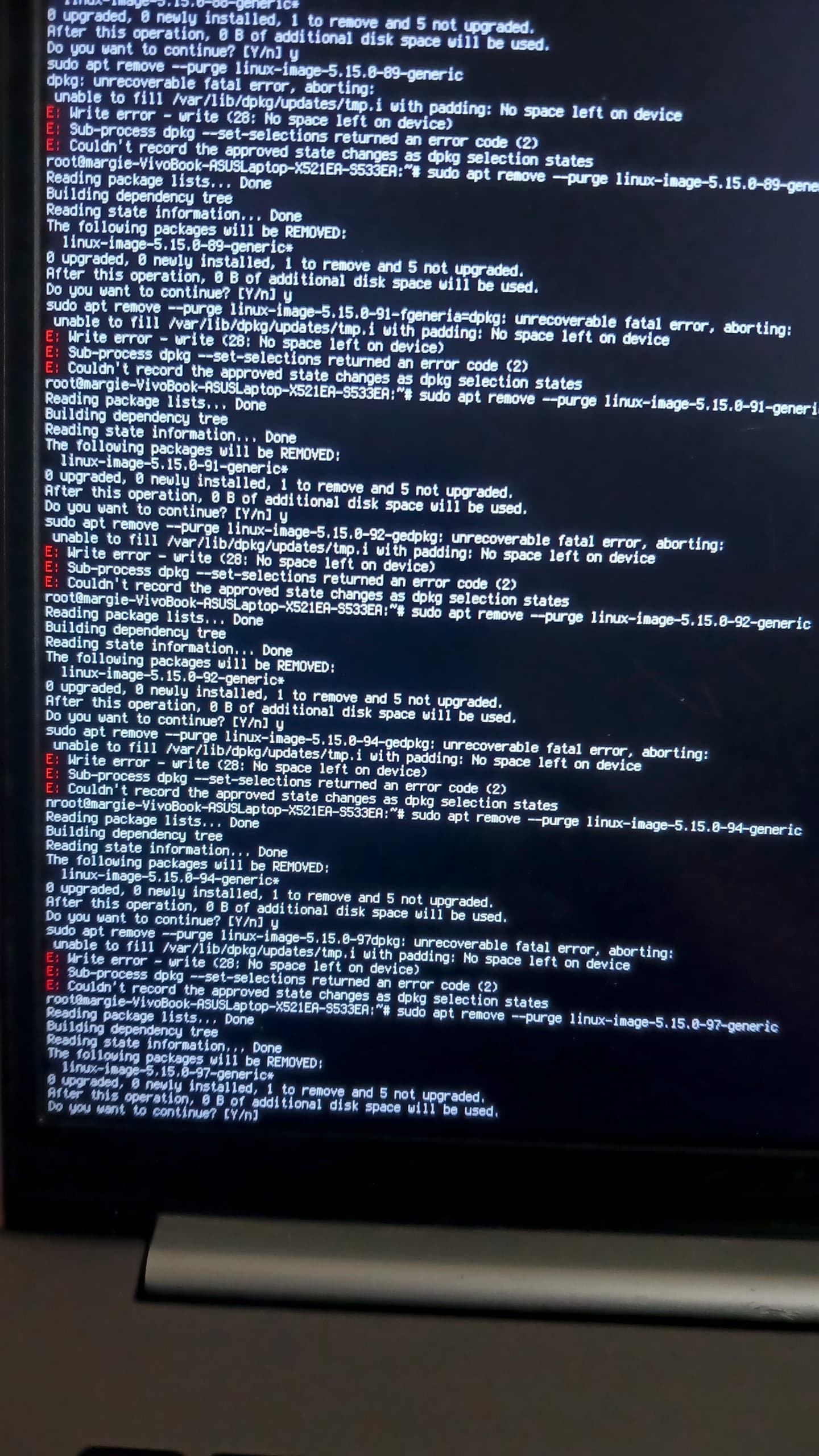

So, I entered each one again, with generic this time, and the screen shot shows what the result was. Red E's are shown after every entry a few lines down. I don't know if I should proceed and answer no to the continue prompt and go back to the grub BIOS screen to finish this process out, I'm not sure what finishing it would entail, or should I back out of it because there's a problem?

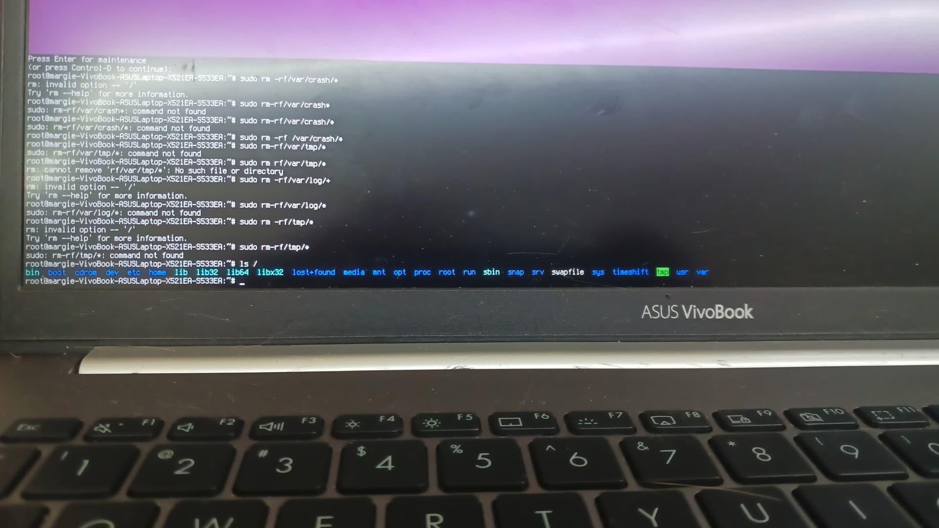

I tried the first command....sudo rm -rf/var/crash/* and got the message command not found. I couldn't tell if there was a space after rm and then after rf so I tried it both ways; sudo rm -rf/var/crash/* and sudo rm -rf /var/crash/*. Both had the same result.
It may be that you lack a crash directory.
What does that mean or what do I to do about it?

It would mean only that no crashes have been documented - that it is missing is harmless.
Were the other commands successful?
On `Timeshift, @swarfendor437 has answered this quite well.
I ran each of the other commands with a space between rm and -rf and without a space between rm and -rf and without the space the answer is command not found. With the space it says invalid option. Each of the commands had the same outcome.
/var/tmp/
/var/log/
/tmp all should exist.
This is very odd... Can you run
ls /
and relay the output here?

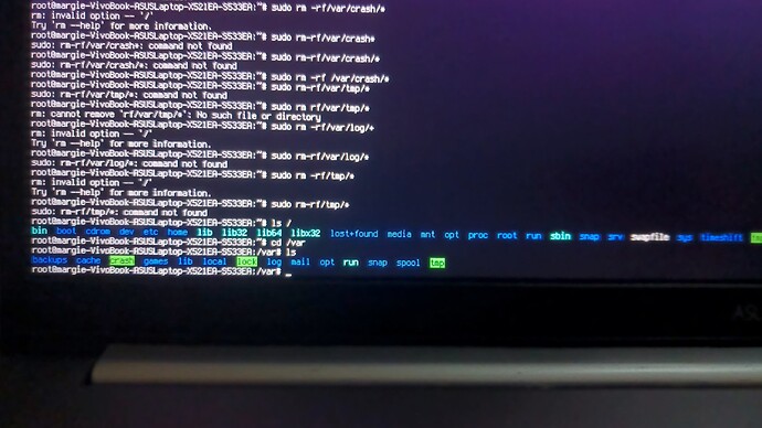

Here you are.
Well, /var is present and so is the rest of root. That is good
Can you
cd /var
then
ls
Okay. I tried to turn the picture around but I don't know how to do that in zorin os lite.
EDIT by Zabadabadoo to rotate screenshot.
This shows all those folders as present.
