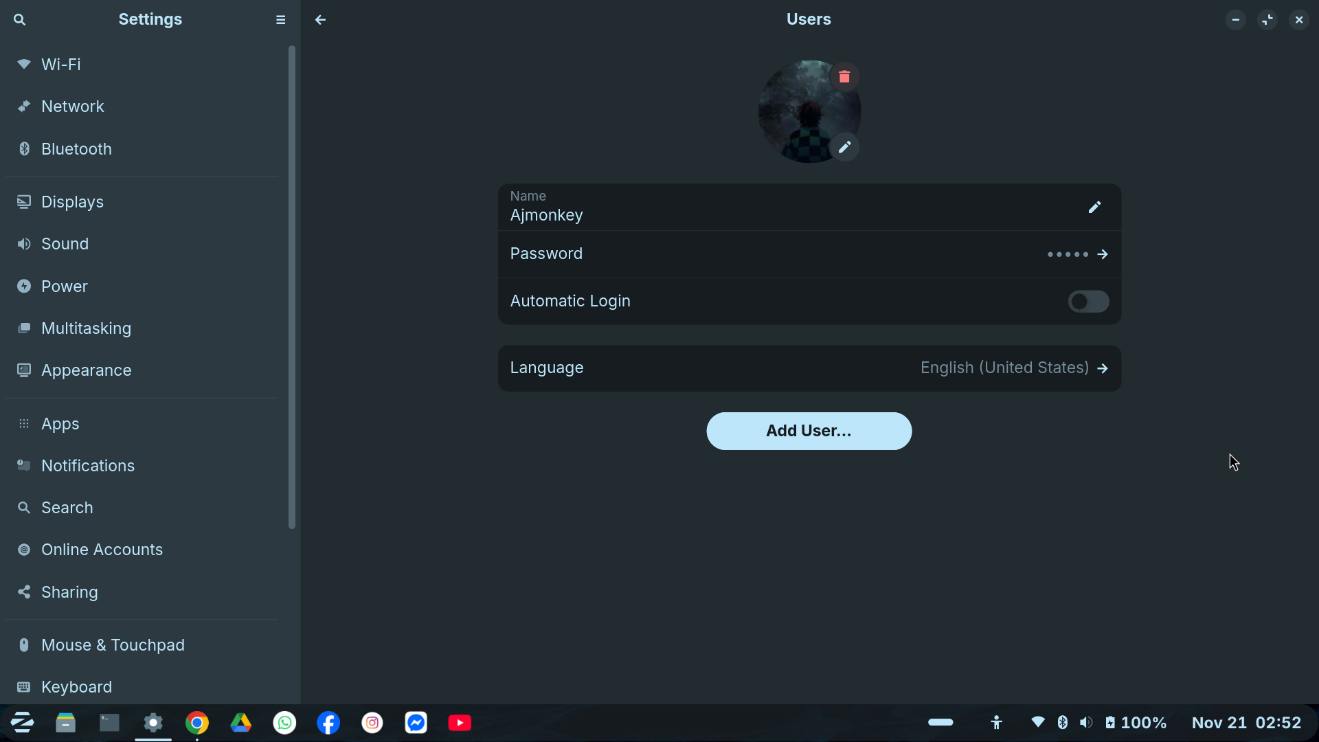

After using zorin os core for a few days I realized that my fingerprint scanner is not showing the user option. I can not use my fingerprint reader to unlock my laptop. It would be helpful for me if there were any options to get it back on

I used the method shown by the zorin help option but it didnot work either.

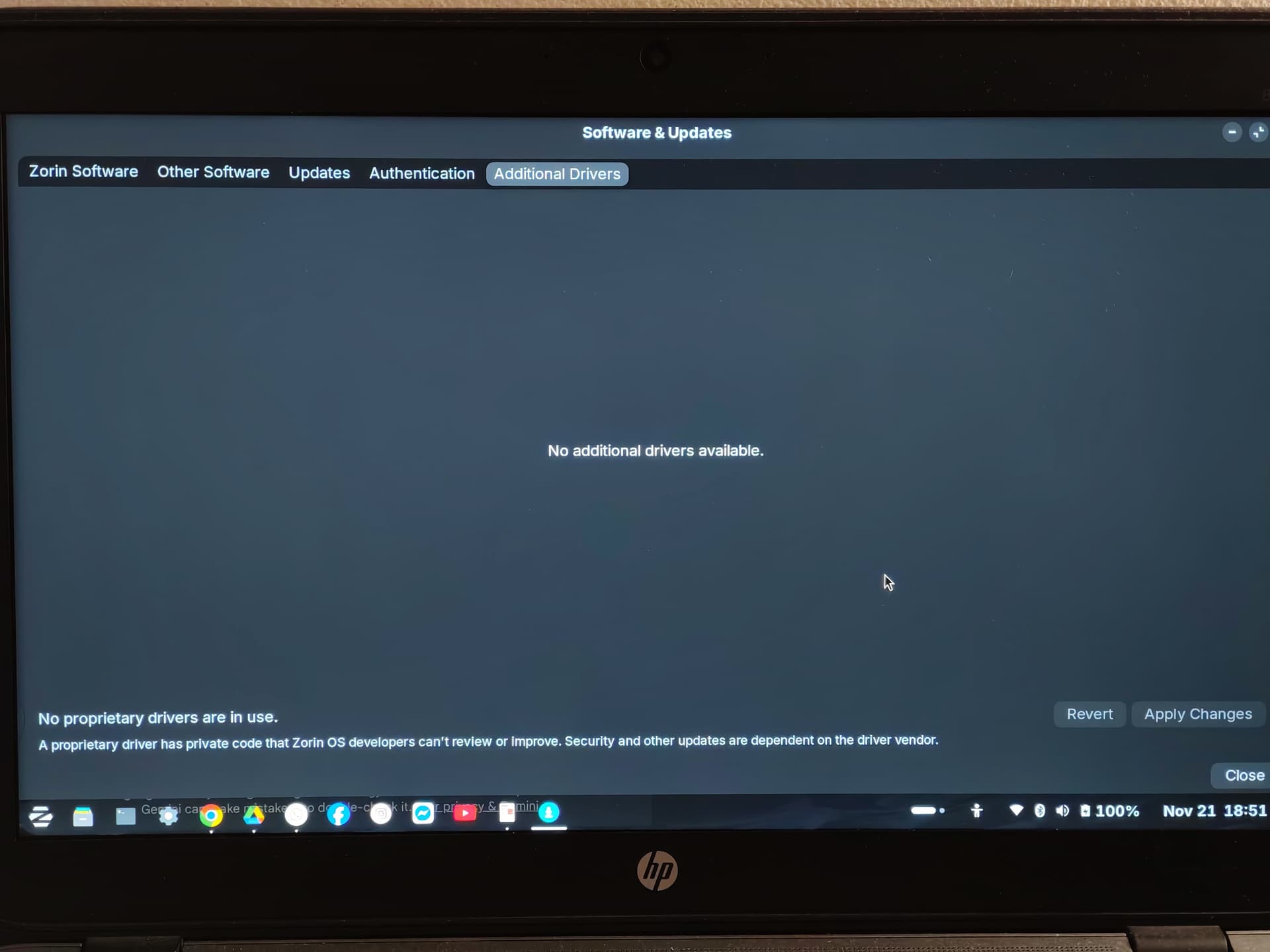

Got to Additional Drivers, please see if there is a driver for your fingerprint reader, and if there is, please select it.
Unfortunately there are no additional drivers. Does that mean my fingerprint reader won't work?

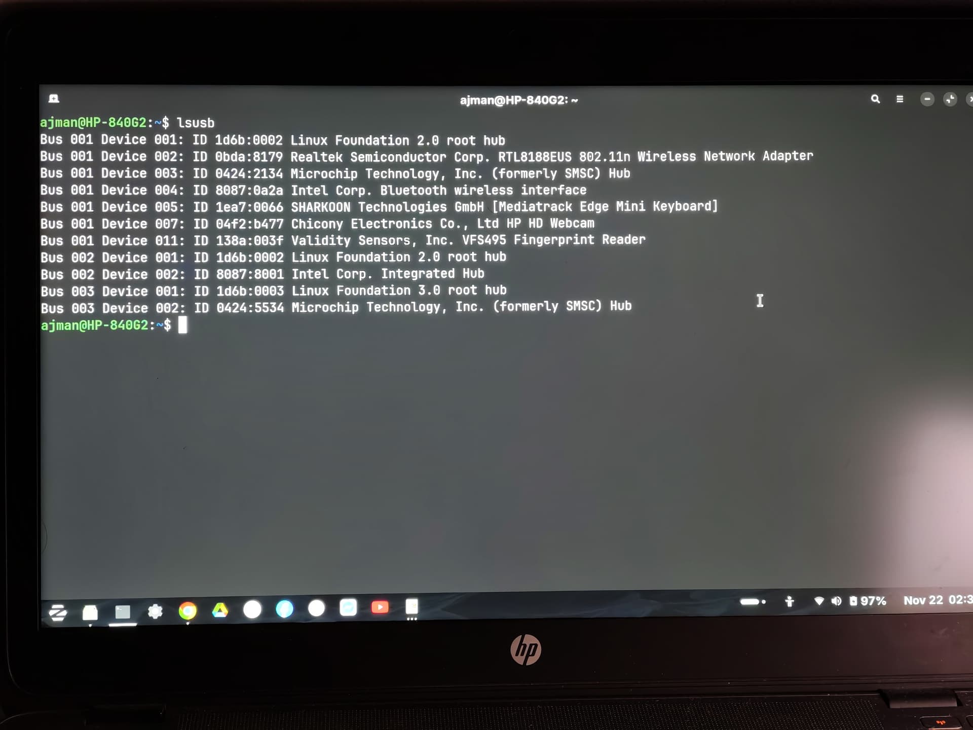

As fingerprint readers us USB, please enter in a terminal:
lsusb
and post back the results please.
It seems that it is not supported in Linux

Here it is
On device 011 there shows a validity sensor, fingerprint reader
As @Forpli has stated, the Linux kernel does not support that hardware. What you need to be aware of in regards to the Linux hardware site is there are 2 types of hardware unsupported status, outright 'failed', and 'detected'; this latter classification indicates that a distribution has recognised the device, but it won't work as there is no driver for it. You need to appreciate/be aware that hardware manufacturers are not going to waste their valuable time for the benefit of GNU/Linux users when the predominant OS in use is that other OS. A lot of hardware that has been made to work with the Linux kernel is down to volunteers who have managed to do some reverse engineering like the teenager from Sweden who was put under house arrest for enabling DVD devices to work on Linux, which hardware manufacturers declared a breach of Copyright.
