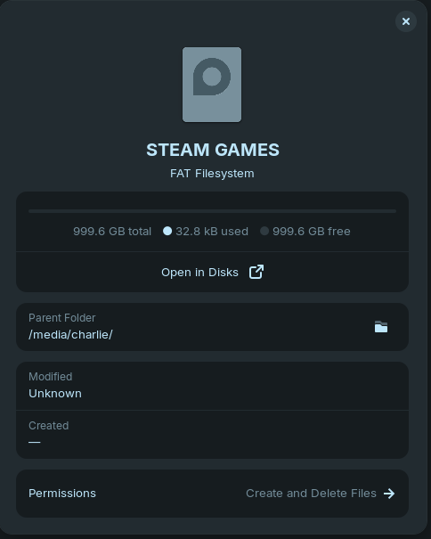

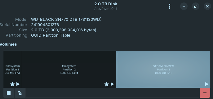

Hey there! I would like a bit of assistance. So, I installed Zorin OS yesterday. I originally set it up to where I would have a partition setup for Zorin so I may use windows and Zorin on my same device when I need one or the other.
In doing this, what I did was setup a partition for my drive. One half would be Linux focused, while the other one would be an "All arounder" that I could kinda use back and forth.
So, I set everything up, OS has been working great, however I can't seem to get the actual other half of the drive to work. I decided to just make it a Linux drive and just use it for storage for my games, but I can't really do anything with it. I'm specifically using steam built in from the Software app, I'm able to do everything in my standard drive no problem, but once I go to Add the other partition to steam, it doesn't register really anything.
I have tried a few things but am ultimately stumped.
I ensured the partition was setup, owned by me, originally setup for Fat32, but then repartitioned as Ext4, and I'm able to add the drive to steam but it acts like the drive is not valid and every time I try to install anything to the drive, it gives me a disk write error.
I'm not too sure what to provide to help people identify outside of showing how my partition is set, so any information you need that would help please let me know as I am very new to linux in general :slight_smile:
EDIT: 2nd and 3rd screenshot were messed up, fixed
It shows as FAT, not ext4.
This is where things are unraveling as FAT32 is limited in what filesize it can accommodate. Most steam games will be well over the four gig limit in FAT32.
You can format it to either ext4 or exFAT. I do not recommend formatting it to NTFS...
Using Gparted, you can select the partition while it is unmounted, then from the gear icon, select to format it. Once the process is done, try mounting it and see if Steam stops complaining.

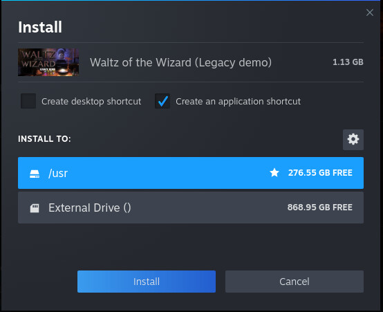

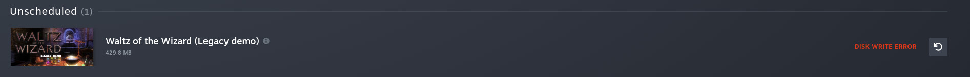

Hey! So like I had mentioned, I did try both Fat32 & ext4, and when I do it in ext4, when I attempt to add the drive, it does something like this
It adds like an external drive, and when I write into it with a game installation, it says disk write error.

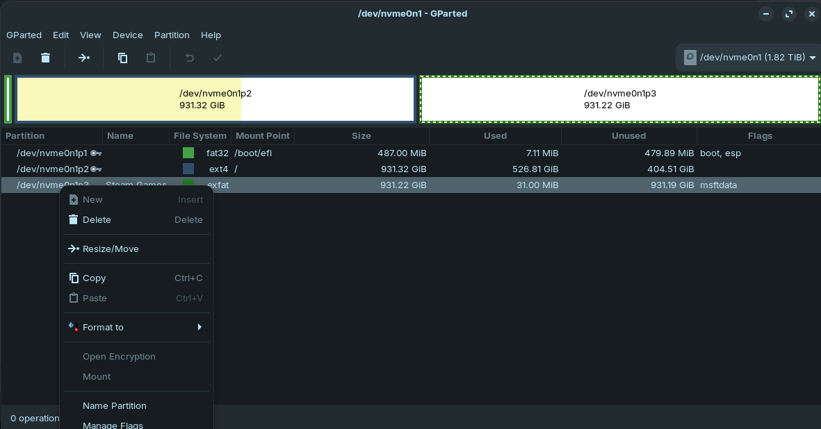

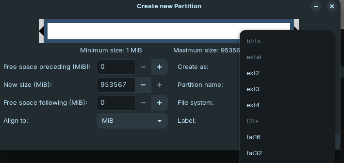

So, I got GParted, and when I try to setup the partition,
and exfat is greyed out, before I just setup as one drive, is there a reason that would be?

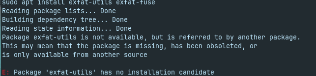

You may need to add compatibility:
sudo apt install exfat-utils exfat-fuse
I have read that you can do it in Disks app, without installing exfat-fuse, but I have never tried it...
Gotcha, I put that in terminal and got this, so it doesn't seem like it installed?
gah... right. We are on Noble repos, now...
sudo apt install exfatprogs

Do you have Steam installed as a Flatpak?
flatpak list
That would cause that error.
It is best to install Steam from the .deb
First, remove the Flatpak Steam, then
sudo apt install steam
It is as up to date as the flatpak is, too.

Alright, so I downloaded steam through this method, and the drive did show up and does seem to work. It still shows as "external" for some reason but at least the games are downloading to it and ones that work on linux (some didn't oh well) seem to be working through that drive.
