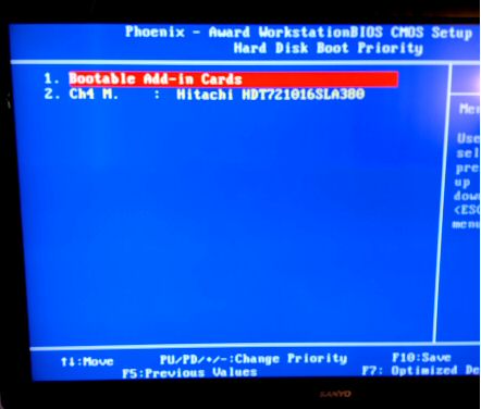

What is a bootable add in card?

I really don't know what to think now and I just found that last picture that I put above here that shows boot priority and it doesn't look normal to me and I don't
know what might be acceptable there.
It is normal. Add in cards are additional drives like SATA drives, SSD, RAID controllers...

Did you see the pic above that shows boot priority and shows that??

When I made it to that boot priority in the bios... the cards were second, hard disk first and I made the cards first.
This was logical and you can leave it at that.
The Logic was that you are seeking to get the BIOS to register your USB stick and... that would qualify as a Bootable Add In
If there are no bootable add in cards connected, then the boot will proceed on the hard disk as normal. So there is no need to revert that.
