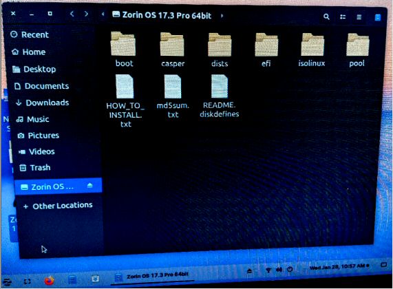

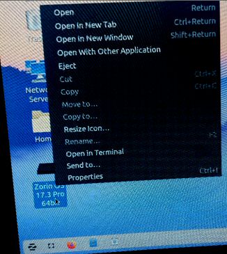

I don't know what I might be doing wrong... I had the usb drive plugged in and turned pc on and I expected it to start an install process but it didn't do that... It did show the USB as a file on the desktop. So I thought I should double click it to see if it would start installing there... and that's where I start getting the message that I have to authenticate the admin password.

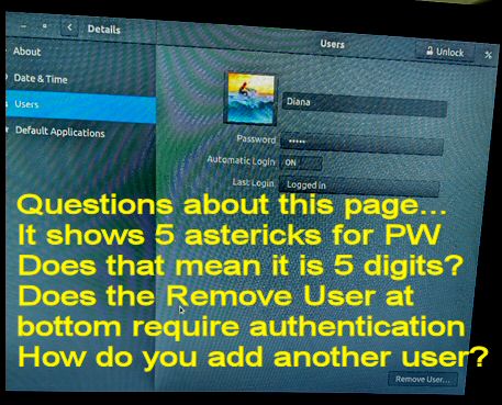

I have prepared photos of my adventure today and hope it assist you in seeing what my problem is because I just don't understand this. I optimized the photo sizes and each is in kb's .. hoping they load easy for you. I have written notes to you on some of the photos.
They are all .jpg's.
There are 18 photos total.

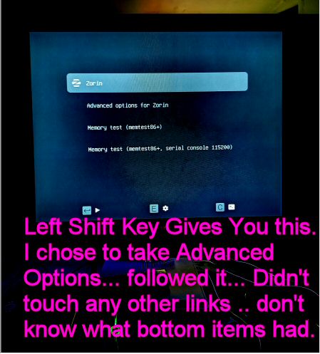

I tried the delete key, F10 key, F2 key, ESC key, and the left shift key was the most fruitful key.
The F12 key immediately gives the blue screen with enter password in the center.
Sure would be nice to have a password!

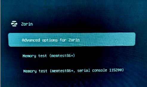

The left shift key gives the Zorin Advanced Options page.
I typed a lot here for Aravision and posted 18 photos and now I don't see them and don't know what he will see or not see. And a lot of them had notes on them for him. Then when I came back here to check it said new users could only post 10 items and I have been a user for many years and had posted 18.

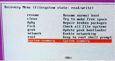

OK, firstly, welcome back after a long time. In terms of your 15.3 Pro. So long as you are definite that there is no important data on there you could use a live usb to 'Try Zorin' and get back data that way should you need to.
In terms of the password that you set, even though you set it to autologin, you could try, but not guarantees on this, to use the password reset procedure. (I have a sneaky suspicion that you may not be able to if it has registered the password against 'root' only which is always hidden.)
To reset a forgotten password, use the advanced options and drop to the recovery menu and choose the bottom menu item of 'Drop to root shellprompt'.
When the terminal screen opens, press the Enter key to continue, and it should then show your details followed by a '#' to indicate you are now root.
To reset the password enter the following:
mount -rw -o remount /
as you know your username enter:
passwd username
Replace 'username' with your actual username and press Enter.
Then you will be asked to enter a new password twice, once done and you have pressed Enter it should come back with:
"Password successfully changed for [username]".
Now power off and then switch back on again. You should now be able to get back into your Zorin 15.3 Pro.

This establishes that F12 key is the correct key to press to choose the USB stick to boot from.
That it is not showing up tells us that either the USB Stick is not being read in the port - I have a USB port that you need to press down hard on the USB Stick for it to be read - I avoid using that port...
OR
That the .iso was not actually burned to the USB stick as a bootable media.
