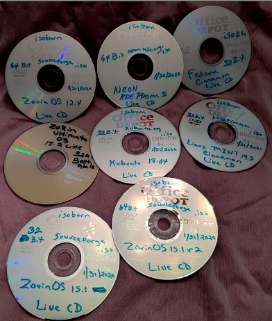

Just a few lying around and easy to reach :joy:
