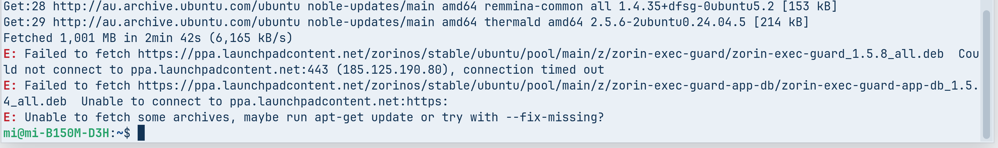

Can you please check if everything is running well by entering
in the terminal? Please post a screenshot when you get errors. When you are asked if you want to install the updates confirm with yes.

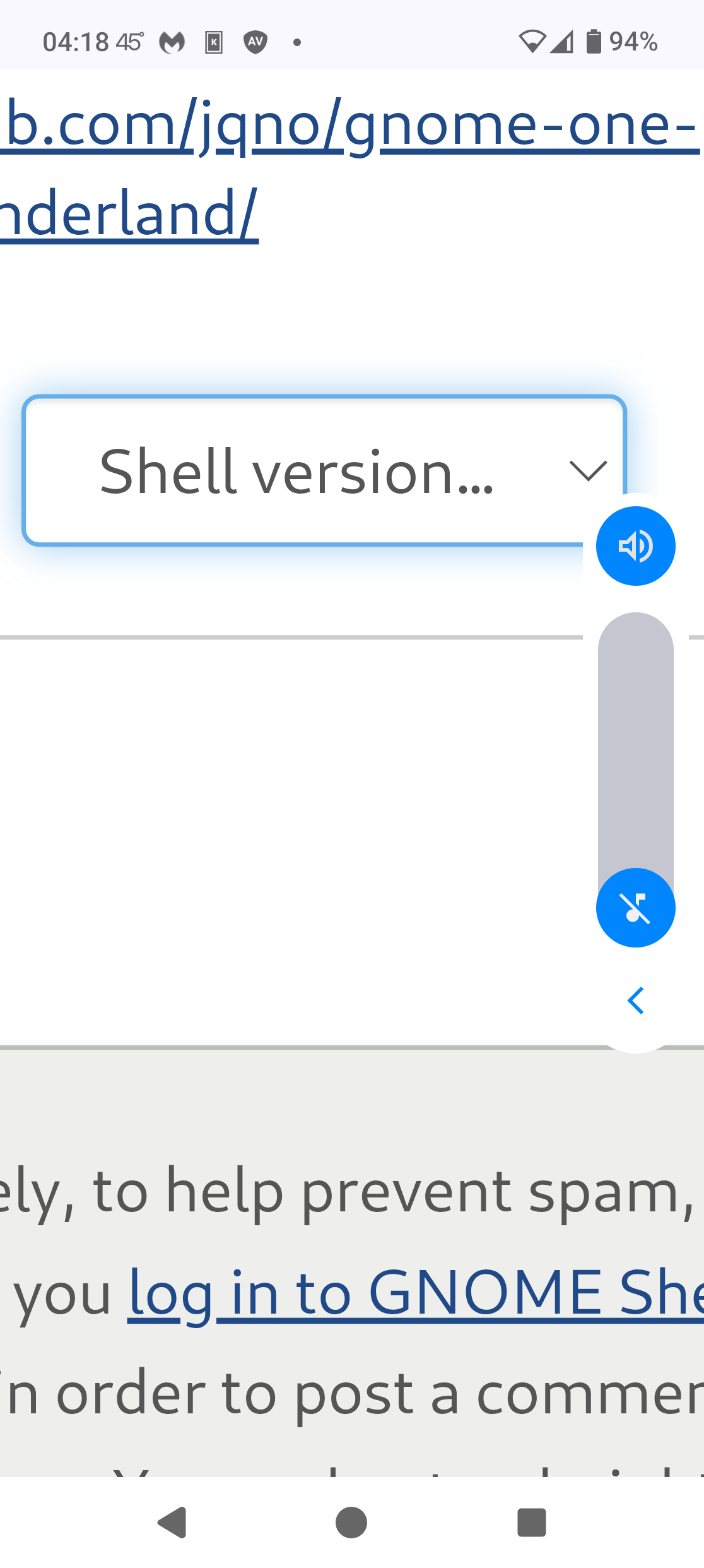

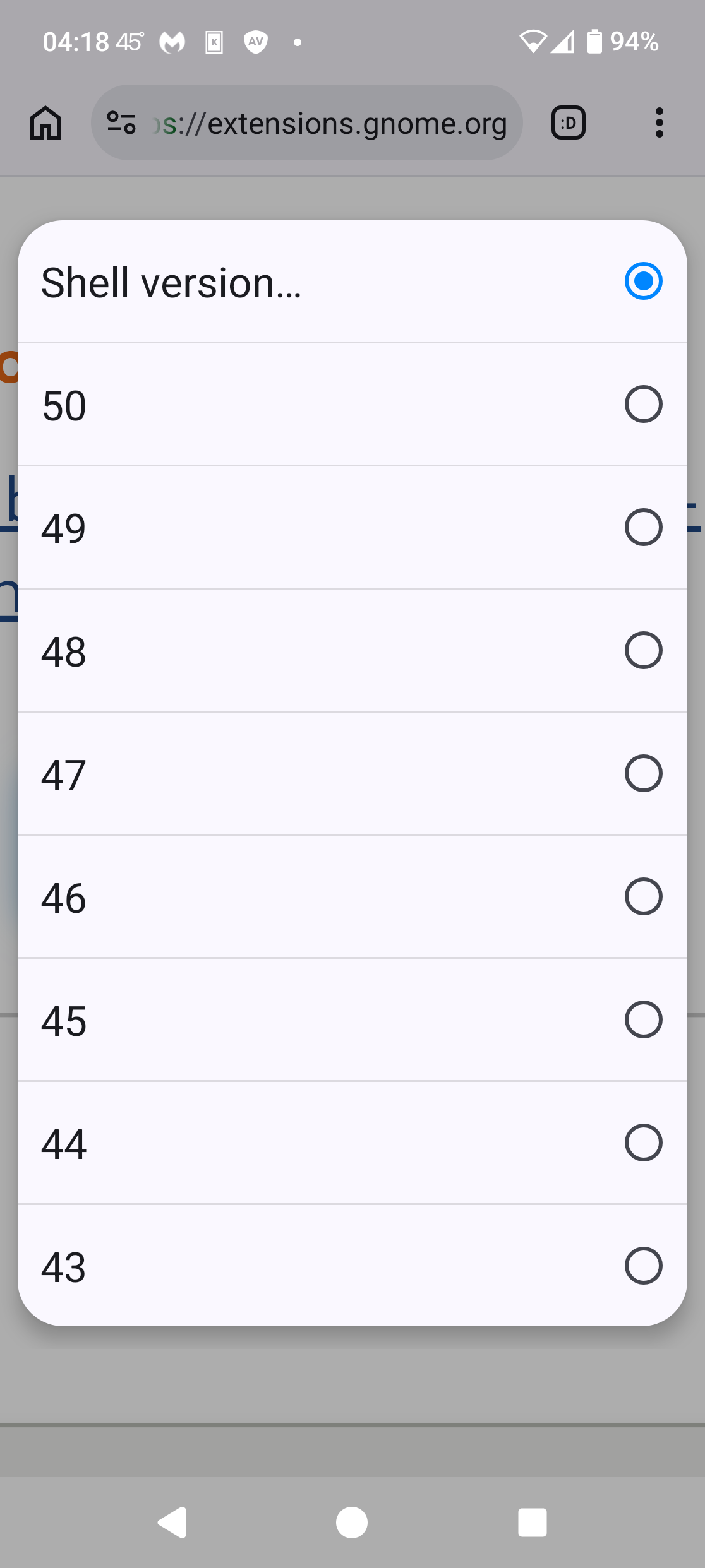

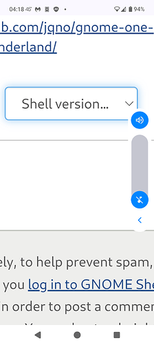

Just had a look at the extension page. Did you download the correct version?
Each number matches the Gnome Shell in use and if memory serves, Zorin 18 uses Gnome 46.
When you install the extension with the extension manager the right gnome version is automatically selected. There is no field to select a gnome version.

Thanks @Forpli and my apologies for slow reply. I am recovering from the flu and at my age it takes a while.
These are the error messages I got from your last post.
I had problems to find and open the extension manager and it did not load when I did the " ```
