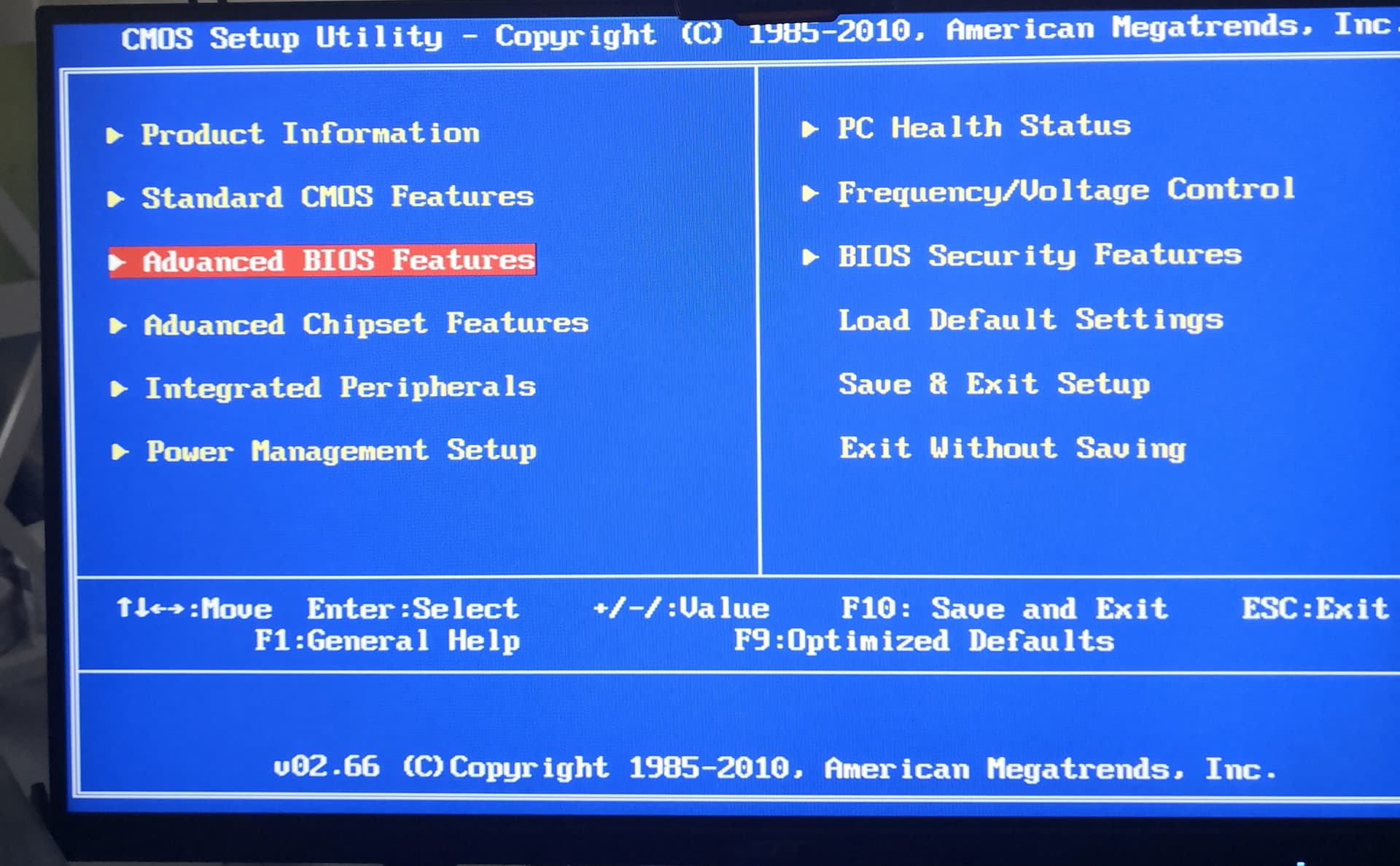

Hello, to access the Bios? my pc: packard bell imedia i5638IT processor 550, 8GB DDR3... at startup I press "delete" and the screen opens...

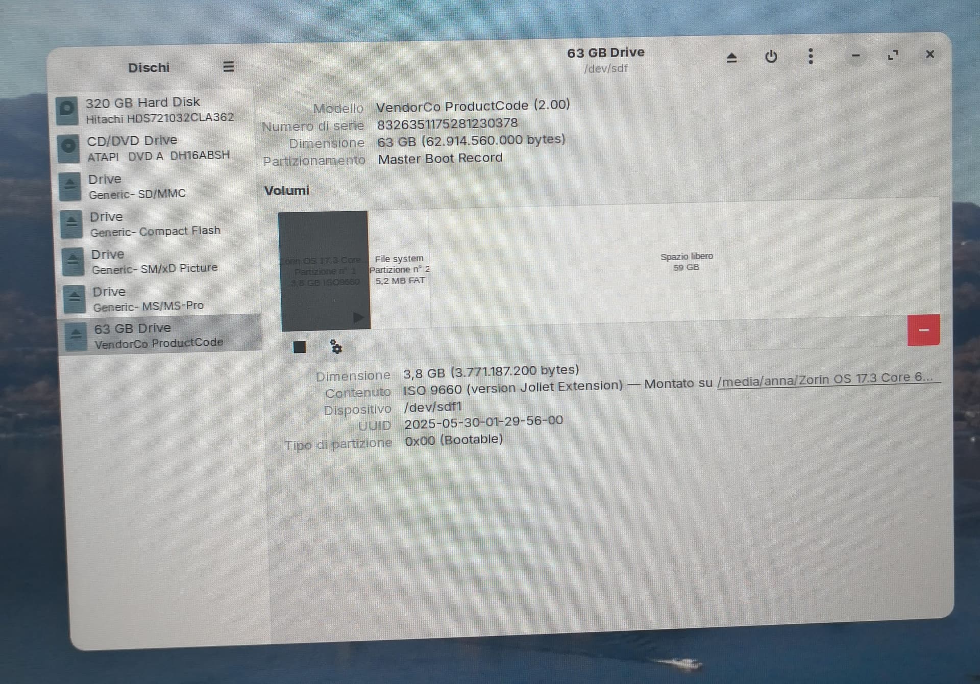

Hello, I used Balena x create the flash drive that has a capacity of 64GB and is unused... Attached are the screenshots of the Bios and the flash drive I have no computer knowledge (I went from windows10 to Zorin OS 17.3 updated two days ago to Zorin Os 18), so please if I have to "act" I ask if possible to "see" how Thank you for your kindness

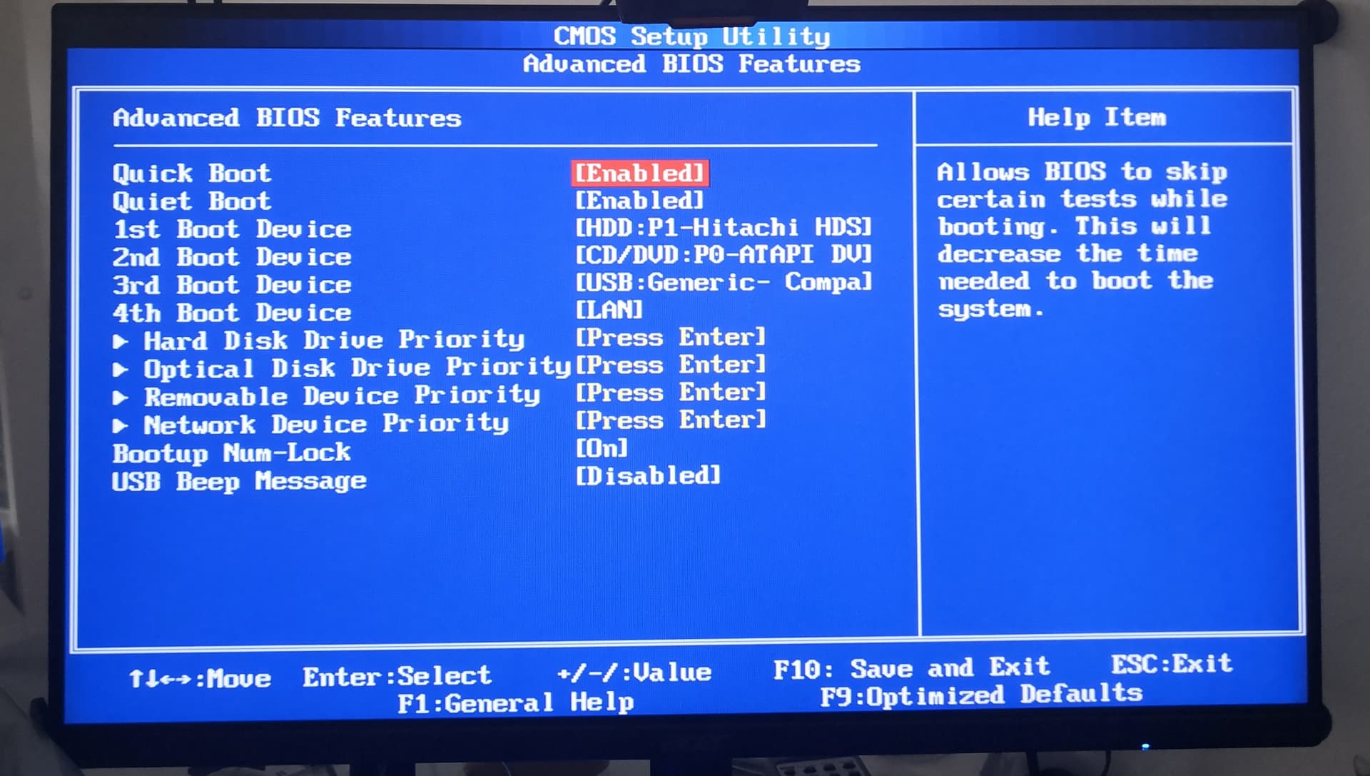

Here You see the Boot Device Options (1st, 2nd, 3rd, 4th). And there choose the 3rd one with the USB if that is the plugged in USB Stick. You ave there the Option ''Removable Device Priority'' too that could help to start from USB Stick, too.
Here You have on the right Side the Option ''BIOS Security Features''. Could You look there if there is ''Secure Boot'' and if it is disabled?
You may also need to check the settings for "Removable Device Priority".
