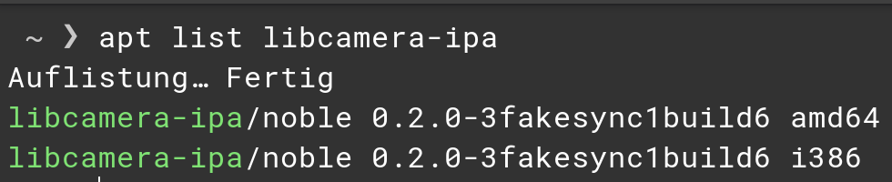

With that:
You have Luck. It is available in the Repo's:
I have fixed that and now conversation shifted into black screen issues when trying to stream video ( zoom, slack etc)
What do you mean by this? Sorry I'm quite new on Linux
It is in the repository, so you do not need to struggle to get it.
In terminal, run
sudo apt install libcamera-ipa
Like @Aravisian wrote: You can simply install it. You don't need to search it or care about Compatibility or Dependencies or even compile it.
