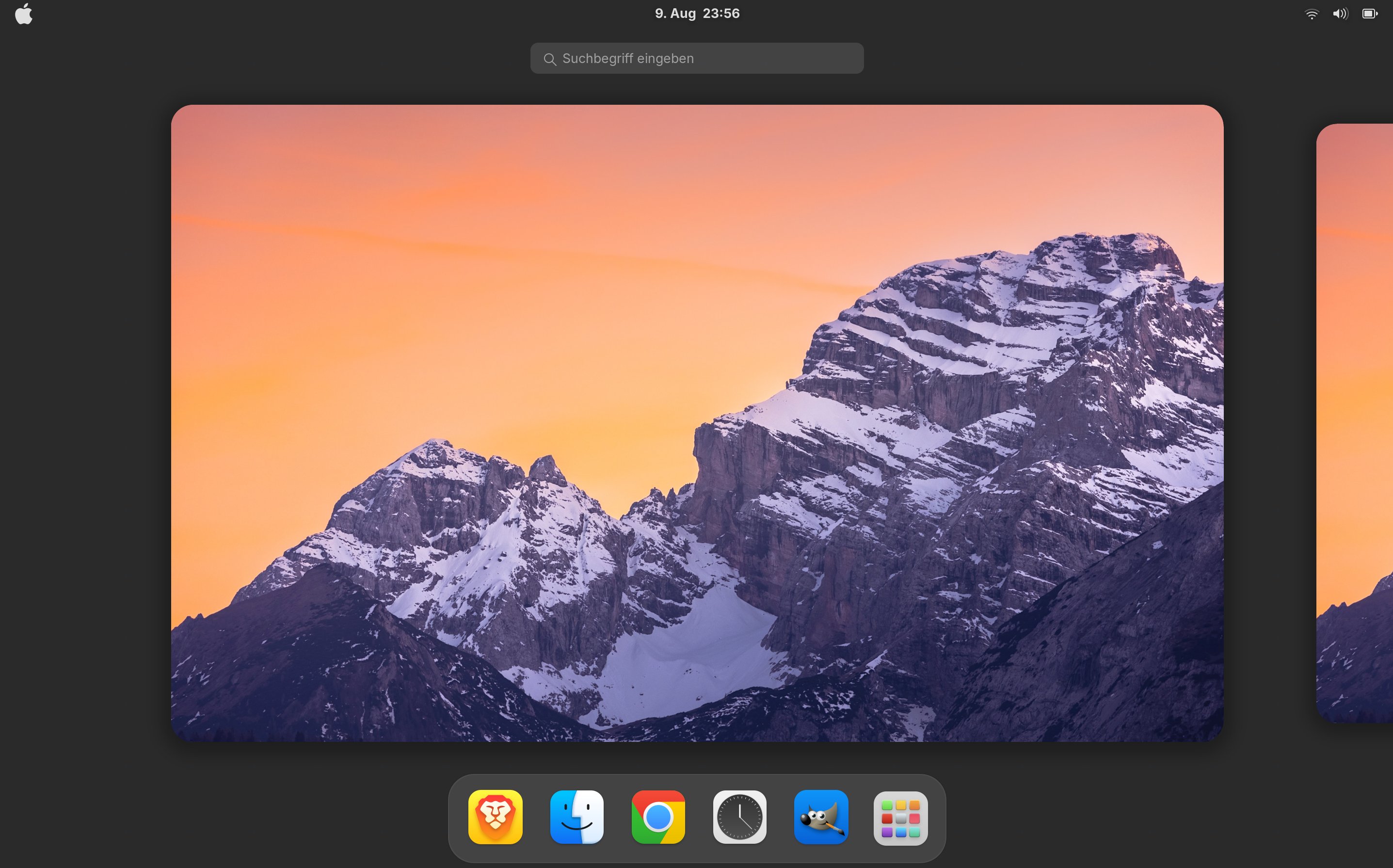

Unfortunately, the start screen now looks like this:

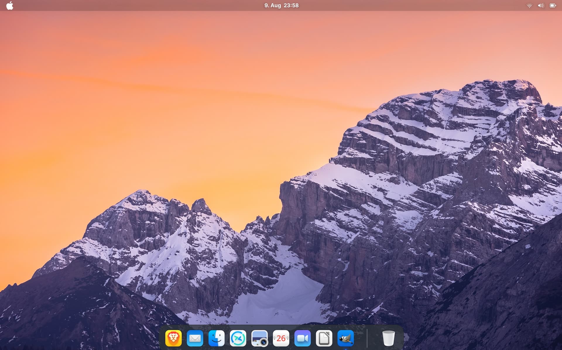

Only after the first click does it change to the desired screen:
Can someone explain to me how I can get the second screen to appear immediately!

Hi, and welcome to Zorin OS!
You'll likely have to install an extension to the desktop environment as this is, unfortunately, something that is hard-coded into it. I found this one that seems to work fine:

If what you mean is that you want to show your own dock made through Plank on the activities overview, I don't think that's possible even with an extension. At least, none that I found. You can still hide the default dock from there if you want using, you guessed it, another extension :smiley: Let me know if you need any pointers on that.
