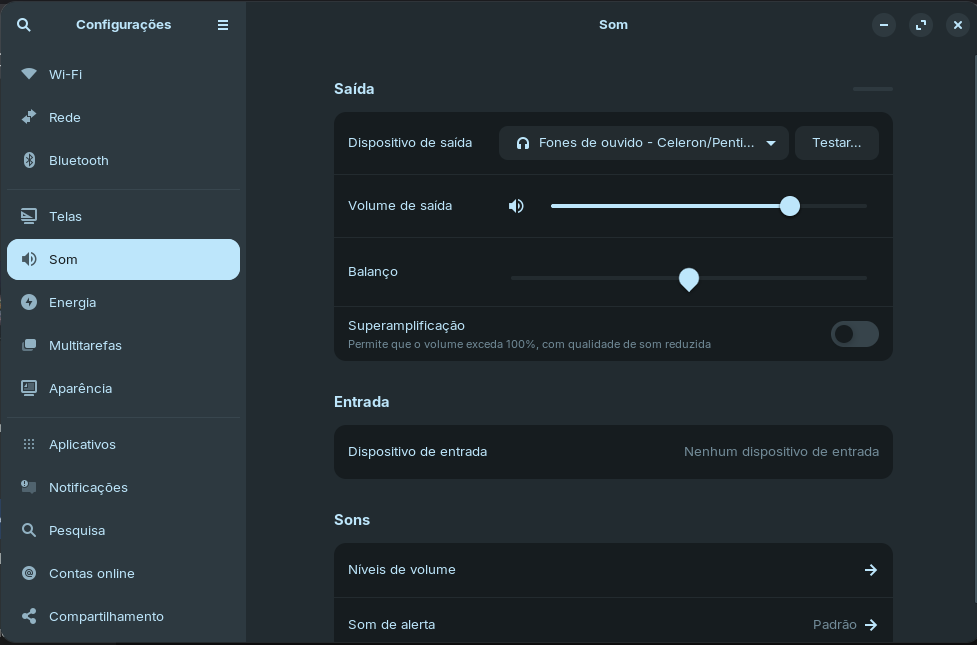

strange that has always appeared that it is connected to the headset, but it is not, not even in the headset does it catch
