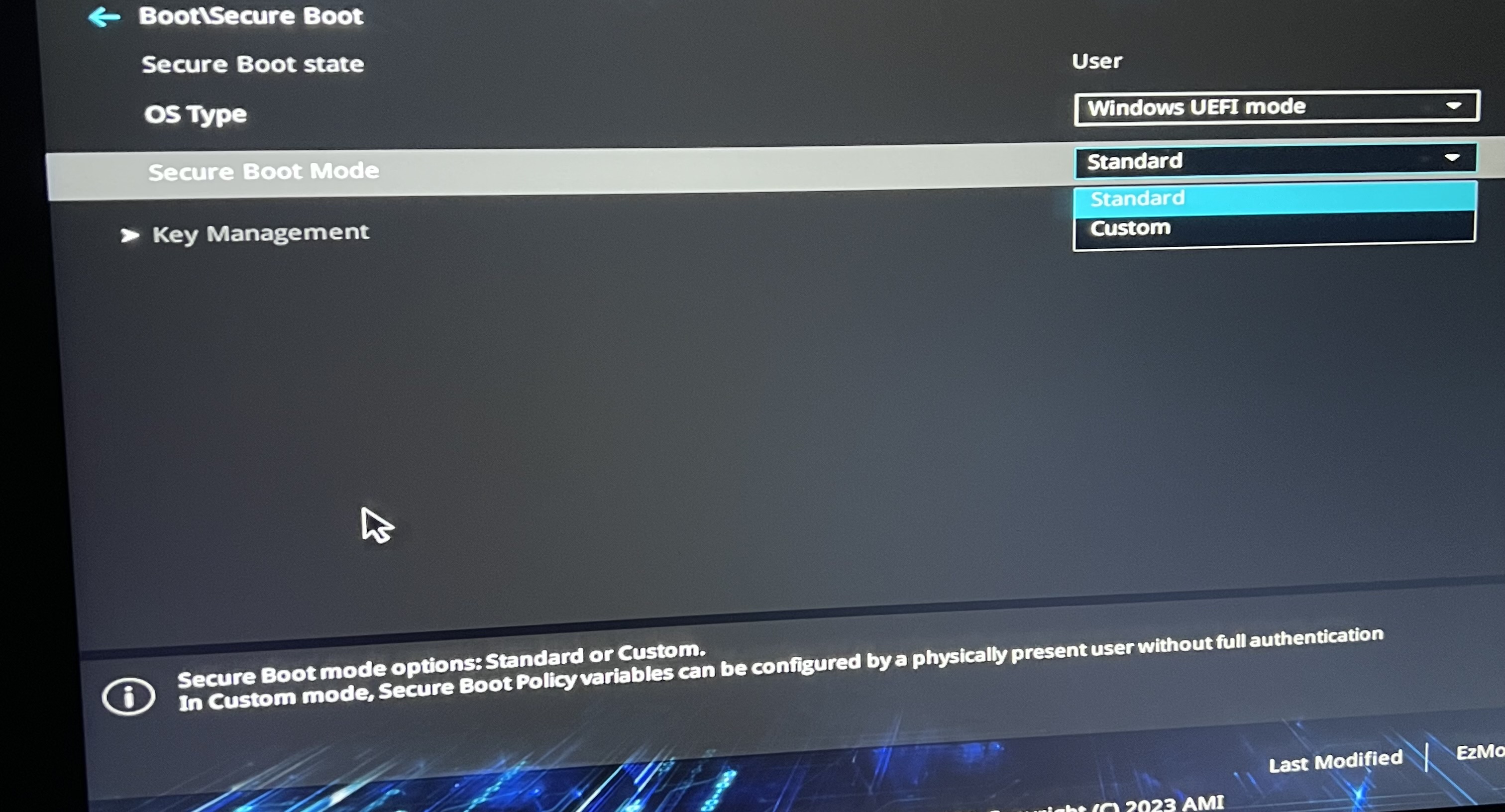

Nevermind, I don't see secure boot at all... but only thing that I see is secure boot mode and there's only 2 options: enabled, and custom.
Please take a look at the manufacturers site how to disable secure boot or tell us the brand/model of your computer or motherboard.
Perhaps there is another option to enable or disable secure boot, at another place than at secure boot mode.
You can also take a screenshot of the BIOS secure boot settings and post it here.
You could try custom and see if You get with this additional Options. But it depends of the Manufacturer.

What does custom offer?

Try to set at "OS Type" > Other OS and look if then secure boot is automatically disabled.
Same thing
And at "secure boot state"? What is shown there when you select other OS?

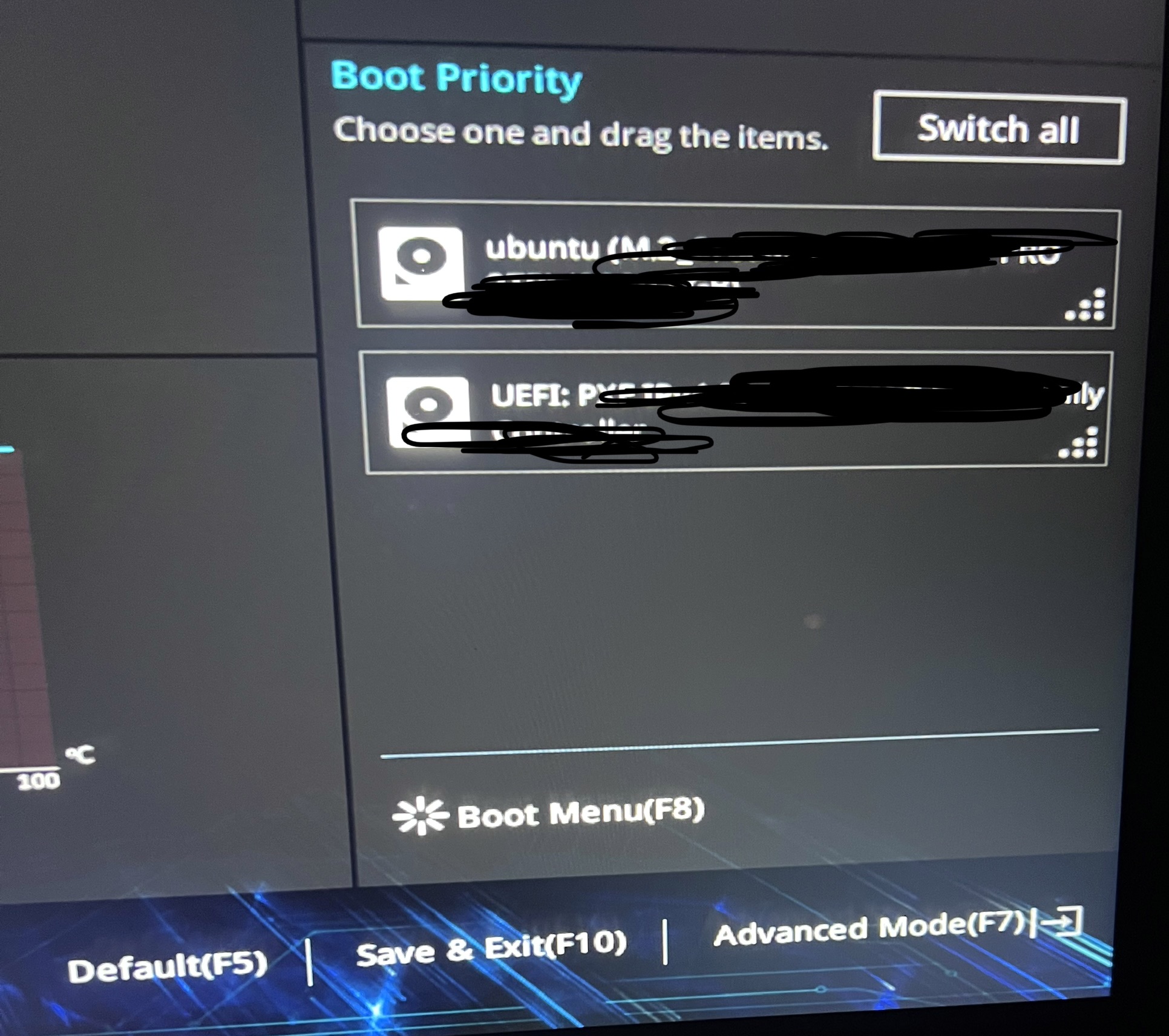

User that what it say
On the previous page in your BIOS, can you show the settings there, please (go back with
button)?
