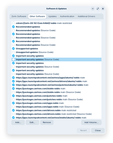

After the update issue yesterday giving me a kernel panic I am wanting only security updates. I my software repository ( in the updater) I have all these checked.
What do I need and what can i uncheck.

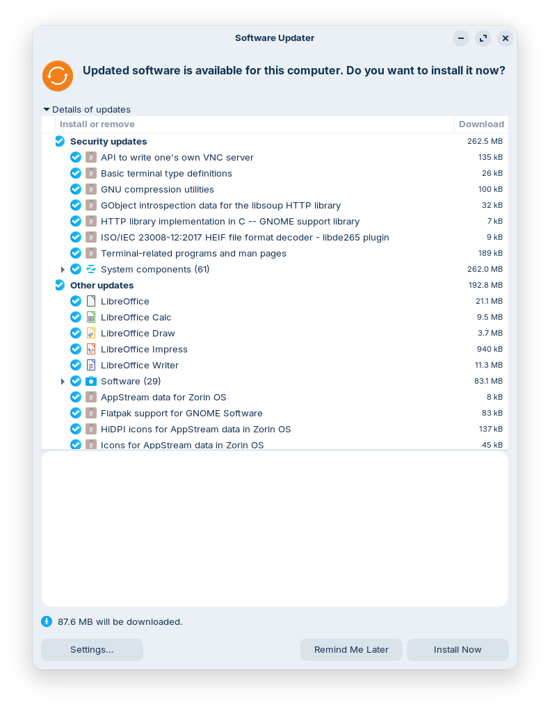

And in this list of recommended updates, if I try to expand or uncheck items it freezes and says force stop or wait. Does not seem normal
If I try to expand the system components where I see things for Ubuntu 7 (which caused all the problems) and try to uncheck them it freezes and I cannot

The Stuff with (Source Code), You can let unticked. And the first Option with cdrom have to be unticked. Otherwise this would lead to Issues.

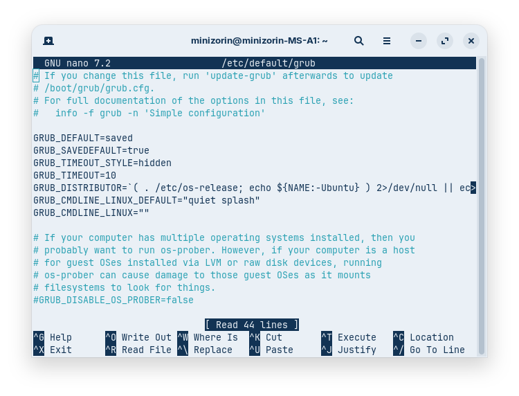

I used sudo nano /etc/default/grub in terminal and it showed that I already have somehow (this is from my terminal)
Am I good to go? I did not have to change from default GRUB=0 to saved
I am afraid to run any updates until 6.17 is locked down
thanks
dan
Do You have installed the -40 Update for the 6.17 Kernel and run now in it? You can check that with the Command uname -r and when it should show the Kernel, type sudo update-grub and then it should be fine.
You can test it. Reboot and see when logged in with the uname -r Command if it is still the Kernel.

Above in this thread I posted from what I believe you are calling software updater and I don't see where to untick kernel updates

When a Kernel Update is offered, You can untick the Packages. It is not a common Setting.
Unfortunately, I don't have a good Example a Screenshot saved, where I could show You. But when You use the Software Updater, You get a List with Packages that can be updated. And at the Beginning, You have Markers. And You can unmark them. It looks similar to this:

I did find in the software updater under Security Udates/System Components, 8 items that referenced Kernel 7. I unchecked all of them and ran the updates and no Kernel 7.
