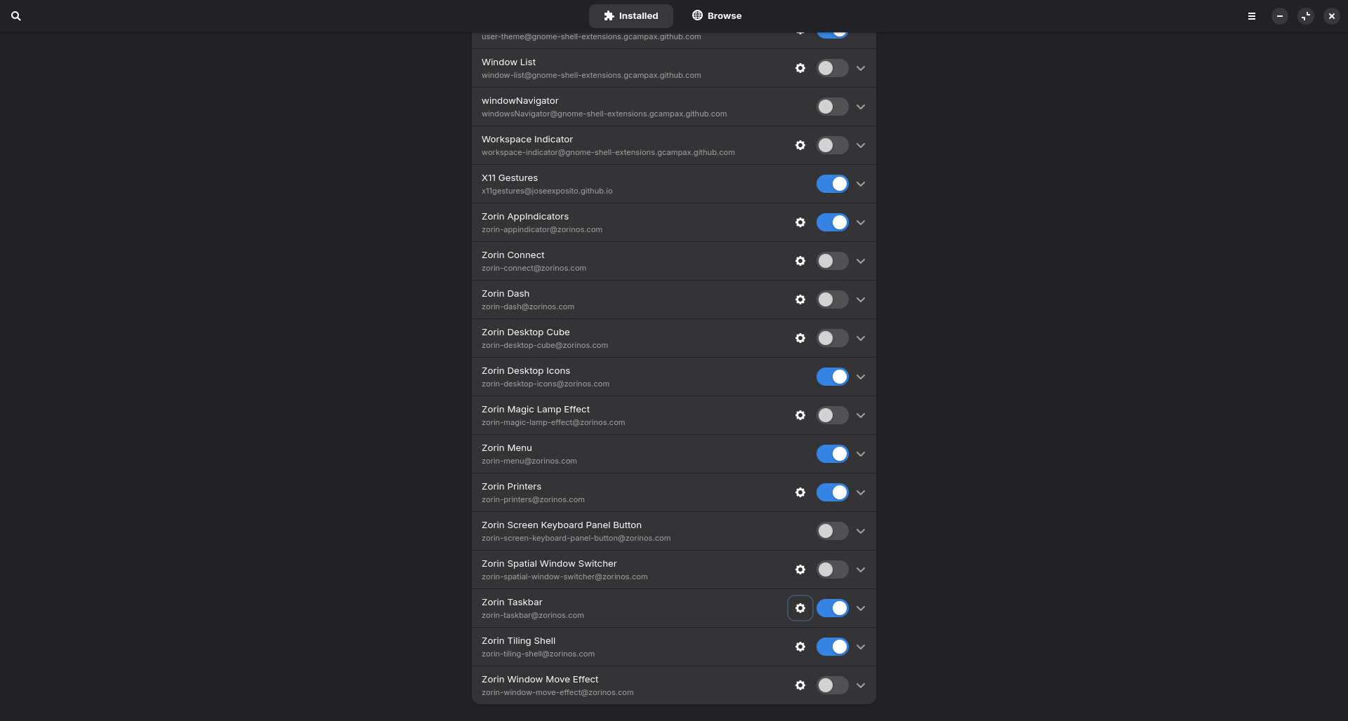

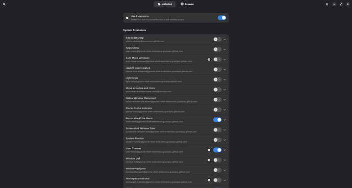

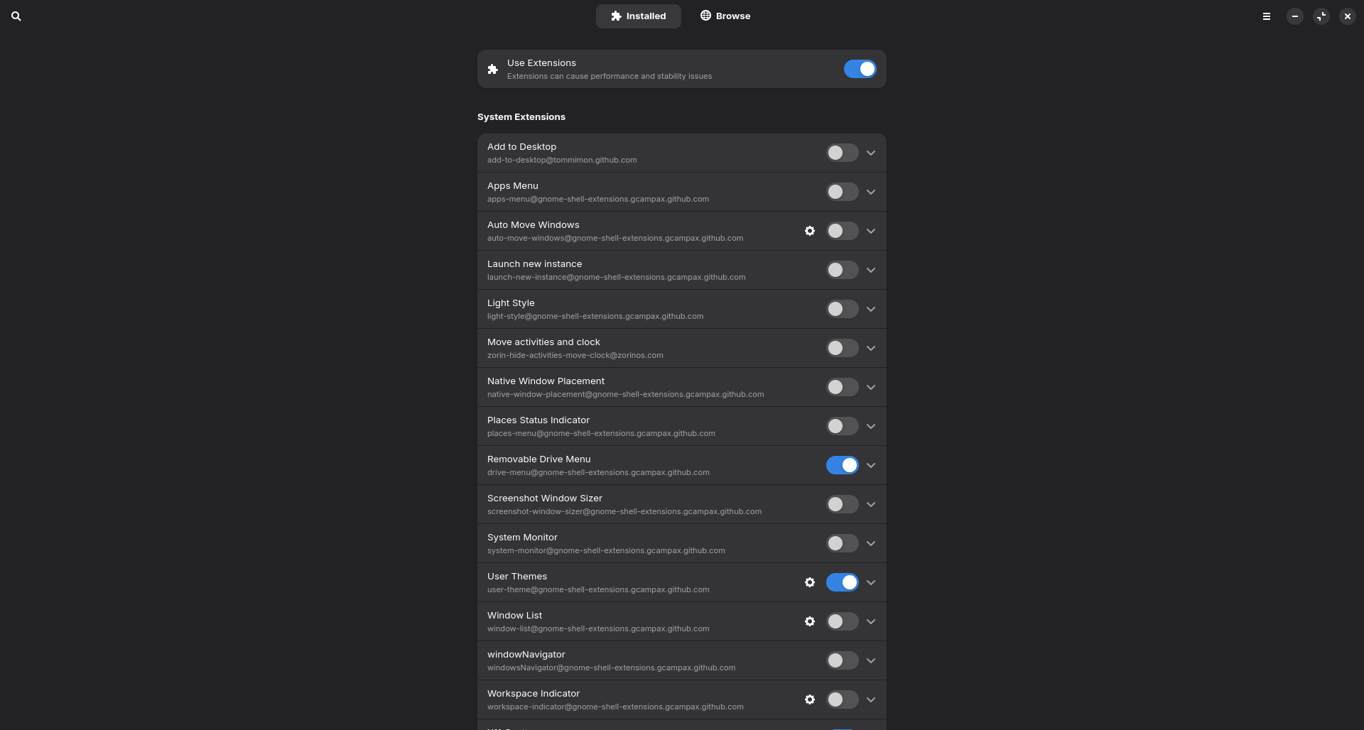

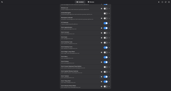

Ok here are the extensions that are installed
When I disable the Zorin taskbar the icon is still there.
That looks so far fine. Is this a fresh Install? If yes: Do You have installed any Software?
