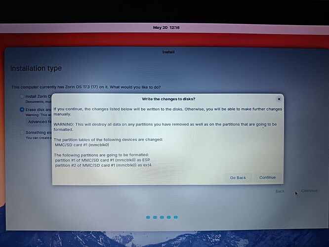

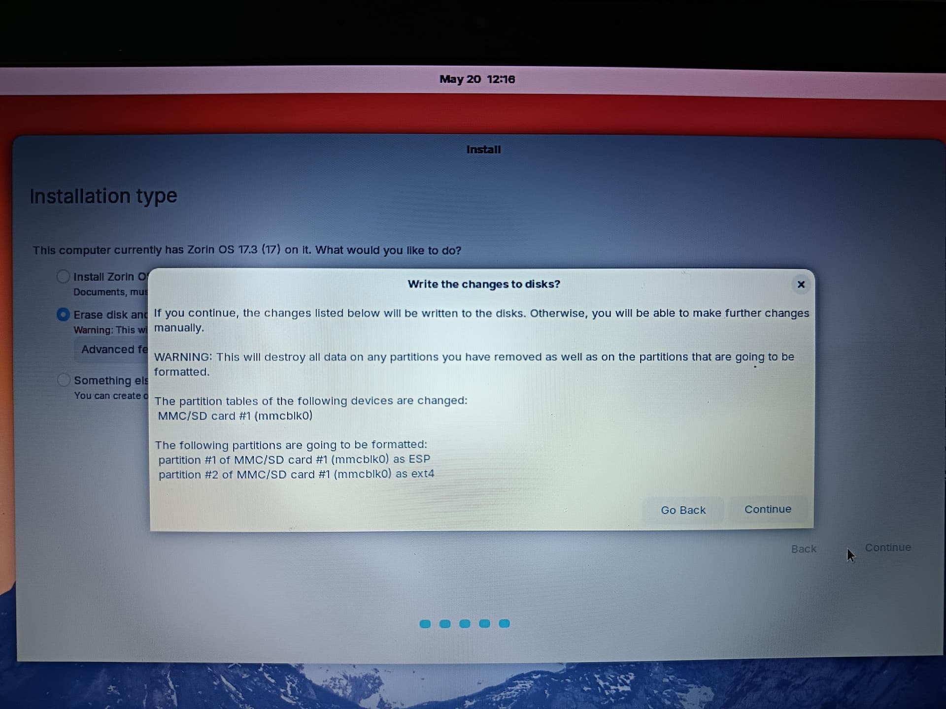

Checking the boot options after install "ubuntu" shows at the top of the boot list, but moving it around with various combinations of legacy or uefi, etc still seems to have the laptop boot loop.
Can anyone figure out what I'm missing/doing wrong here?

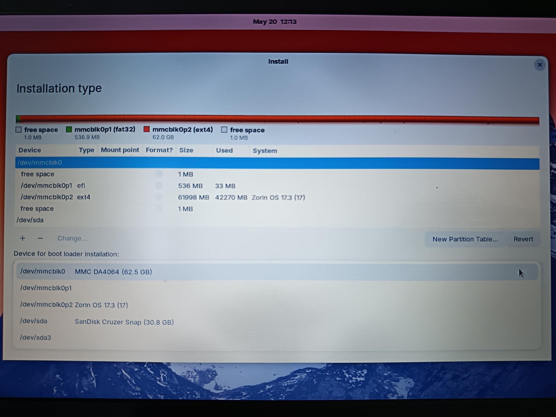

The mount points are missing. Set your Fat32 efi partition as boot and ext4 partition as root.
Set the boot mode to UEFI instead of legacy support.

Can you run Gparted from your installation USB in "Try Zorin" mode and post a screenshot of the partitions created on that emmc drive.
You can see it on the imgur pictures. Only change http s.. to https...
I've got Gparted up but I'm not sure how to make ext4 as "root" don't seem to have that option anywhere, unless you mean as the first boot option?
Fat32 was already set to Boot under flags.
Managed to make a 1mb unallocated partition that I can't seem to delete though lol

Hi mate, how do I do this? (sorry, replied with a gparted screenshot further up the chain but couldn't find out how to set this partition up as "root")
Right click on the ext4 partition and set "mount as / (root)" in gparted (when Zorin is already completely installed).
In your Zorin installer you can set it here:

Mount is greyed out in Gparted. I tried to follow this in the installer, and thought it was done but looking at it in Gparted now, there's no "root" flag attached or anything different to how it was before.

When you right-click on the ext4 partition in gparted, can you go to "manage flags" and choose "root" there?

It may be an idea to install again, but use the "Something Else" method. That gives you manual control of creating the partitions and selecting device for boot loader installation
EDIT:
I thought that was how redline had done their installation so far. i.e. not "Something Else" method.
