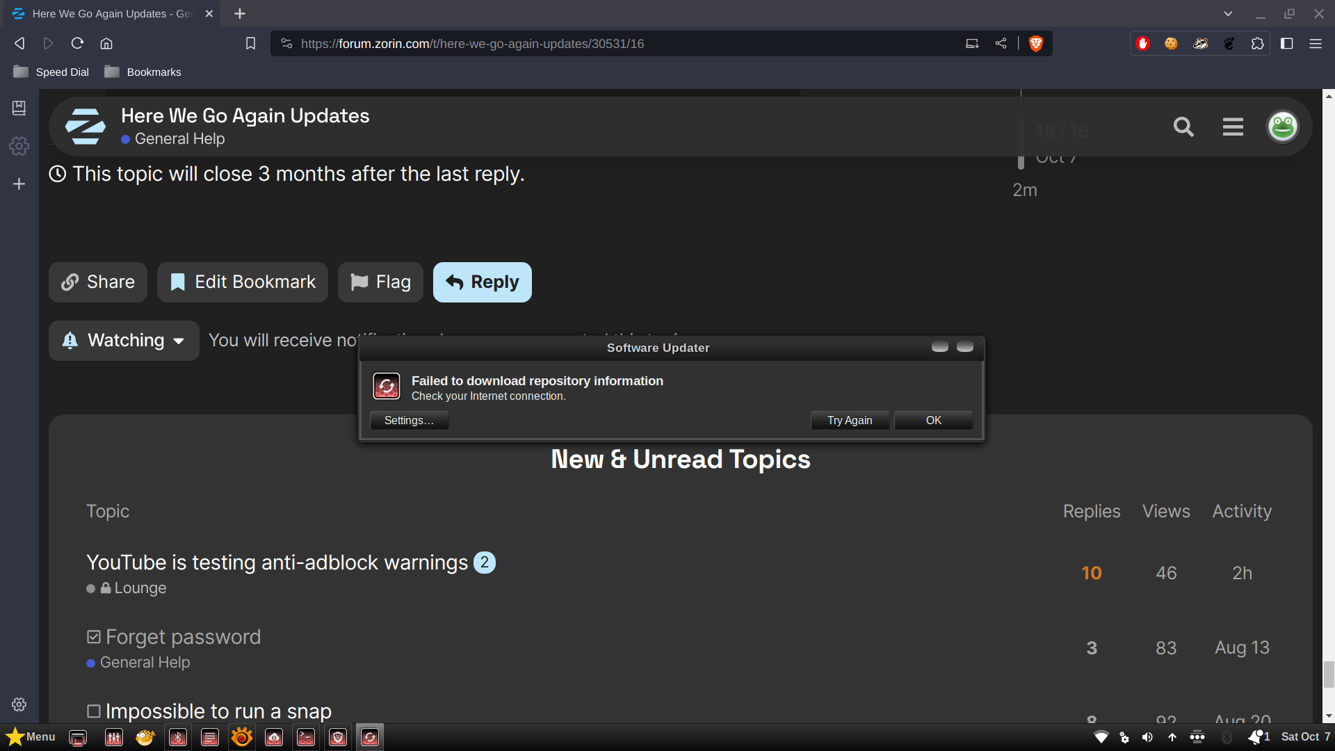

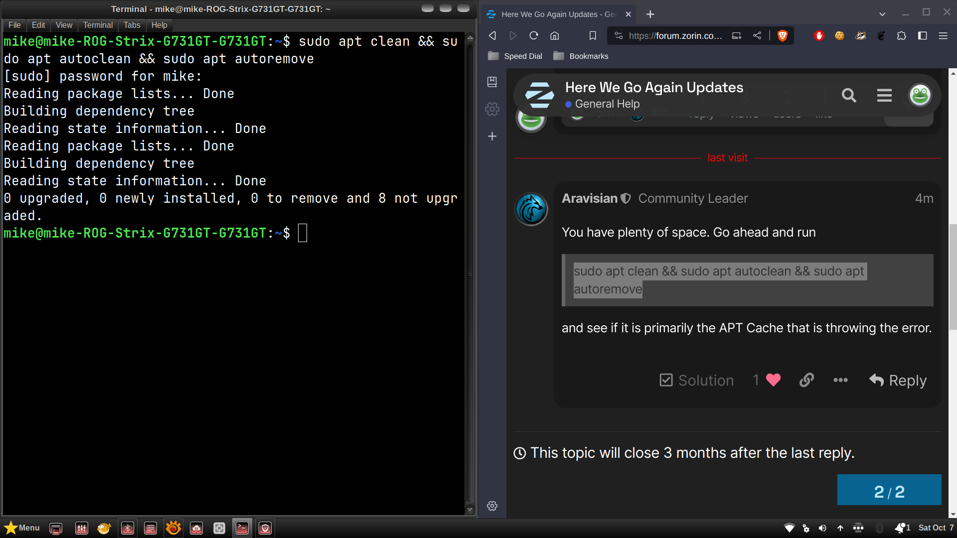

Once again Updates is telling me I don't have enough disk space to download the newest update for Zorin ..... I again used Ubuntu Cleaner and it said "cool you system is clean" ..... here is a photo of my Zorin Drive .... there appears to be enough space ..... besides I've been using this configuration for the past 2 years with no problem until recently .....
You have plenty of space. Go ahead and run
sudo apt clean && sudo apt autoclean && sudo apt autoremove
and see if it is primarily the APT Cache that is throwing the error.
Ok thanks ..... now to try the update again ..... terminal response .....
Looks good... now what does
sudo apt upgrade
give you?

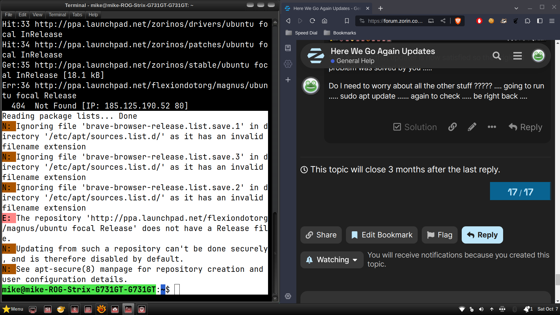

Err:36 Index of /flexiondotorg/magnus/ubuntu focal Release
404 Not Found [IP: 185.125.190.52 80]
Reading package lists... Done
N: Skipping acquire of configured file 'main/binary-i386/Packages' as repository 'https://brave-browser-apt-release.s3.brave.com stable InRelease' doesn't support architecture 'i386'
E: The repository 'Index of /flexiondotorg/magnus/ubuntu focal Release' does not have a Release file.
N: Updating from such a repository can't be done securely, and is therefore disabled by default.
N: See apt-secure(8) manpage for repository creation and user configuration details.

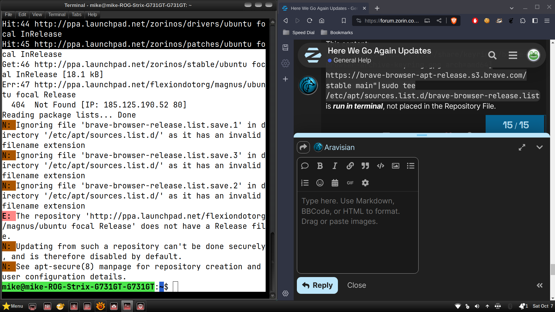

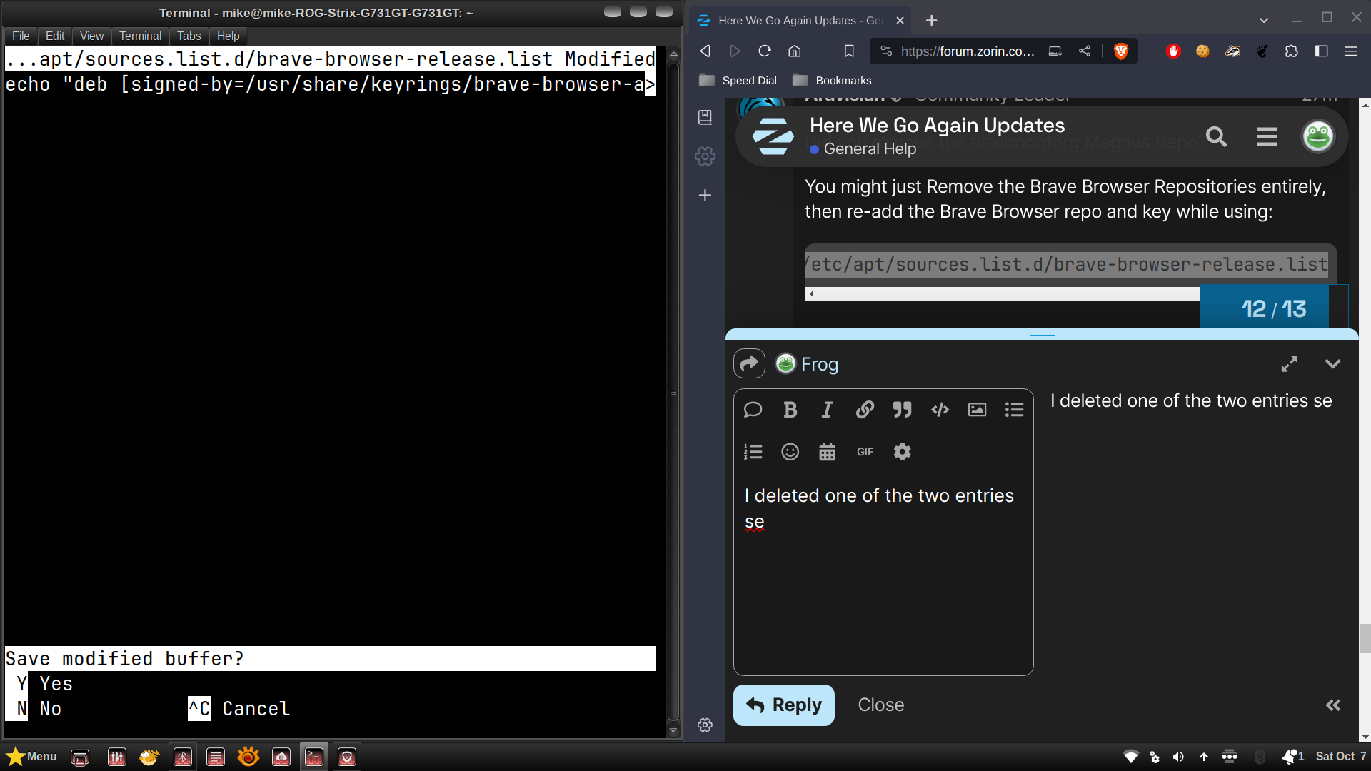

You can remove Martin Wimpress's repository for "Magnus" since it does not have a Focal Release file using Software & Updates > Other Software
sudo nano /etc/apt/sources.list.d/brave-browser-release.list
Change the content to be arch=amd64 exactly as:
deb [signed-by=/usr/share/keyrings/brave-browser-archive-keyring.gpg arch=amd64] https://brave-browser-apt-release.s3.brave.com/ stable main
Tap ctrl+o to overwrite, then enter key to save configuration. Tap ctrl+x to exit the editor.
N: Ignoring file 'brave-browser-release.list.save.1' in directory '/etc/apt/sources.list.d/' as it has an invalid filename extension
W: Target Packages (main/binary-amd64/Packages) is configured multiple times in /etc/apt/sources.list.d/brave-browser-release.list:1 and /etc/apt/sources.list.d/brave-browser-release.list:2
W: Target Packages (main/binary-all/Packages) is configured multiple times in /etc/apt/sources.list.d/brave-browser-release.list:1 and /etc/apt/sources.list.d/brave-browser-release.list:2
W: Target Translations (main/i18n/Translation-en_PH) is configured multiple times in /etc/apt/sources.list.d/brave-browser-release.list:1 and /etc/apt/sources.list.d/brave-browser-release.list:2
W: Target Translations (main/i18n/Translation-en) is configured multiple times in /etc/apt/sources.list.d/brave-browser-release.list:1 and /etc/apt/sources.list.d/brave-browser-release.list:2
W: Target DEP-11 (main/dep11/Components-amd64.yml) is configured multiple times in /etc/apt/sources.list.d/brave-browser-release.list:1 and /etc/apt/sources.list.d/brave-browser-release.list:2
W: Target DEP-11 (main/dep11/Components-all.yml) is configured multiple times in /etc/apt/sources.list.d/brave-browser-release.list:1 and /etc/apt/sources.list.d/brave-browser-release.list:2
W: Target DEP-11-icons-small (main/dep11/icons-48x48.tar) is configured multiple times in /etc/apt/sources.list.d/brave-browser-release.list:1 and /etc/apt/sources.list.d/brave-browser-release.list:2
W: Target DEP-11-icons (main/dep11/icons-64x64.tar) is configured multiple times in /etc/apt/sources.list.d/brave-browser-release.list:1 and /etc/apt/sources.list.d/brave-browser-release.list:2
W: Target DEP-11-icons-hidpi (main/dep11/icons-64x64@2.tar) is configured multiple times in /etc/apt/sources.list.d/brave-browser-release.list:1 and /etc/apt/sources.list.d/brave-browser-release.list:2
W: Target CNF (main/cnf/Commands-amd64) is configured multiple times in /etc/apt/sources.list.d/brave-browser-release.list:1 and /etc/apt/sources.list.d/brave-browser-release.list:2
W: Target CNF (main/cnf/Commands-all) is configured multiple times in /etc/apt/sources.list.d/brave-browser-release.list:1 and /etc/apt/sources.list.d/brave-browser-release.list:2

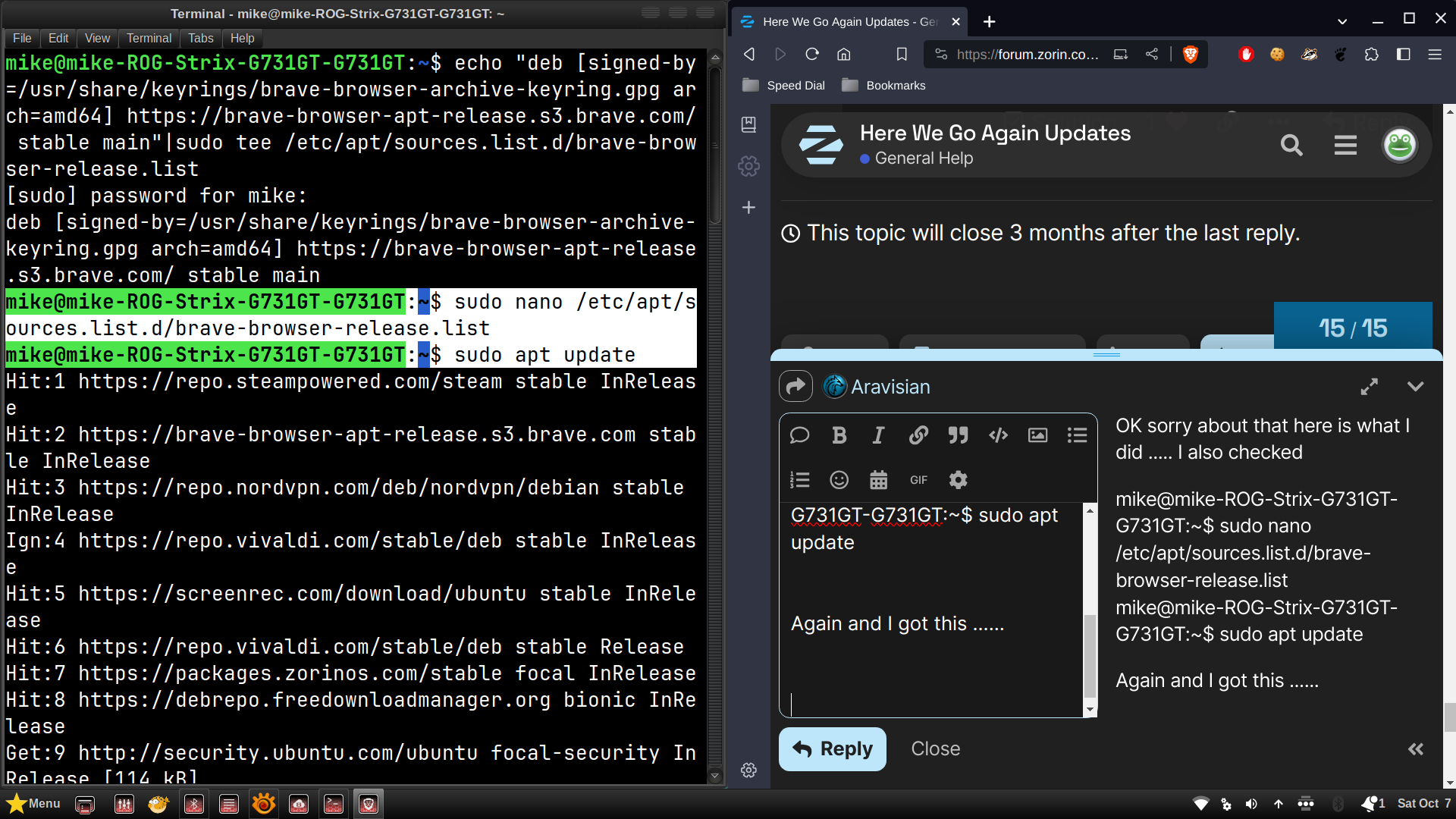

Did you remove the flexiondotorg Magnus Repo?

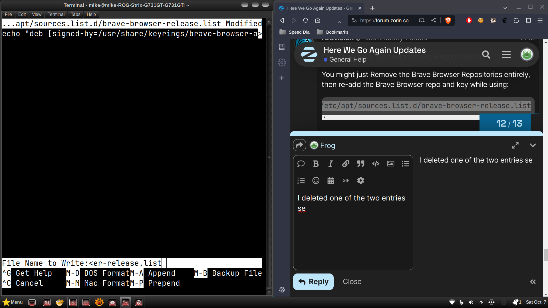

You might just Remove the Brave Browser Repositories entirely, then re-add the Brave Browser repo and key while using:
echo "deb [signed-by=/usr/share/keyrings/brave-browser-archive-keyring.gpg arch=amd64] https://brave-browser-apt-release.s3.brave.com/ stable main"|sudo tee /etc/apt/sources.list.d/brave-browser-release.list
Do I delete the original text in the command to change the text in the Brave ..... sudo nano /etc/apt/sources.list.d/brave-browser-release.list ..... cause that is what I did then copied and pasted your context ..... I guess I shouldn't have done that ..... just copied the context UNDER the original one and then
My mistake how do I correct .....
I deleted one of the two entries see photo ..... now it asked to save buffer I said yes ..... now it shows this and won't let me exit .....
I had to leave and run an errand. I am not sure where you are at this point.
Did you remove the Brave Browser repos or are you modifying the existing?
This content:
is run in terminal, not placed in the Repository File.
OK sorry about that here is what I did ..... I also checked
mike@mike-ROG-Strix-G731GT-G731GT:~$ sudo nano /etc/apt/sources.list.d/brave-browser-release.list
mike@mike-ROG-Strix-G731GT-G731GT:~$ sudo apt update
Again and I got this ......
Just to let you know I tried the updater again and got this ......
Nothing is wrong with my internet ......

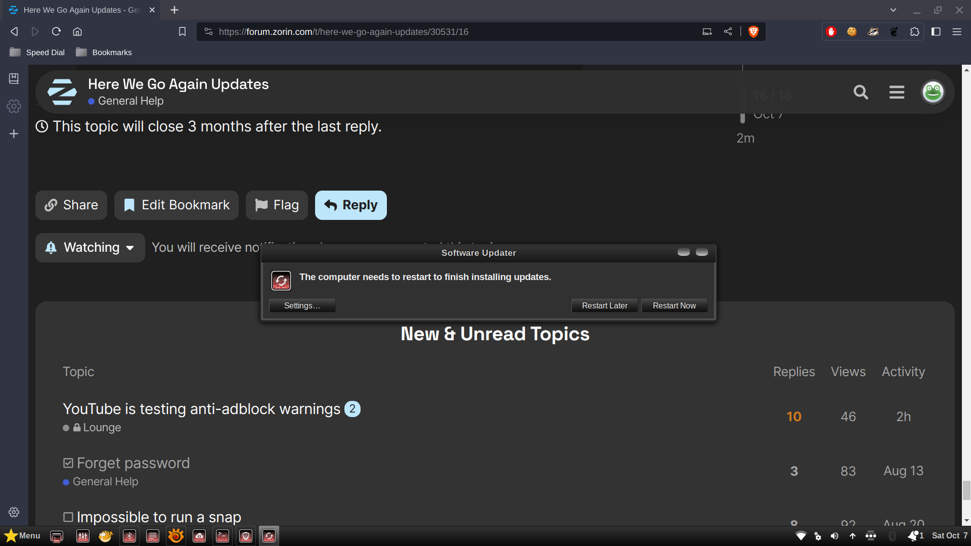

Then this when I clicked OK and restarted my machine
After restart this message ......

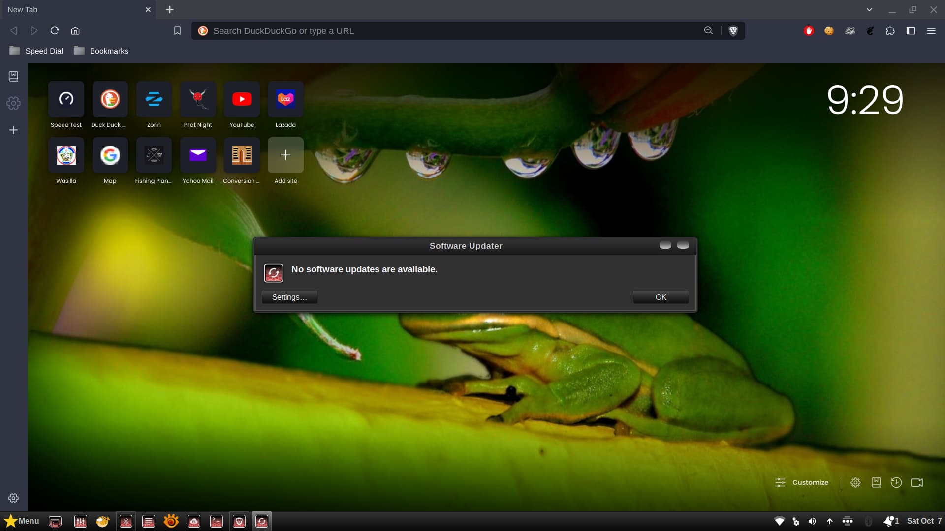

I tried updater again and this message ....
So it appears that updater is now satisfied so the origional problem was solved by you .....
Do I need to worry about all the other stuff ????? .... going to run ..... sudo apt update ...... again to check ..... be right back ....
Nope same thing in terminal just ignore it ??????
This is why I suggested just removing the Brave Browser Repository files and replacing them fresh.
I am not really sue why you have a "file".1 and "file.2"...
Maybe because I just added a copy of that file underneath the original one .... not knowing any better ..... it gets very confusing after that even for me ..... as of right now I only show I copy of the file plus the one I put in the terminal ..... maybe is why it shows two .....
As far as the Magnus goes I removed and purged it so I don't know why that is still there .....
