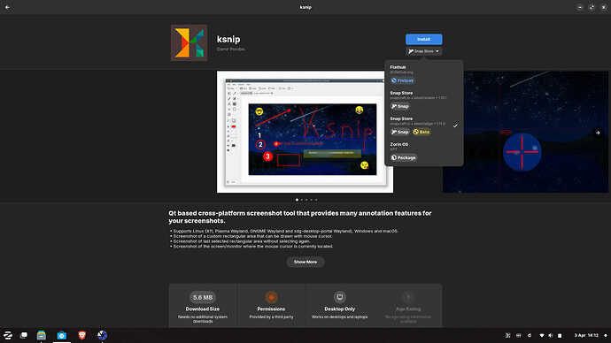

How can I uninstall Ksnip?
The Software Store lets me install Ksnip but I do see an uninstall button. Nor does Ksnip appear in my list of Installed apps.
Check if you installed it as a snap package in the software center.
Ksnip does not appear as an Installed package. So I do not know where I would check. My recollection is that it was listed as a snap package before I installed it but I would not swear to it in court.
The screenshot shows that you are checking the flatpak, you need to switch it over to snap to see the uninstall button.
I have tried both Snap options and neither give me an Uninstall button - just an Install button.

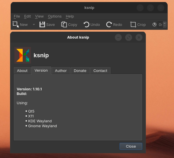

I also obtained the version info about ksnip:
That helped: it shows the version as 1.10.1
This does not match Flatpak version and your flatpak list does not show it.
It does not match APT and also APT shows it as not installed.
It does match the Snap version.
I cross referenced and in your post here:
You have a snap package installed: kf5-5-110-qt-5-15-11-core22
This is a KDE Framework package which includes various KDE tools... including ksnip
Removing kf5-5-110-qt-5-15-11-core22 in Snap should remove all of the KDE framework desktop tools.
