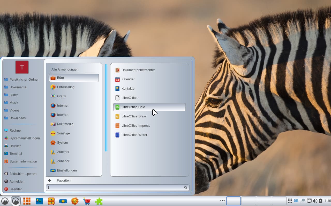

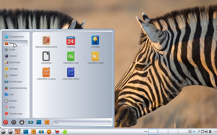

If you like another start menu which is a bit more customizable take a look at StarkMenu or Cinnamenu. You can install them as Applets when you right-click on the panel and select Applets. There you can download Applets.
StarkMenu in Mate menu layout:
Cinnamenu:

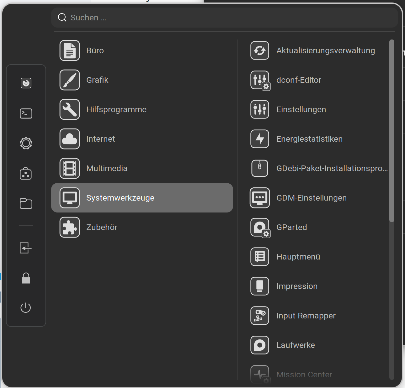

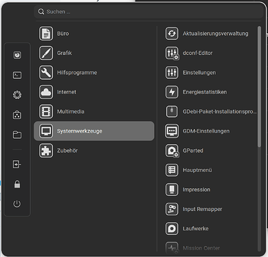

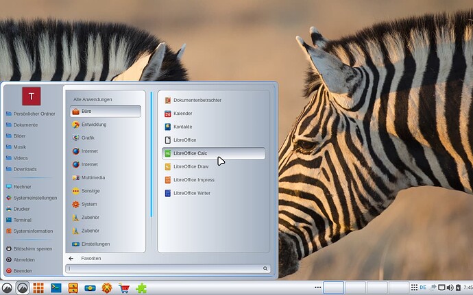

To add that to @Forpli's Suggestion:

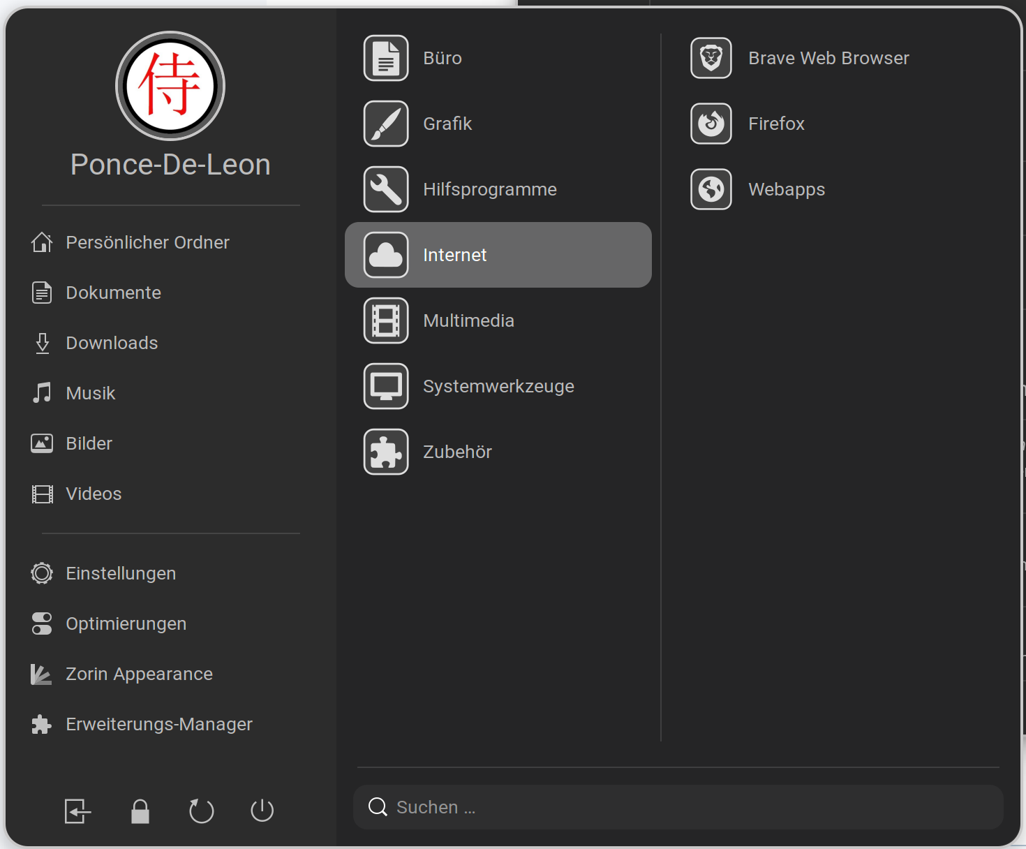

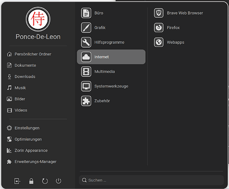

I use ArcMenu and it would look like this:
older Cinnamon Menu:
newer one:
You can adjust of Course the Stuff like Size of the Icons. Entries the overall Size, Searchbar etc.
Yes, that is what I meant.
Thank you for the tip, and suggestion. I will have a look at both of these options!
This looks like another good option. Thank you so much for the suggestion, and illustration. :wink:
