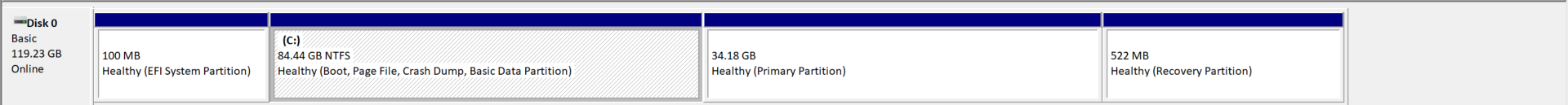

In the Disks
Its the 3rd one with the 34.18GB
Ok so I'm assuming this is a dualboot with Windows then. I would before doing anything backup everything as most what you're going to do should be safe, but there's always the chance that something goes wrong and data loss occurs.

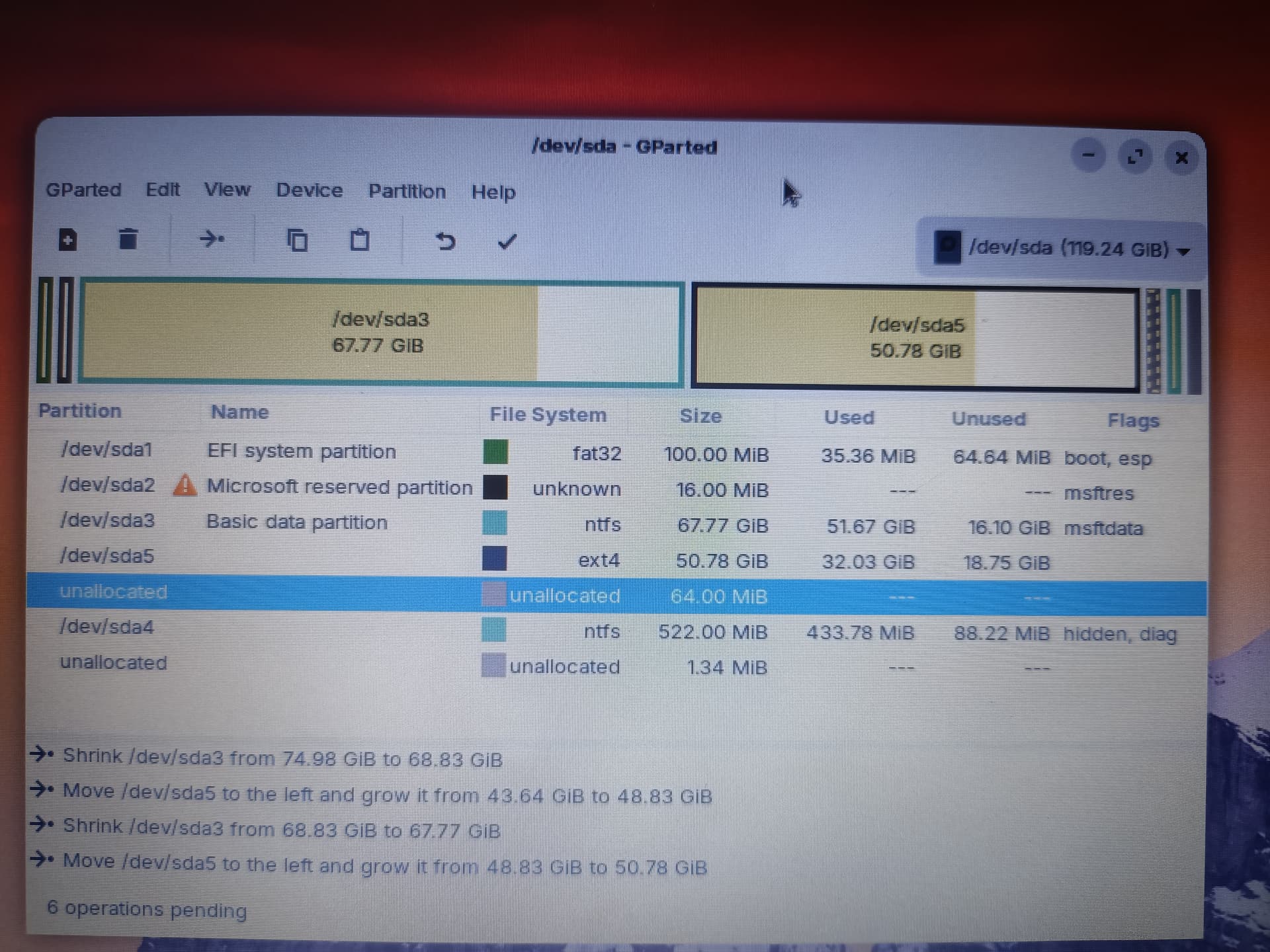

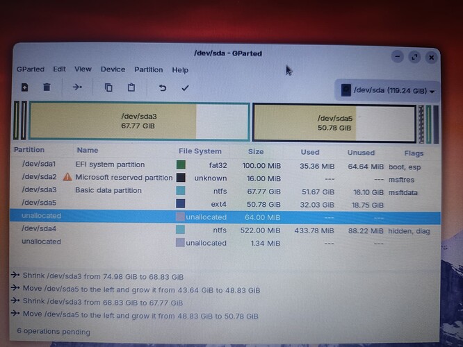

Ive decided maybe to try 50GB for Zorin OS
Am i heading the right way?
It says 6 operations pending
That looks right so far. However, as a precaution, please back up your data before making changes to the partitions.
On the screenshot you can only see 4 things to be changed. What are the other 2 operations? Are they mentioned?
If I were you I would start from the beginning and minimize/enlarge the partitions in two steps not in 4 (You changed the size again later - set it to the desired value straight away).
The other two are unallocated. One is 64MiB
and the other is 1.34MIB
I meant, there was shown "6 operations pending" and four things listed and I asked myself if there are further ones shown somewhere...But I don't know exactly. Eyerything can be alright.

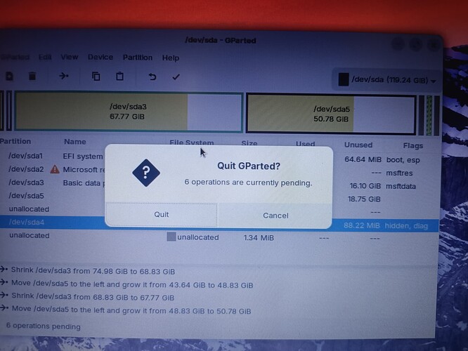

Oh i see... is it safe to quit?
Yes. This will stop it. The operations are only made after confirming them.
Wait i think i made a mistake after quitting Gparted it remained as 35GB. When i booted using the USB i chose to try Zorin OS. Did i made a mistake.
Also the files are doing fine
Using "Try Zorin mode" is right.
I thought you wanted to cancel gparted? Then no changes will be made to the partitions - as long as you have not explicitly confirmed this. This means that your partitions will still be the old ones.
Oh right I haven't APPLIED yet it🤦‍♂️, i just realized that after asking that
So if i would i apply the changes i would go to Edit > Apply All Operations in the Gparted right
I thought the changes would already be applied after quitting GParted
Yes, you have to apply the changes. You can also click on the green hook.:check_mark:
