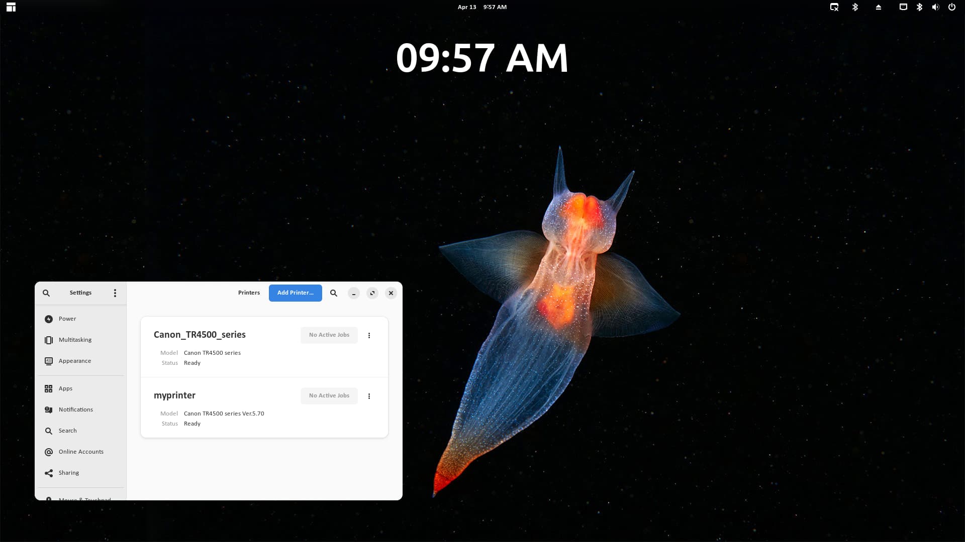

After Zorin installation, Zorin found my printer and assigned it stock drivers for the Canon TR4500 series, which worked pretty well. Months later I visited Canon support to see if there were any official Linux drivers for my printer and I was surprised to see that there were. After installing the Canon drivers, I was surprised to see that I now had two printers. I renamed the "new" printer "myprinter" and gave it a static IP and made it the default because my WIFI DNS changes the printer IP after a power outage. I rebooted and thought nothing more about it until I needed to print something. I would hit Print... Nothing. Print... Nothing. I looked at the printer settings and found that the jobs were going to the old "printer." Ok, this should be easy enough. I chose "Remove Printer" and then tried to print my doc and it worked! Until I closed Settings and reopened it. Ghost printer was back. I just can't kill the beast. Any ideas? Thanks in Advance!

Thank you, but I have tried that countless times. When I do a "lpstat -p" the ghost printer is not listed. So, where does it come from? Gotta be a Zorin thing. Printer cache?

No it's a cups auto-discovery issue.
If you read the Unofficial Manual that I authored you will see that first you need to disable auto discovery and then stop it completely. This happens on all current GNU/Linux distributions, not just Zorin.
So before installing a printer, open a terminal (just type the word terminal in the menu search bar and press enter).
Then:
sudo systemctl stop cups-browsed
then
sudo systemctl disable cups-browsed
Then install:
sudo apt install system-config-printer
Once installed:
sudo system-config-printer
This is the best method to start the interface to add a printer. Zorin no longer ships with it. I have used this method since I learned about it from PearOS days many years ago.

Thank you for your reply. I should have thought to remove the current printer first before adding a "new" one. My tech skills have gotten dusty with age. Your solution worked for me.
Removing the printer does not stop it from re-appearing ... unless you used those commands beforehand. :wink:
