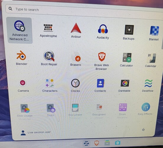

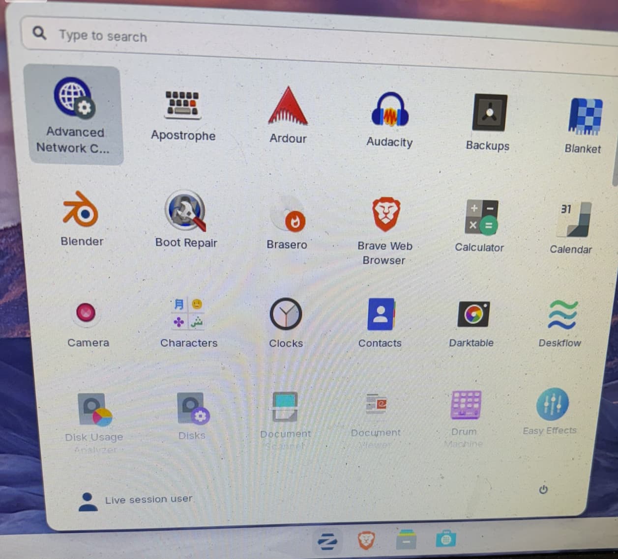

Can the apps be rearranged and/or placed in groups in the app list as shown below?

Edit: I made a mistake. That is not app grid but a layout style of Zorin menu. There you can't change the icons.
in extension manager install arc menu then click the gear and then at top the menu button then menu layout then the win 11 one that looks alot like yours and you should be able to move apps
