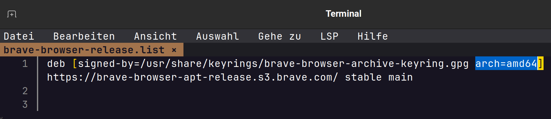

N: Skipping acquire of configured file 'main/binary-i386/Packages' as repository 'https://brave-browser-apt-release.s3.brave.com stable InRelease' doesn't support architecture 'i386'
That means that 32bit Architecture isn't supported. Not a wild Issue - and something that in the Instructions from Brave should have changed. But You can make that manually.
Type in Terminal:
sudo nano /etc/apt/sources.list.d/brave-browser-release.list
And there You add arch=amd64 in the square Brackets at the End like seen here:
When done, press ctrl+o to save, Enter to confirm and ctrl+x to exit. Back in the normal Terminal Overview type sudo apt update && sudo apt upgrade and the Message should be gone.
