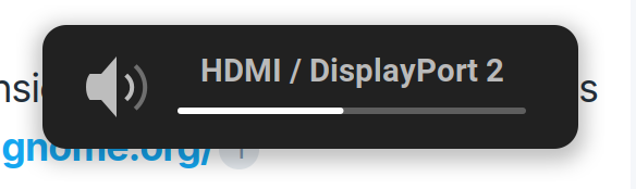

When You change the Volume, You don't get something like this on the bottom centered?
for Bluetooth if you change volume from headset for example the OSD doesn't appear

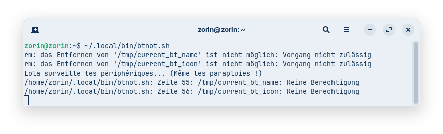

When I try to run the btnot script from terminal I get the following errors:
rm: The removal of /tmp...is not possible. Process not permitted.
/home/zorin.....no permissions
certainly because of live session because users have right on /tmp/
in the script try to change
BT_NAME_FILE="/tmp/current_bt_name"
BT_ICON_FILE="/tmp/current_bt_icon"
for
BT_NAME_FILE="~/.local/current_bt_name"
BT_ICON_FILE="~/.loca/current_bt_icon"
I tried to change the permissions of the two files to give others write rights, but didn't change anything. I've had enough for today. Next day...next try.
