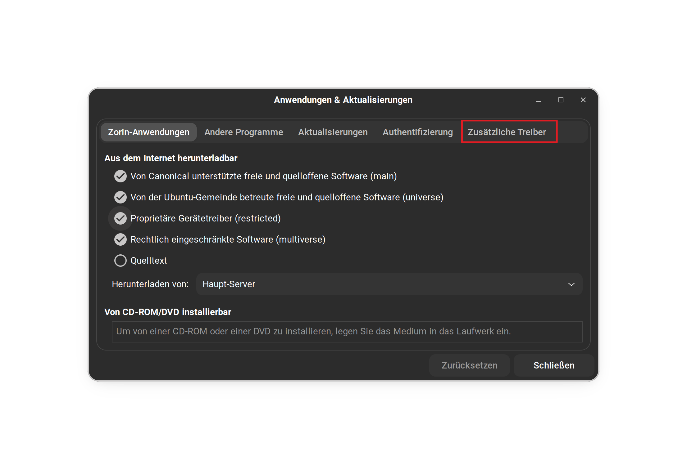

Did You take a Look at the ''Additional Drivers'' Tab in Software & Updates if there is a Driver offered? And have You the Wifi Setting in Settings>Wifi or doesn't exist it?

Open Software & Updates:
And one the right is the Tab.
Can You enable them by clicking on the Toggle?

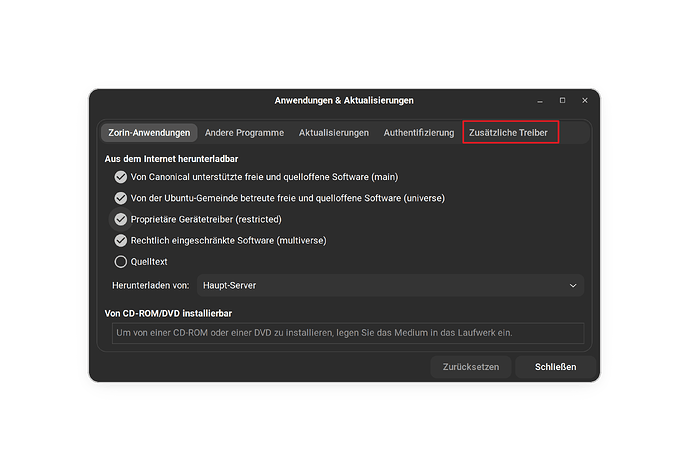

The name of the app Software&Updates depends on your language. You find it in Zorin start menu or the app overview. What language do you use? In German it is called "Anwendungen & Aktualisierungen".
You can also open the software store and click on the Hamburger menu and then select Software&Updates.

In German it is ''Anwendungen & Aktualisierungen'' like You see on the Screenshot above.

Okay, found the Dialog this way. Result:
"Keine zusätzlichen Treiber verfügbar."
(No additional drivers available)
