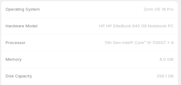

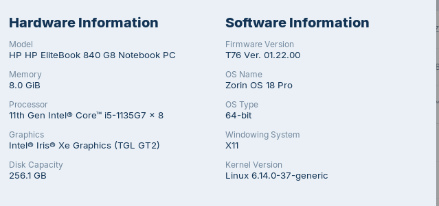

Could You post Your Hardware Specs please?
