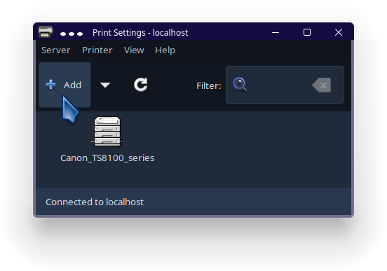

sudo system-config-printer
now you should get the familiar printer interface:
Click on the '+ Add' icon.

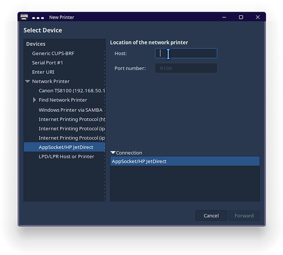

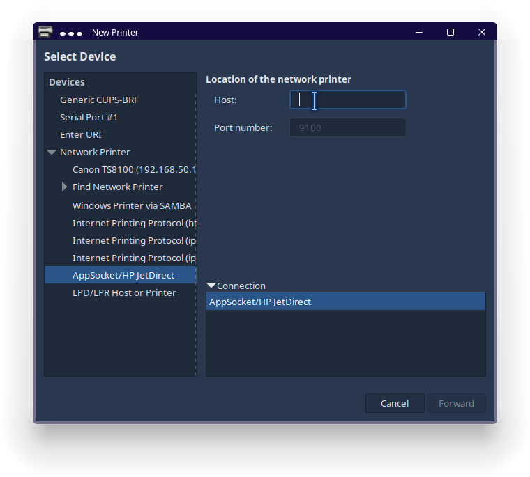

On the next window, wait for the 'Network Printer' section to populate, then use the AppSocket/HPJetDirect option:
If you know the IP address of the printer, enter the IP address in the Host: box.
Then click on forward, choose HP manufacturer and look for the printer driver, hopefully it will be shown.
