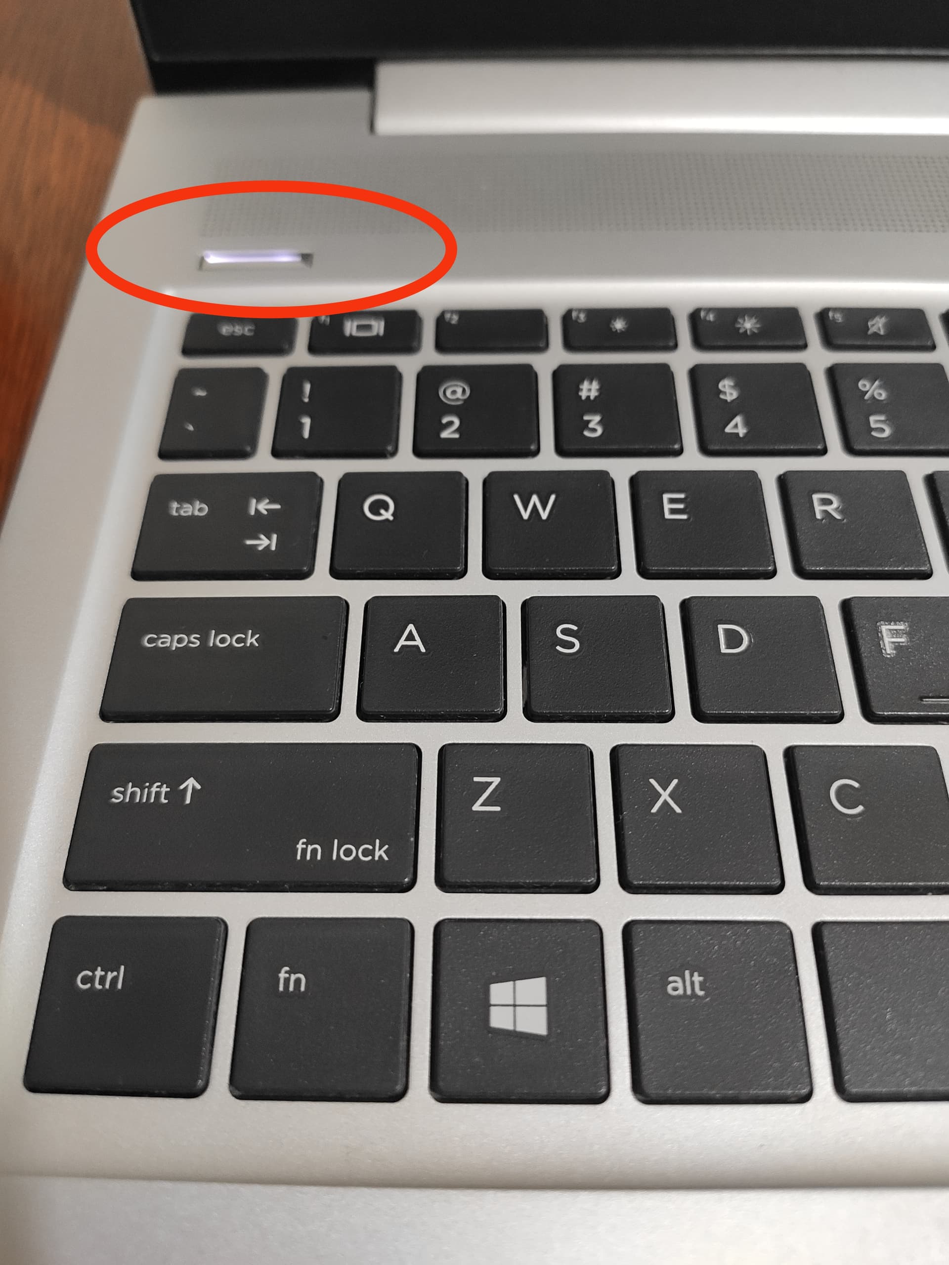

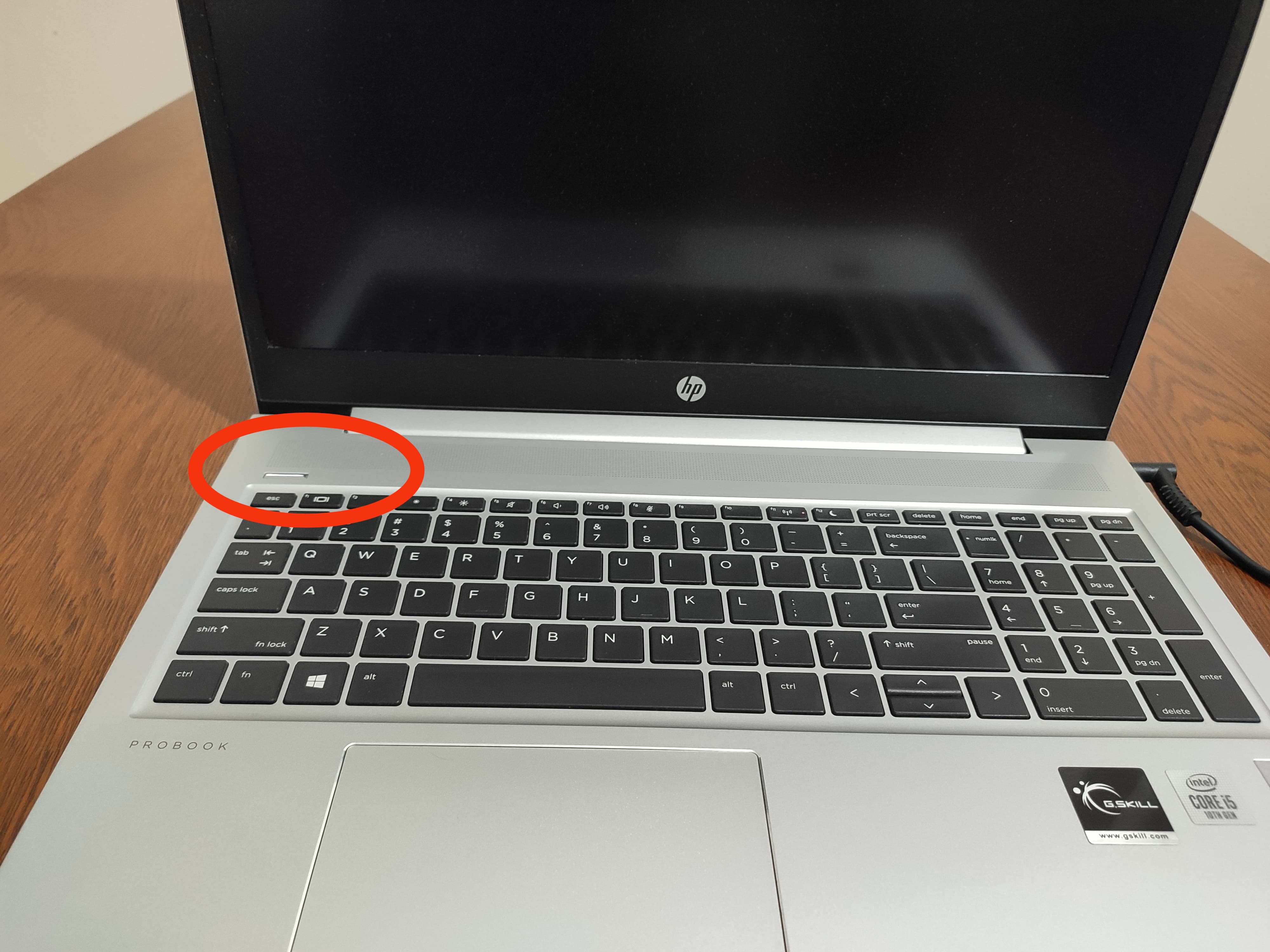

When I tried to shut down my laptop, it was stuck on a black screen, and the power button was also illuminated. I waited for a while, but eventually had to force a shutdown.
Should I need to be concerned?

Assuming it is the one in pictures at start of thread it is a HP ProBook 450 Notebook.
