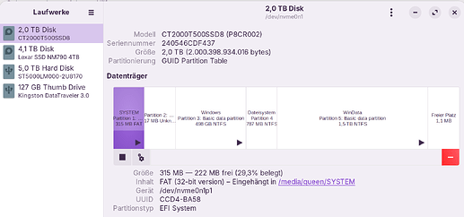

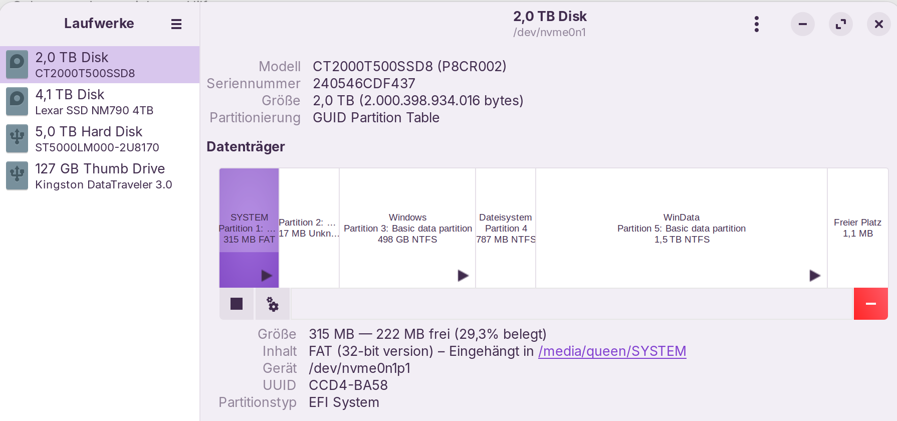

If you have your dual boot both OS Zorin OS and Windows installed on the same system disk both OS share the same EFI Boot. It could help to backup your EFI boot partition with the Disks Tool.

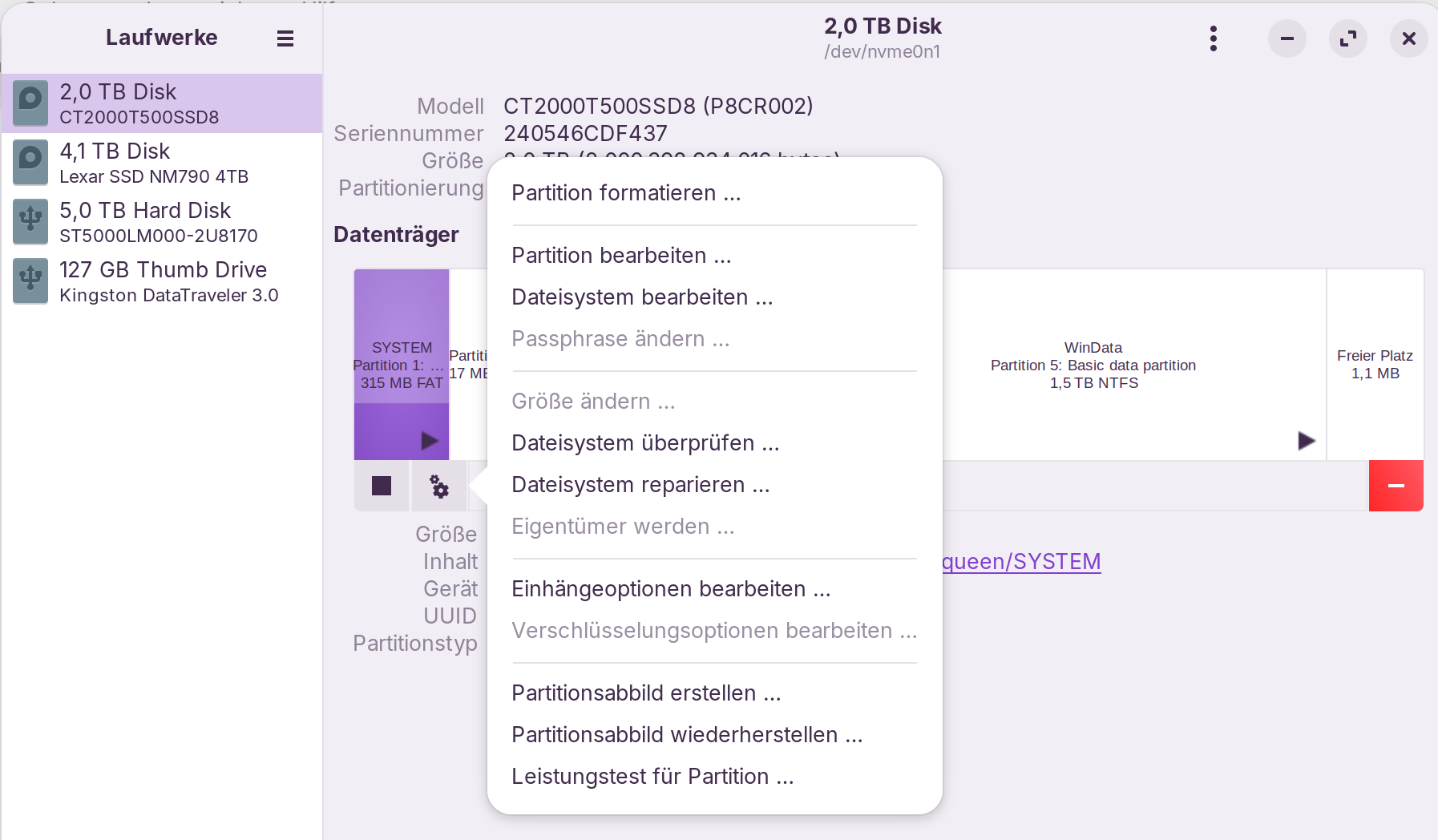

You can choose with a left-click context menu "Partition Image Create" and follow the instructions.
Then you could later restore this partition, if something got broken or windows has overwritten it.
