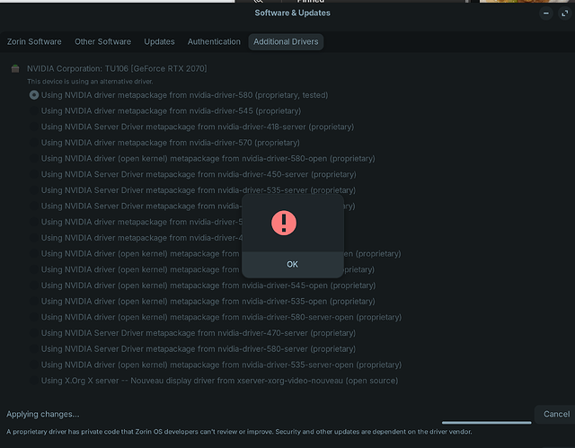

I cannot change drivers
I get this whenever I switch drivers. None of my games are working, they all crash on startup.

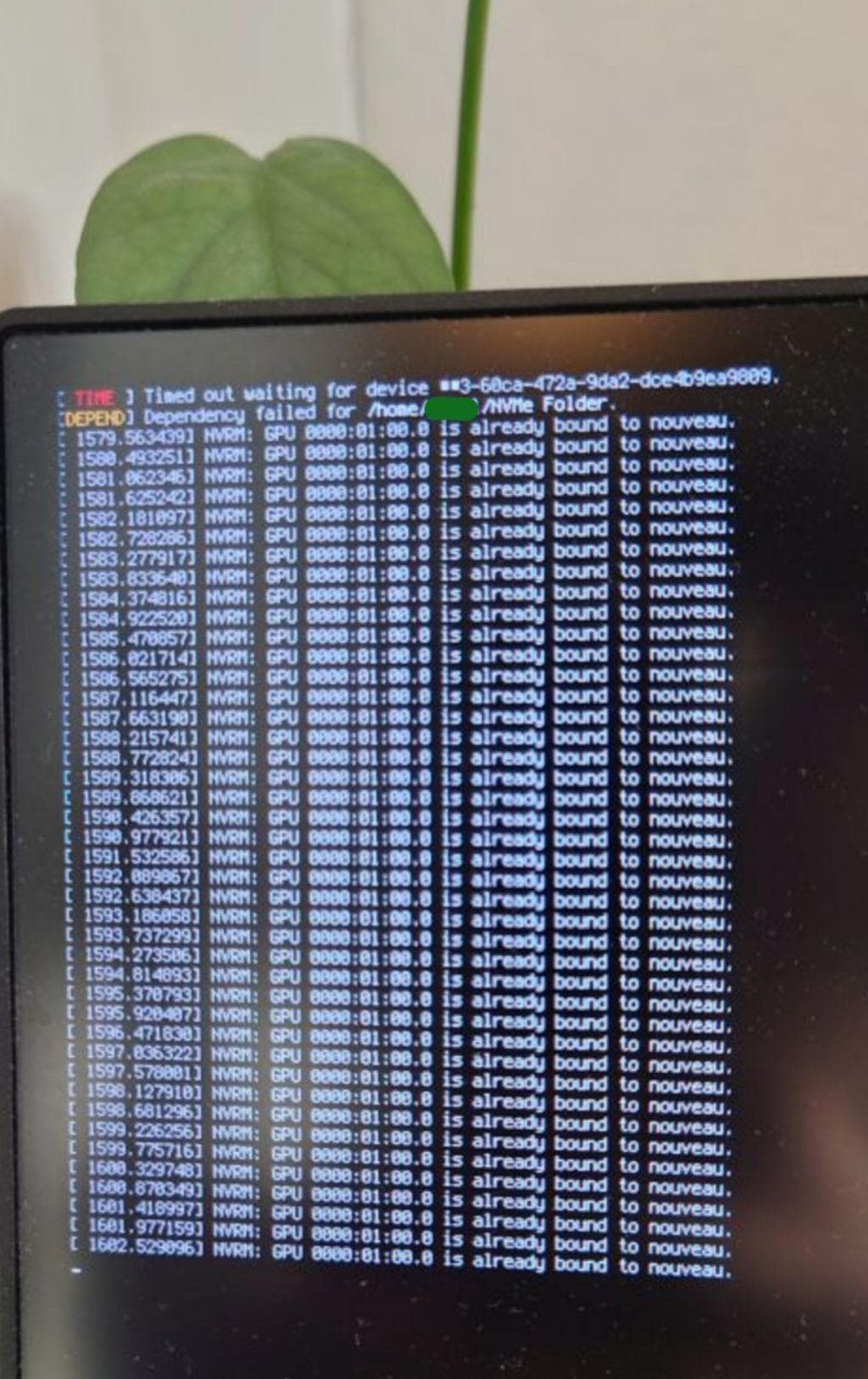

I then restarted, and got this before the computer shutdown to start again:

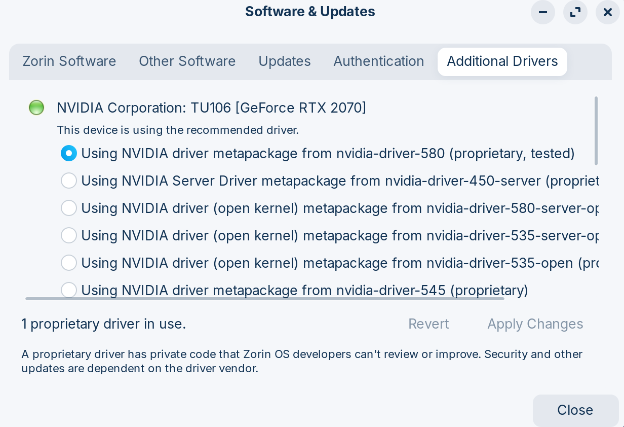

Edit: This doesn't really inspire confidence, why is the GUI saying one thing and the CLI another thing?

  • Why was there a mismatch between the GUI and the actual state of the drivers?
Thank you once again, hope you have a great weekend.
Though separate, I believe all questions touch on:
The GUI relies on these files to know what you are running and if they are mixed, you can get incorrect reporting.
And the GUI driver management lacks the action of removing the old files. For this reason, I recommend installations of the Nvidia Driver be done solely through the CLI after purging all old files.
