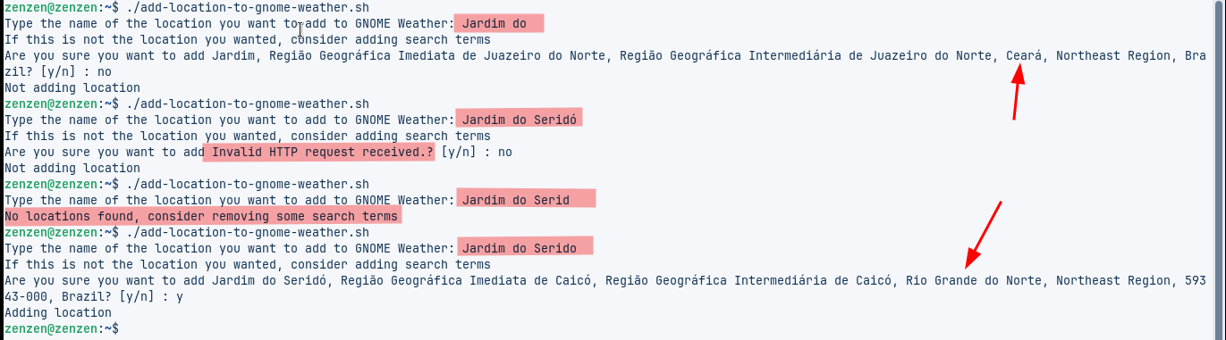

For example, I'm using a city in Brazil called "Jardim do Seridó", in the state of "Rio Grande do Norte", which does not appear as a valid location in Gnome Weather:
Notice that I ran this a few times trying different combinations of the name of city. Sometimes, I got an incorrect result (first result), while other times I got an invalid response, or no results at all. So, when you use this script, make sure to remove any non-ASCII characters if you can like ó to improve the search.
After this, it loads right up:

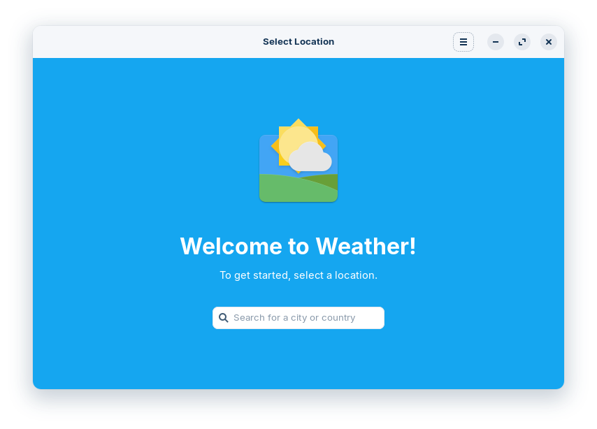

Is this the .deb Version of Gnome Weather or the Flatpak? Did you manually added Your Location or was it set by Location Services?
Default time date app
And when You type in here Your Location:

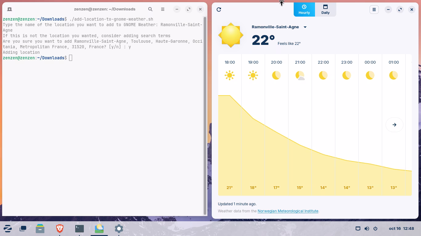

I have the same issue, i'm in France in a city named "Ramonville Saint Agne", it doesn't find it so instead i use the closest city which is "Toulouse"

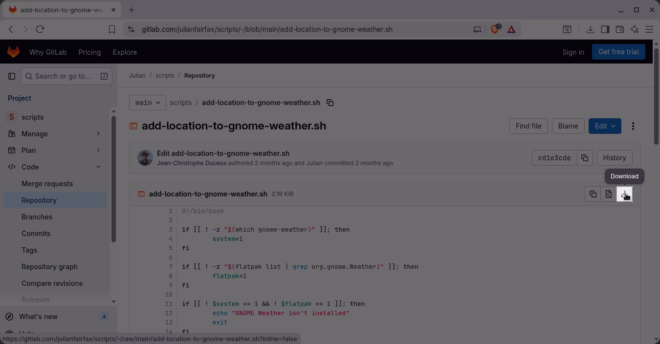

By the way, on the site to download the script, there's a button on the right-hand side of the screen to download it directly:
Yep thats my city
I'l add download the script when i'm home.

just added it with the script, thanks !
