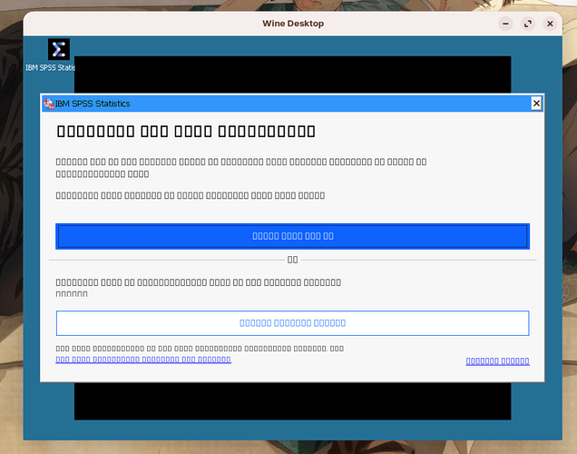

How do I make my IBM SPSS Statistics program to run properly on Zorin Os, so far it looks like this, its a window app I dowloaded from my school website. Help, please I need it.
In terminal, can you please run:
sudo apt update && sudo apt install ttf-mscorefonts-installer
Follow the prompt to install Microsofts fonts.
Once done, fully reboot the computer, then test the IBM SPSS software in WIne.

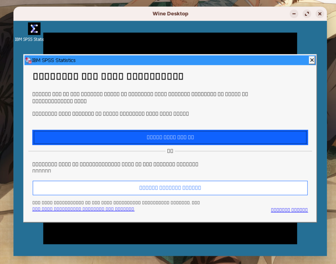

it work but now its not accepting the school key license.
Installing fonts would not cause that... It may be that now you are able to read the screen informing you of that..
You may need to check with the school on the license.
Do other students use that software in WINE? It may be that in WINE, the license cannot be properly accepted, a lot like how Steam Games using anti-Cheat think that WINE is spoofing.
I am speculating here.
As an Alternative, You could try it with running it in Bottles.
