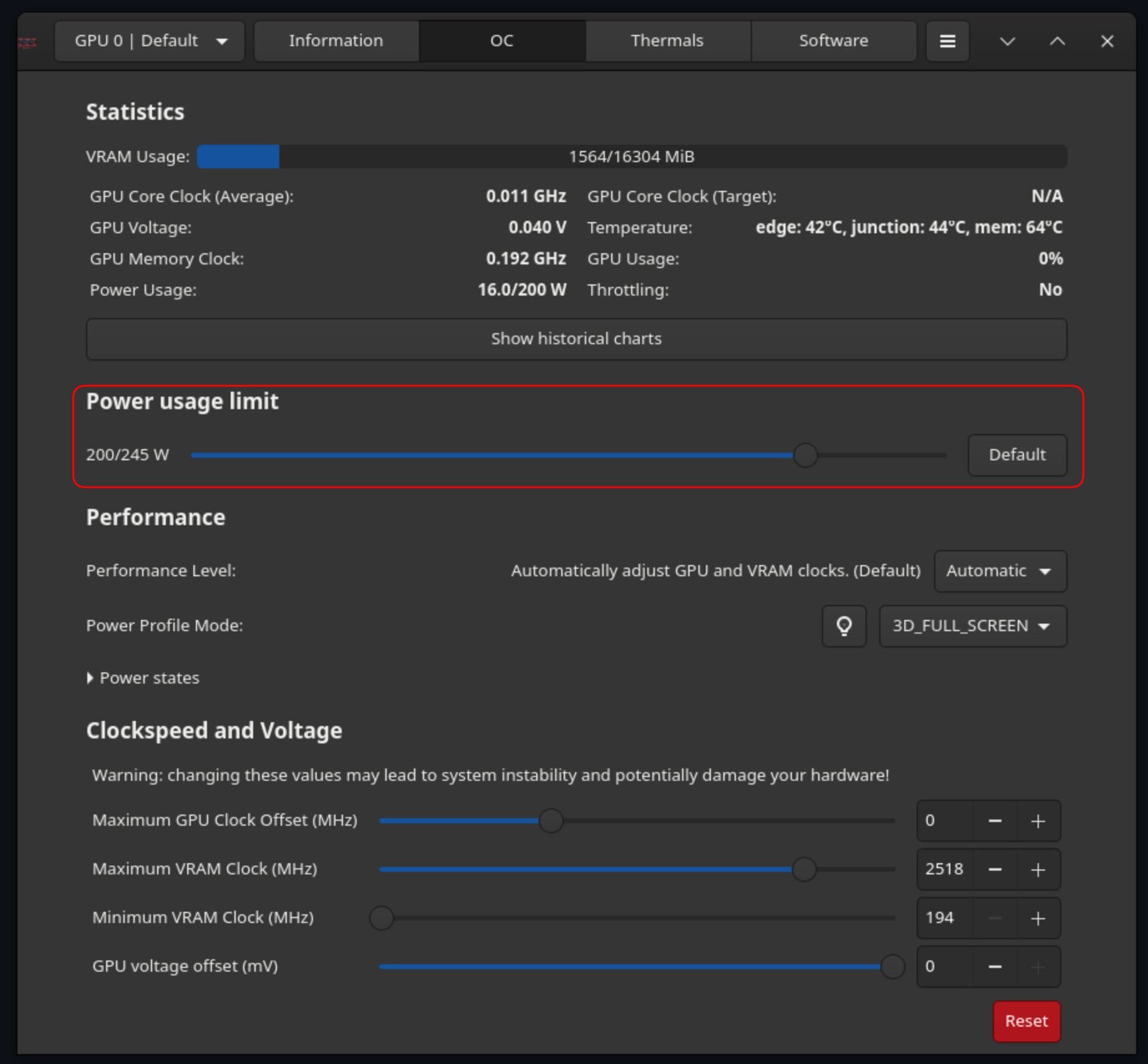

For setting up the Power Limit, I would have 2 Ideas for Tools. the first one is called LACT:

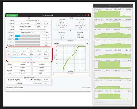

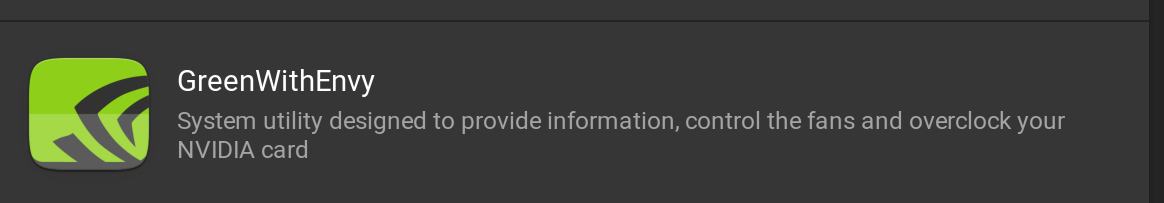

The other one is called GreenWithEnvy and is available as Flatpak in Gnome Software:

In LACT it should be this:
In GWE here:

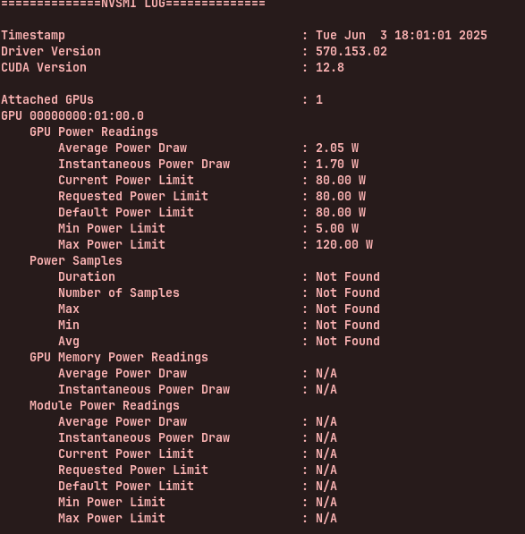

Can you run the terminal command nvidia-smi and show us what it says?
570, ich könnte nochmal 550 probieren.
Einen Moment mache ich sofort.
Ich habe den aktuellsten Treiber installiert der vorinstallierte von Zorin os hat keinen Unterschied gemacht
Die Person hat anscheinend das selbe Problem wie ich.
Und das steht bei mir auch.
This is followed by an output:
Changing power management limit is not supported in current scope for GPU: 00000000:01:00.0.
All done.

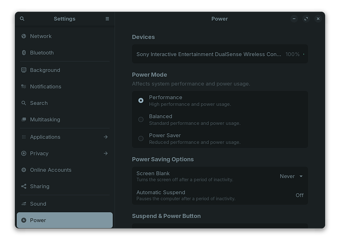

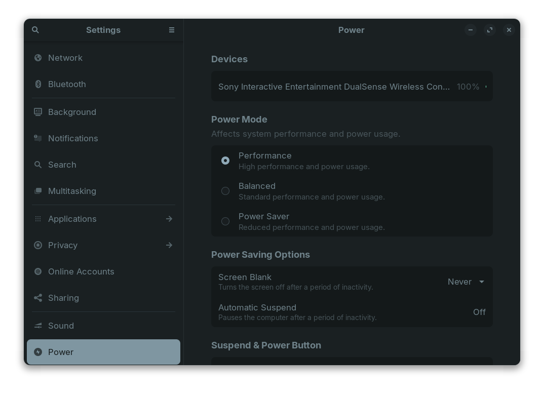

This seems like it should be obvious, but I'll ask just in case, based on the Nvidia forum link you posted. Does your computer have a "performance mode" option in BIOS or as a hardware switch? Possibly as a key combination? I've seen all three of these.
If not, are you set to performance mode in Zorin's power settings?
It looks to me like either the manufacturer or Zorin are trying to keep your power usage down to save battery. That isn't what you want, but if HP locked you into that, it may be difficult to change.
Like @Locklear93 already wrote, would it be good to check the Power Settings if You have the Performance Mode enabled if available.
