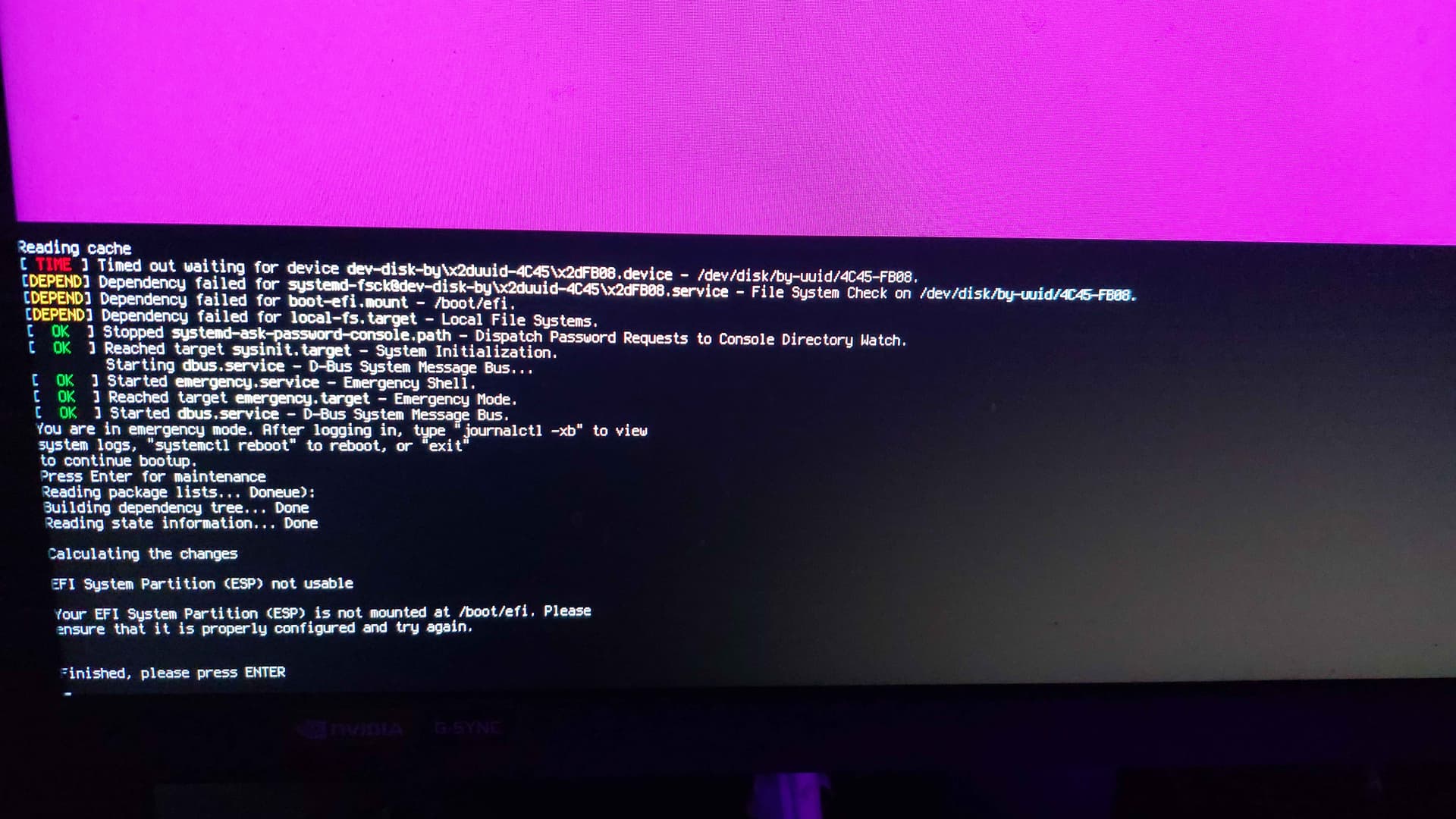

I'm dualbooting Zorin and Windows 11 on an external SSD that I have to move between two computers every two weeks because of my living situation. I moved again today and everything stopped working. It will fluctuate between a couple different issues, seemingly completely on random:
-Stuck in emergency mode, unable to boot normally
-My drive isn't being mounted correctly at all
-Sometimes it will randomly proceed to login, but become unresponsive as soon as I enter my password
-Sometimes it will get past the login screen but my graphics drivers don't work and then it goes back to issue 1 or 3
I'm running out of ideas here. The only pattern seems to be that it's some drivers issue? Please help.

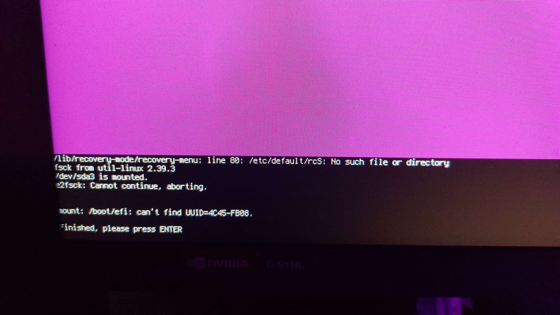

If you do not have a LiveUSB Handy... If you boot your computer as is - reach the Grub Menu, then select Advanced Options For Zorin, then select Zorin On 6.xx.x.xx (Recovery)
In the Recovery Menu, error key to second from bottom should be an fsck option.
This one is a bit less thorough than performing it the way outlined above - but may be good enough.

@Aravisian thank you for your very thorough answer! I'm trying to follow best I can but I'm running into an issue where the arrow keys don't work in recovery mode...? Got any idea what that's about?
No, that is new...
Did they work earlier when you selected the earlier kernel?
@Aravisian I tried just now. They do in fact work, however trying to follow your previous instructions that were interrupted by the keys not working, I end up on this screen
I think the one with the OS is SDA3, it's a partition

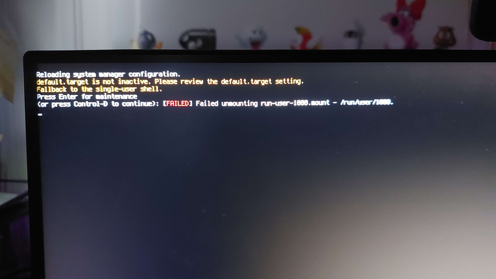

Got into my desktop in the old kernel 6.17.0-20, but in a safemode of sorts , so my displays were using some other driver or something. I got there by spamming CTRL-D in the emergency mode screen. This came up after hitting restart
Just to clarify - you did reach the desktop - But after rebooting, you saw the above screenshot? That aligns with the GPU file inconsistency you outlined in the O.P.
What that screenshot shows is corruption in your root directory, /etc/systemd/system/default.target, SystemD cannot resolve it and tries to fallback. But, the important thing is that this returns the File System Files are damaged or inaccessible.
This is an external drive, connected by USB...
To me it looks like unsteady USB connection has created a lot of filesystem errors that have built up over time.
