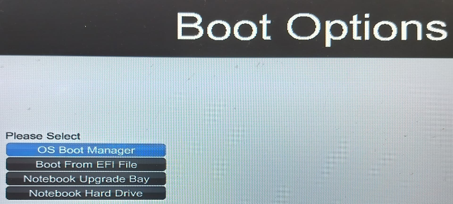

I cannot start Windows 10. I found two ways to get to the dual boot screen, way 1 ends with Zorin starting up, way2 ends in a loop ending with the dual boot screen.

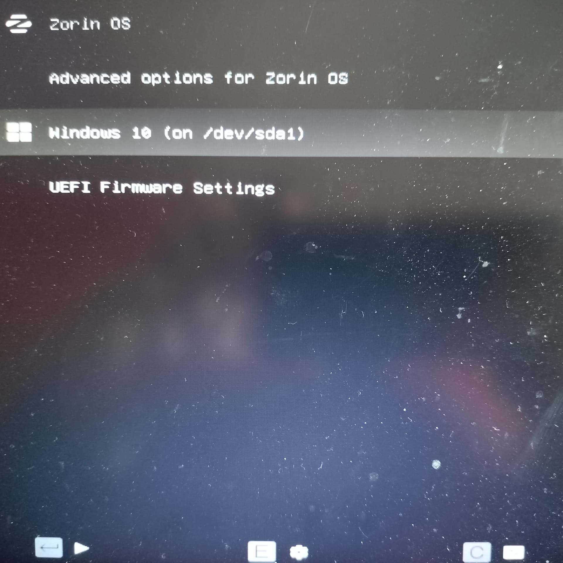

Screenshots from way 1:
After a couple of seconds after 'Enter', Zorin starts up successfully.

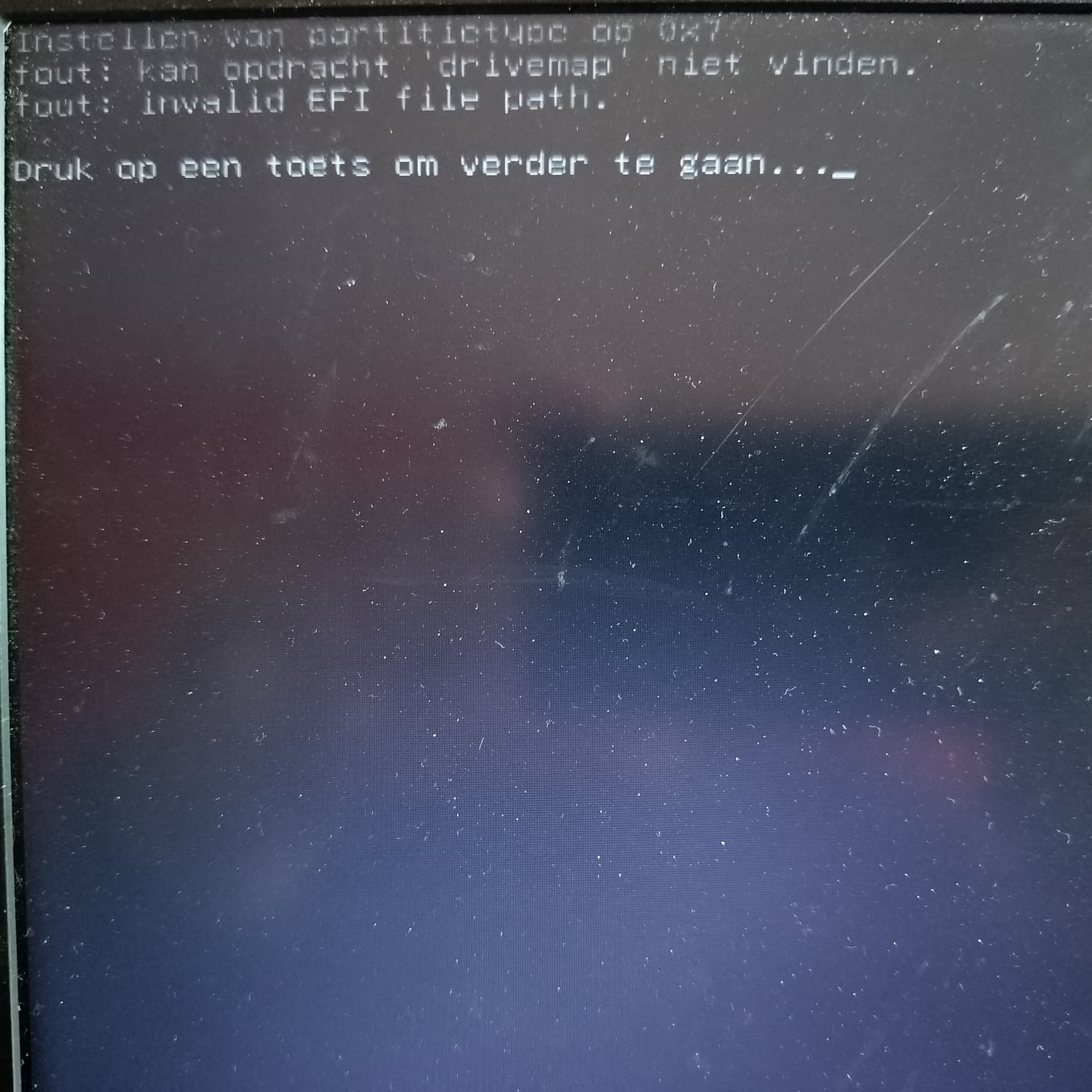

Screenshots from way 2:
The screen says:
Setting up partitiontype on x07
error: cannot find instruction 'drivemap'
error: invalid EFI file path.
Press any key

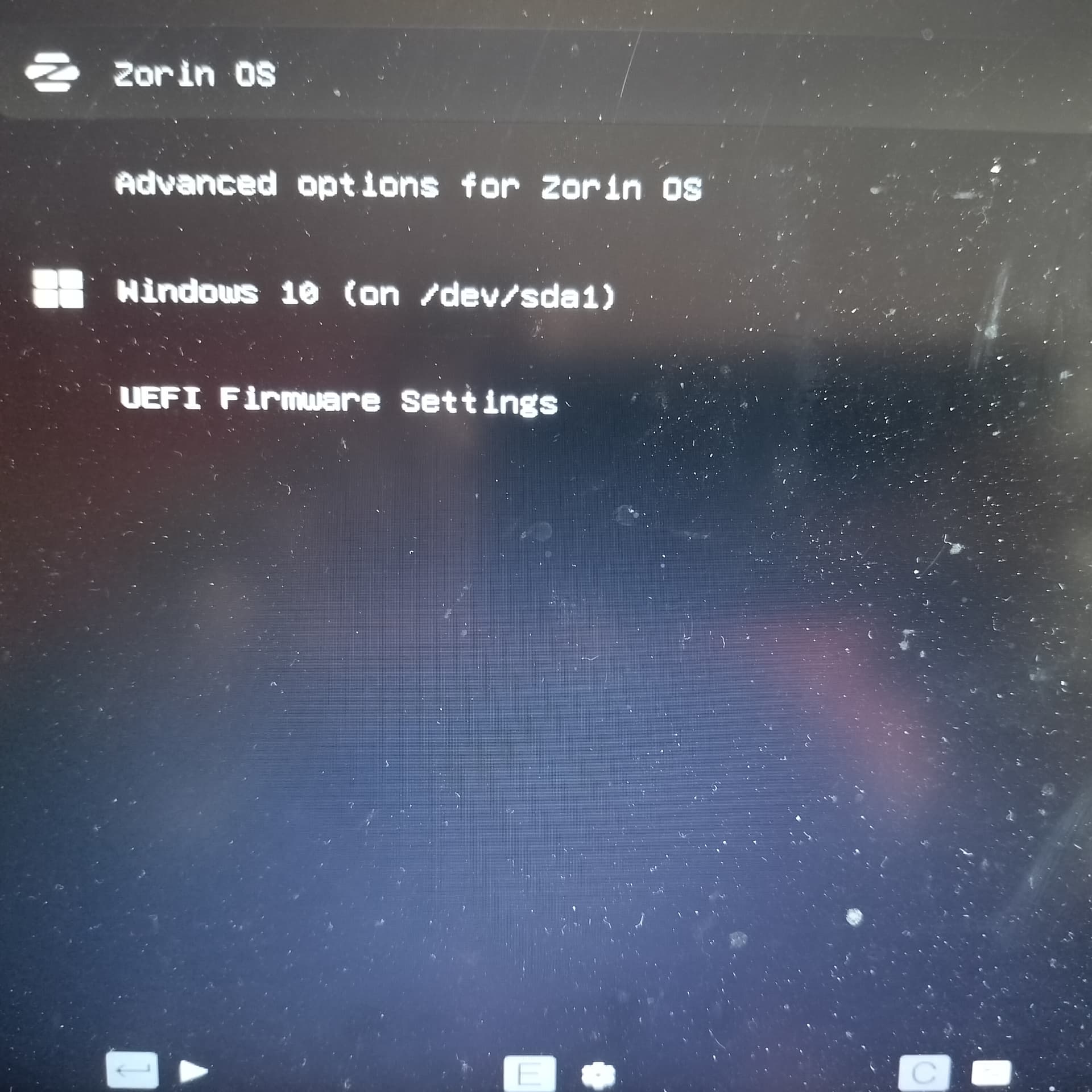

Upon 'Enter' the dual boot screen appears again. Neither Zorin nor W10 start up automatically (which is ok here), see screenshot below:

Starting Zorin Live from BIOS was successful. Ran Boot Repair. Restarted with Live USB removed, dual boot screen showed, chose W10, and guess what, Zorin started.
What do I have configure how to be able to chose either Zorin or W10.
You clicked on the Windows Entry and Zorin started?
What this tells me is that you installed Zorin OS as EFI but Windows OS was installed as MBR (Legacy).
There is no EFI bootloader for Windows OS, since it is MBR.
To fix this, you must either convert Windows OS to EFI and add a bootloader or convert Zorin OS to MBR.
