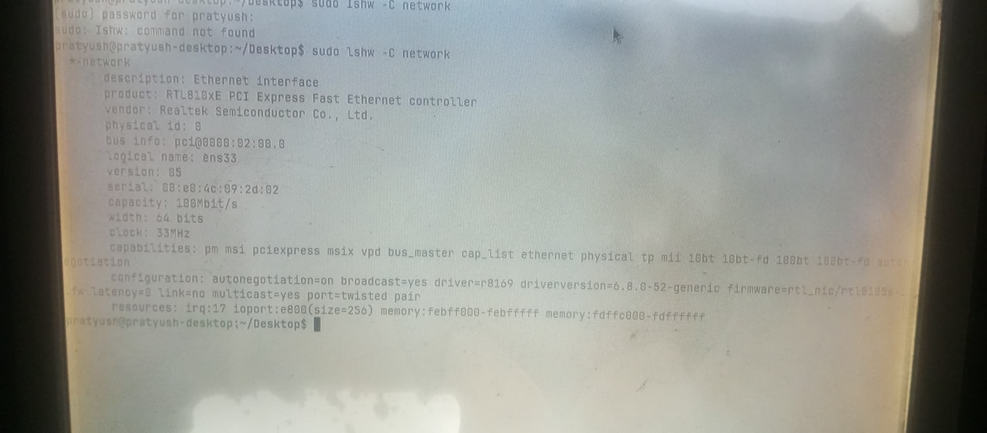

In terminal, can you please run
sudo lshw -C network
Please relay that output here - This is to try to determine which hardware you are using and what drivers you need.

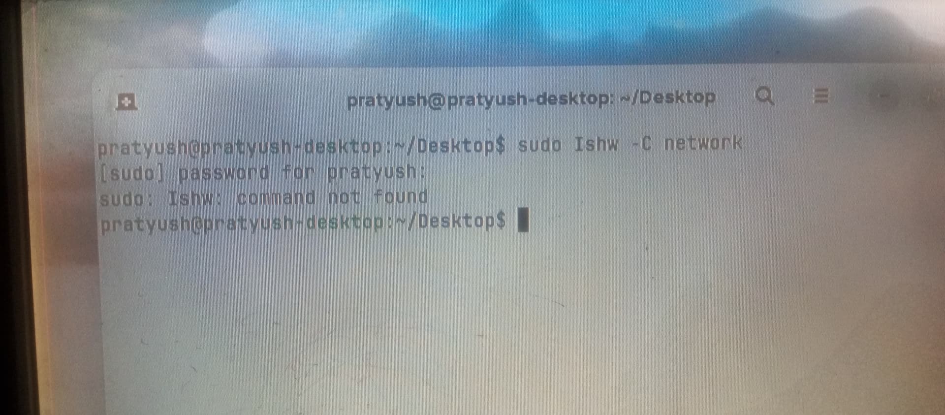

What to do now..?
It is a lower case L not a capital I...
lshw which is LiSt HardWare. :wink:

It lists the Ethernet, but it does not list any Wifi... Is your Wifi device part of your motherboard or a separate plug and play device?
(Like a USB network adapter.)

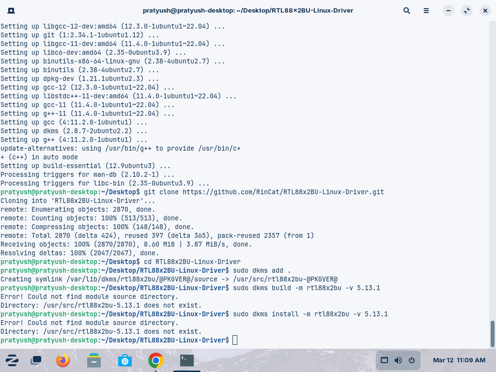

Well... Let's go ahead and install the driver. I looked at different sourcs and picked this one due to it offering DKMS support:
Each command can be copy/pasted and run one at a time. If you see an error in the terminal, please stop and relay that error here.
sudo apt install dkms build-essential git
git clone https://github.com/RinCat/RTL88x2BU-Linux-Driver.git
cd RTL88x2BU-Linux-Driver
This next step of three separate commands adds DKMS support, so that you do not have to reinstall the driver everytime the kernel upgrades:
sudo dkms add .
sudo dkms build -m rtl88x2bu -v 5.13.1
sudo dkms install -m rtl88x2bu -v 5.13.1
With that now installed, we can use the Module Prober again:
sudo modprobe 88x2bu
Is all process gone correct?
Can you try:
sudo dkms add -m rtl88x2bu -v 5.13.1 --source-only `pwd`

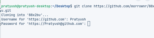

git clone https://github.com/morrownr/88x2bu.git

after the first step of cloning from github ,it ask me username and then password but it got stuck after asking me for a password...else everything is working properly but i am unable to enter the password there
what to do next?
Can you show a screenshot?
sure..
Heh wow... I see. The maintainer moved the repository.
It is
git clone https://github.com/morrownr/88x2bu-20210702
That should get the driver files. Sorry about that.
