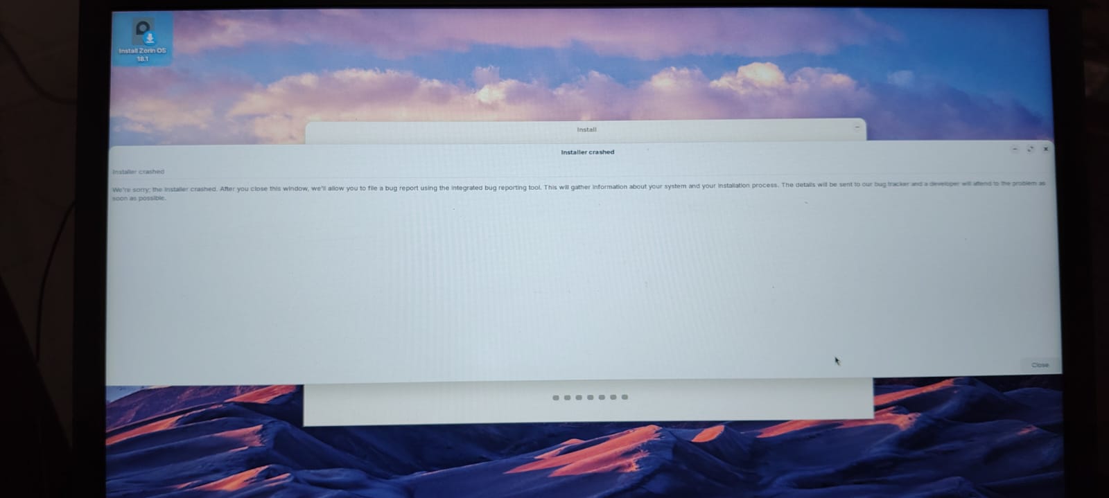

I tried with manual partition (something else) but always crash during installation.

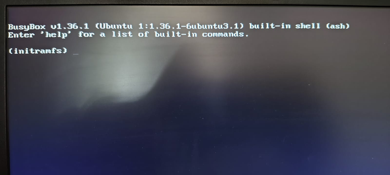

I tried using gparted and KDE partition manager from live USB but when installation completed and PC restarted, the boot process doesn't ask passphrase key and stop in initramfs (busybox).

Did You get any Error Messages? If yes: Can You say them?
Maybe try it without the extra /boot Partition? Create and EFI-Partition, a / Partition and /home Partition.
This error message was appear in first trial during installation process after i made manual partition (something else option) with root and home partition encrypted.
This message was appear in second trial after installation completed and restart the laptop.
I made manual partition using KDE Partition Manager from live USB with root and home partition encrypted.
Hmm ... that doesn't helo because the actual Error isn't included or shown. Is something what should be improved.
When You here type exit does the Screen come back? Are Secure Boot and Fast Boot in BIOS disabled? Was this a Try without the extra /boot Partition?
