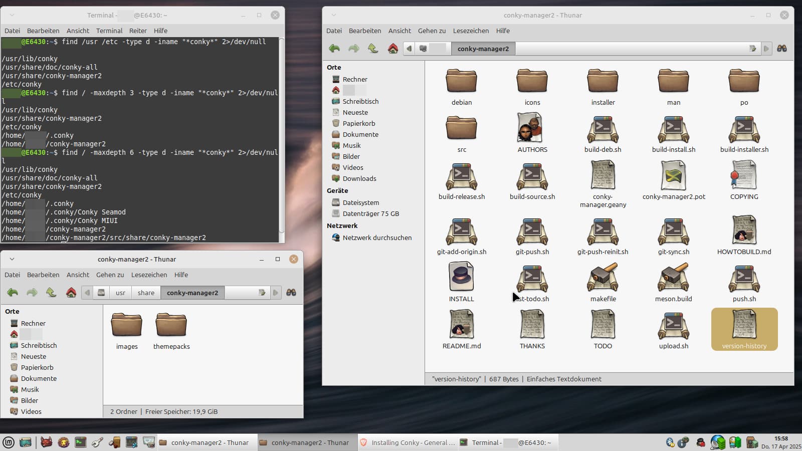

I have found the conky-manager2 files in the following locations:
  1. ~/conky-manager2
  2. usr/share/conky-manager2
Should I merge them all into a single folder and then save it in /usr/local, for example?
Which child folder on the screenshot contains the source code?

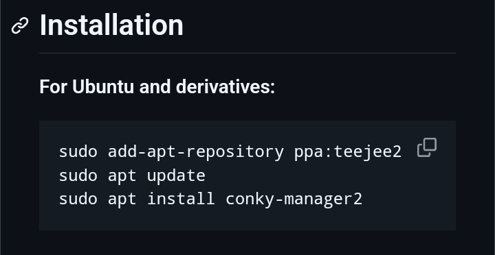

It was not necessary to build it from the source, as an Ubuntu based distro you should have followed instructions for ppa and install it using apt. It's lot easier to manage with apt in case of removal.
I read here in the forum that there were problems with the use of ppas for conky. Aravisian recommended in a thread to compile the conky-manager2 yourself. That's why I tried it this way. But yes, it is quite complicated. Since I'm not familiar with ppas at all and so often some warnings appear because of it (e.g. before downloading or during updates/upgrades), they are a bit scary to me. I had looked at the teejee ppas before, but a lot of them are no longer maintained. There is still a ppa from tomtom or from ubuntuhandbook1 for the conky manager - yes, and it all kind of overwhelmed me.
I'd suggest going with the easy route first, and only go for the compilation option if you run into any issues. I'm not familiar with Conky, so I'm not sure what issues are to be expected, but this would make things much easier.

If you compiled from source, you are fine. There is no need to try shuffling file packages around, though. They install where they install for reason. Changing that is probably scarier than using a ppa....
