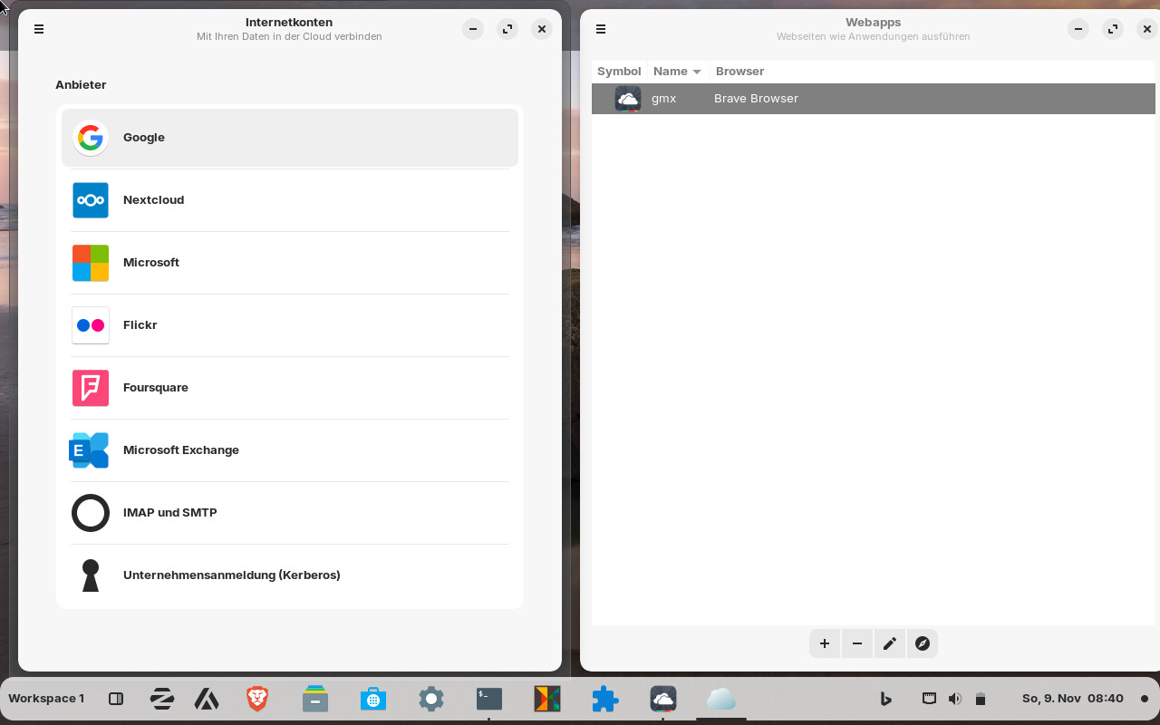

I try to find out if it is possible to make Zorin 17 a little bit more than Zorin 18 (for those who are still on Zorin 17 and like some fuctions of Zorin 18) and I came across mint-tools.
I added the ppa:kelebek333/mint-tools
and installed "webapp-manager" and "gnome-online-accounts-gtk".
Is it safe to use this ppa in Zorin? Can one keep it at sources to get updates for the apps?
I'm not sure because I got an error during installation of webapp-manager and had to run sudo apt install -f. But both apps are installed now and seem to work.
I'm also testing PaperWM because of this the window is cut.

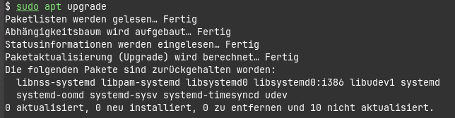

Do you know what to do with these packages?
These are hold-back Packages. Normally they are hold back to avoid Issues with other Packages. When You wait a couple Days, they should be updateable. Alternatively, You can install the Packages with a sudo apt install if You don't want to wait or You don't want no longer wait.
Shall I not delete them? Do I need them? I think something has messed up my package manager. Today I wanted to install lxqt and I got errors with dpkg and the installation failed. There was the option to login into lxqt session but it didn't open. Synaptic says I have a broken package and I tried to repair the dependencies with synaptic but also failed.
Edit: With terminal commands I was able to repair and now no defective packages are shown in synaptic. I removed all packages that contained lxqt and xapp in the name. The hold packages are still there when I try to upgrade.
Do You have removed the mint-tools Repo?
Yes, I have removed it.
I guess, then these are really Updates. Wait a couple Days and see if it will switch and be updateable. Hold-back Packages are not rare or uncommon.
Thank you, then I'm reassured; I've never noticed anything like that before.
I did. Even in the Software UpdaterYou can theoretically see that when You have Packages that are updateable and some who are not. But wait a couple Days and when nothing happens, You can install the Packages manually with sudo apt install and then they will be updated.
