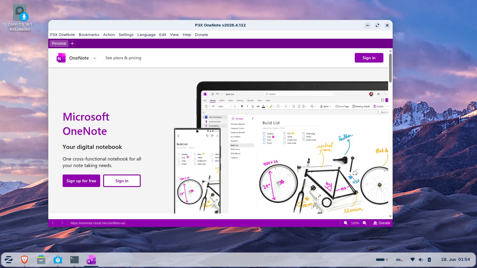

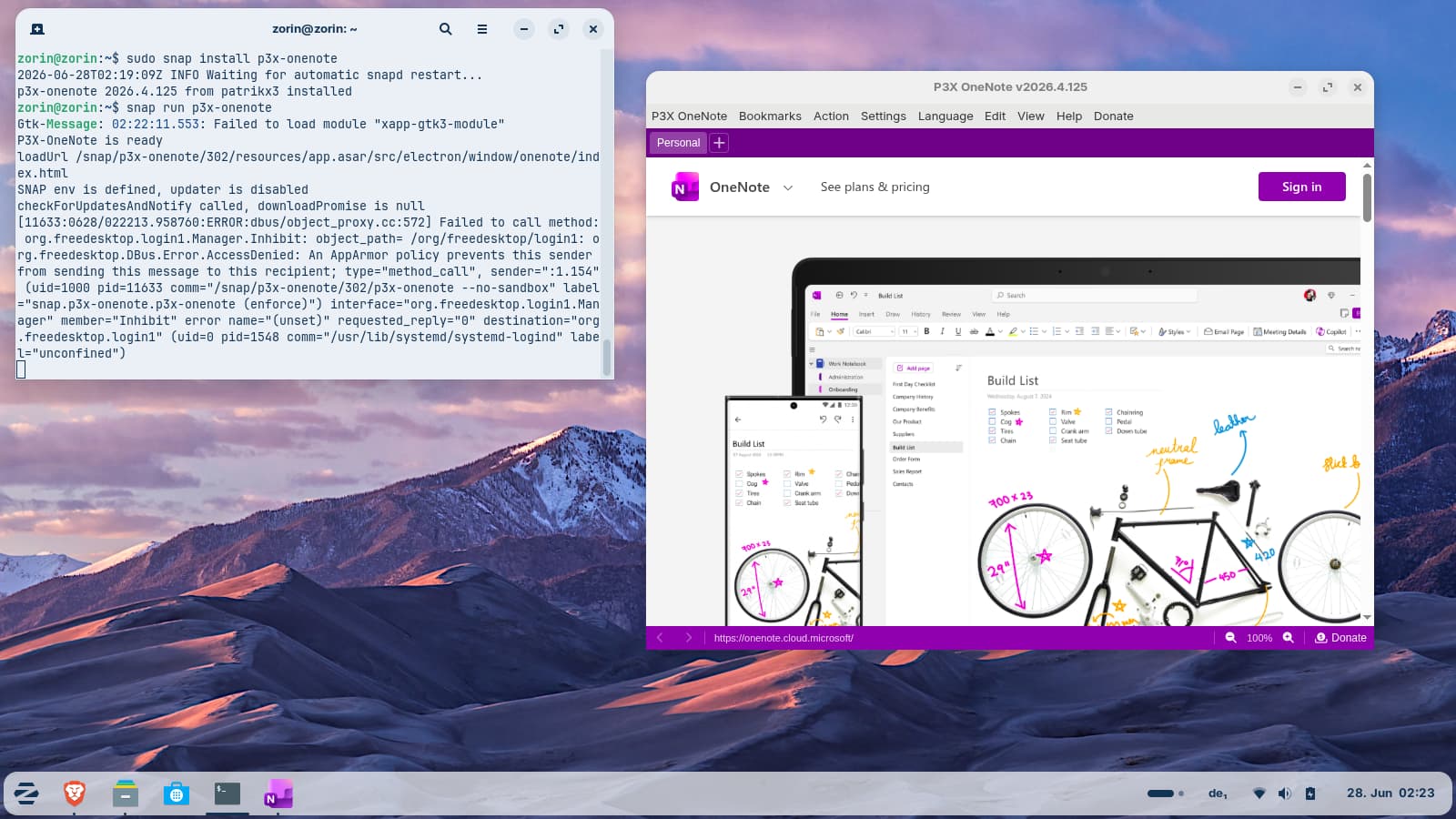

I'll test the installation later for you. I read on the github site of the developer that the app was still in development and had bugs.
You could try to install the .deb package to see if it runs better:
p3x-onenote_2026.4.132_amd64.deb
https://github.com/patrikx3/onenote/releases/download/v2026.4.132/p3x-onenote_2026.4.132_amd64.deb
Download the .deb package and doubleclick to install it.
Or, if it doesn't help, you can test the Appimage version.
If you want to test other versions, it is the best to remove the snap package first.
Edit: The .deb package works:
The .deb package and AppImage auto-update themselves, that's good.
The snap package also worked for me, but showed "Hang on, loading OneNote takes some time".
