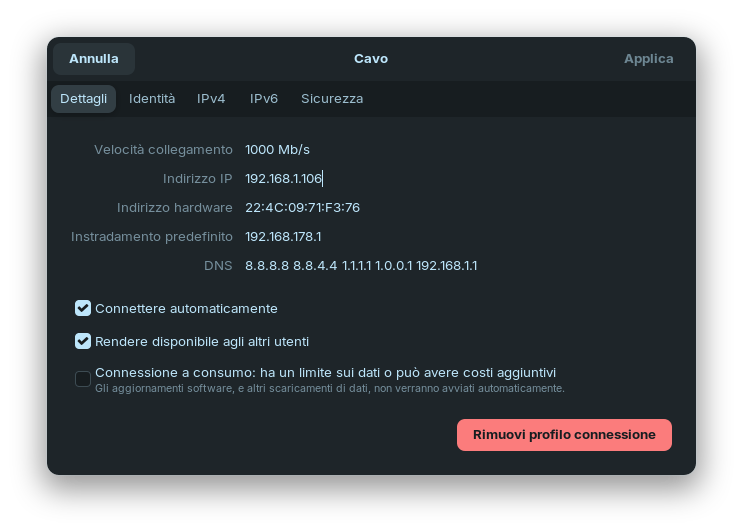

I wanted to try ZorinOS Core by installing it. Everything went fine with the installation but when i rebooted to the installed OS i have internet issues and after a while the OS doesn't see my wired cable anymore.
I have a r8625 and this is the configuration that it shows
The configuration is wrong since my router is on 192.168.178.1 so the devices on my local network works on 192.168.178.x i tried putting the manual configuration but it still doesn't work
I am using USB tethering from my phone to write this so that i can do whatever it needs for this issue to be fixed.
Thank you everyone in advance for your help!
EDIT: I want to add that the first screenshot is with DHCP on but it will show the sam thing even after manually changing the network configuration

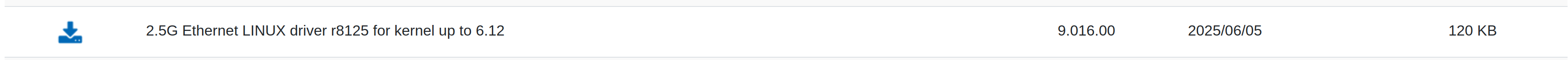

Tried 6.12,6.14 and 6.15 but nothing. Also tried installing the official tar.gz from Realtek.
And did that help? You did take it from here, yes?
And there this one?
