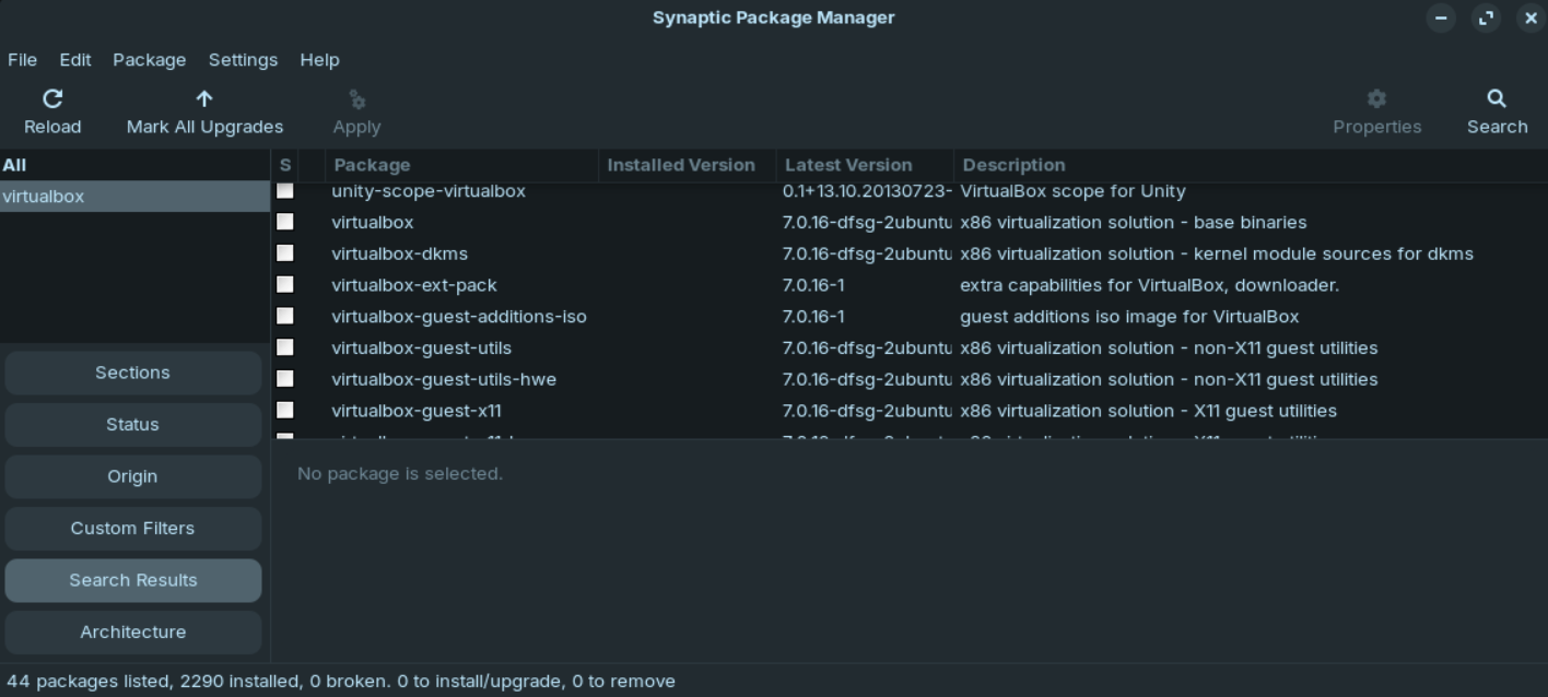

My question... Is it safe now to install Oracle Virtualbox from the repo? I saw mentioned in another thread that an updated Virtualbox has been back ported that fixes the KVM issue with AMD Processors...
But when I look in the repo it appears to be the same old version (7.0.16) as before?
It should be okay now. As You already mentioned: there were made Uploades for Fixes.
Or if You not convinced, You can add the VirtualBox Repo:
For Zorin 18 take ''noble'' for the Repo.
