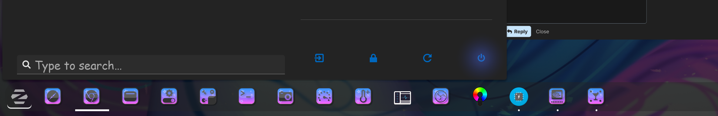

I believe you're talking about mainly the terminology used when clicking the power off button, and yes it is a shutdown (if you want to verify, send us a screenshot of exactly what you're talking about, but I assume you're clicking the power down button then the prompt comes up asking if you'd like to shutdown)

I think there is a difference to be noted between Windows Shutdown (i.e. default with "Fast Start-up" enabled) and Zorin power off, in that Windows shutdown goes into a semi-hibernate mode to enable quicker subsequent startup.
ZorinOS power off is like Windows shutdown with "Fast Start-up" disabled i.e. full apps and operating system closure shutdown.
