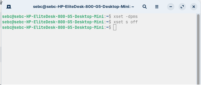

In terminal, can you run If using X11 Xorg:
xset -dpms
Then run:
xset s off
And test.

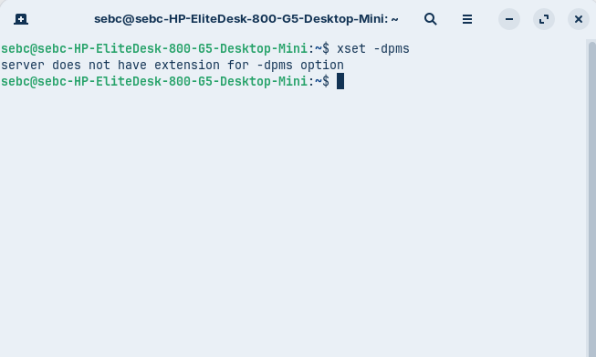

If using Wayland... well, there are no settings at all.
Is that normal ?
You need to switch to Xorg first. In Wayland this command doesn't work.
Logout and at login click on your username then a cog wheal appears at the bottom right corner. There select "Zorin Desktop on Xorg".
Now all screensaver functions are disabled. Is it better now for you?
Nope, issue just occurred once more.
