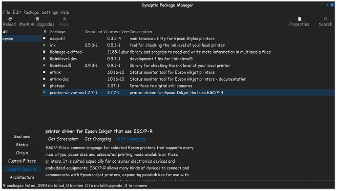

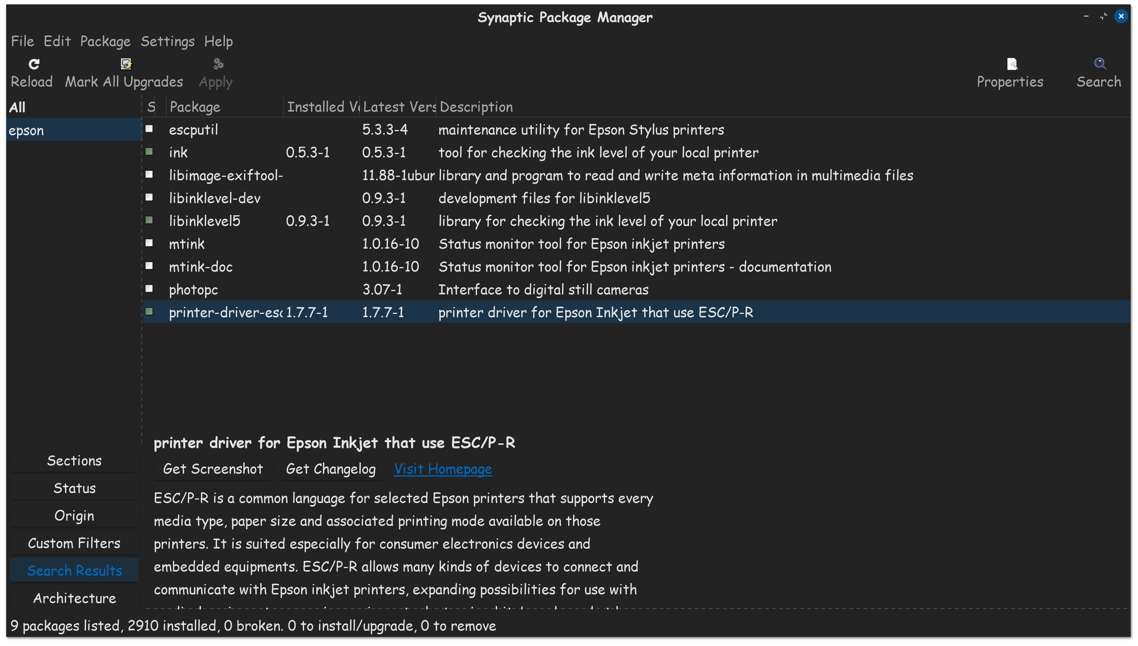

I love to use Synaptic Package Manager, for finding specific driver & component software, that may not be found, in the software store itself. I typed in Epson, & this is what I found. Make sure the bottom one is installed at the very least.

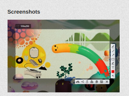

So used to Lightshot from windows for screenshots. Wish the Print Screen was more like this.
https://app.prntscr.com/en/index.html

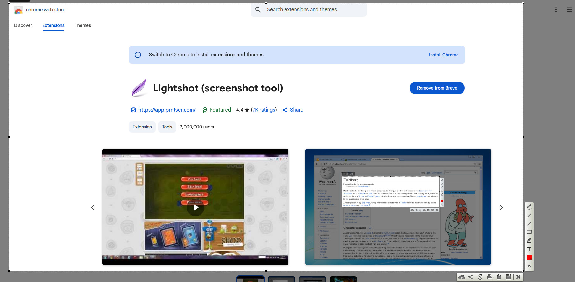

A screen shot of a screen shot in Brave.
The Lightshot website said it would install using Wine, yes it installs but Lightshot turns the screen blank.

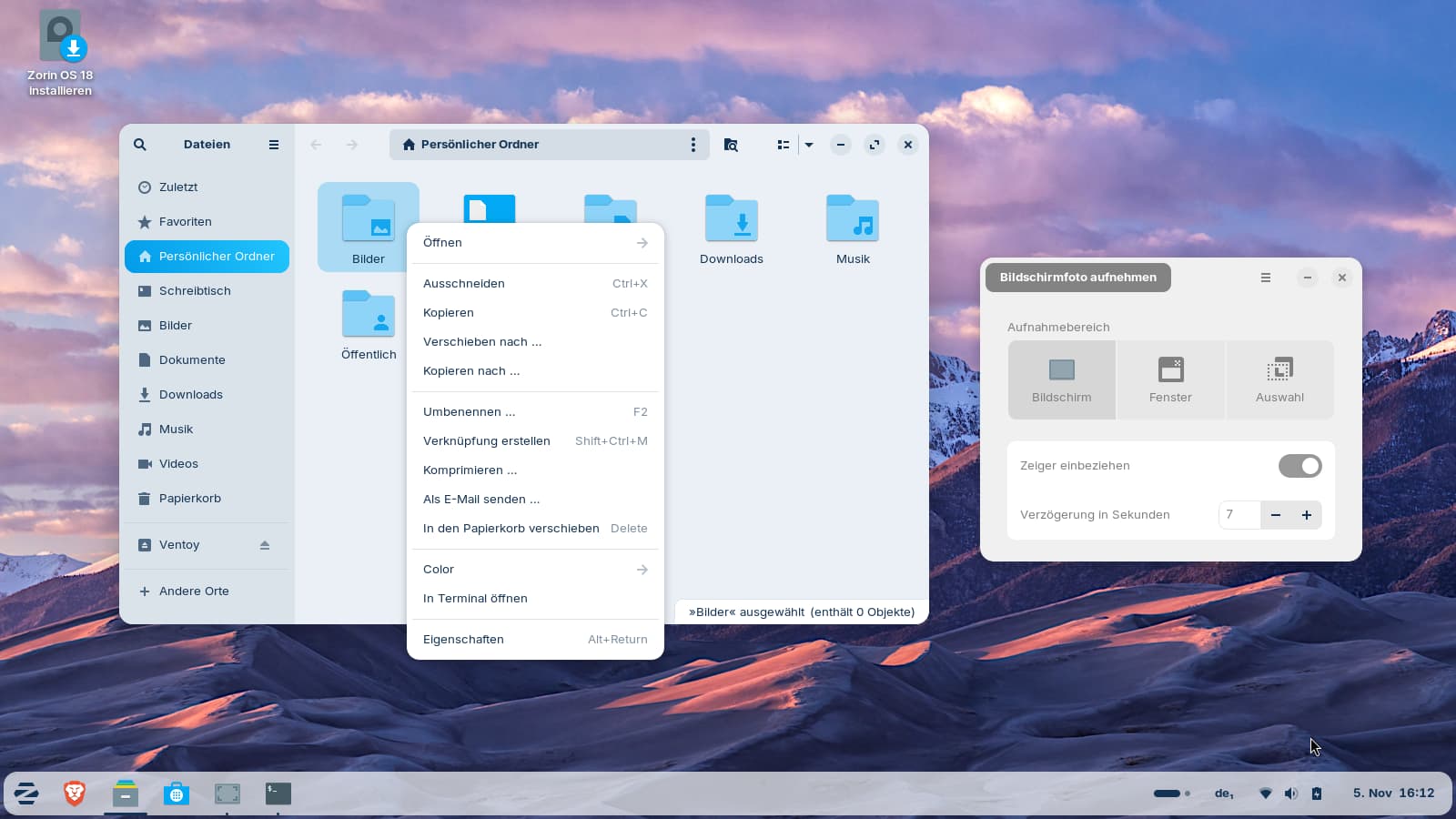

There is a setting to disable modal dialogs sticking to the one behind it.
You can install the gnome-screenshot tool. This tool offers a time delay before the screenshot is taken. You can install it with
sudo apt install gnome-screenshot
It is a simple program which is easy to use.
Disabling the modal dialogs didn´t help to be able to make screenshots of context menues. You can only do this with a time delay.
Edit: You can add a custom keyboard shortcut for the tool gnome-screenshot, then screenshots are taken with this program and not with the default screenshot tool when you press key print.
e.g.
command: gnome-screenshot --interactive
key: Print
Yep, I use Gnome Screenshot. Its a beautiful thing!
I would love to know how to replace the screenshot app used in the quick settings of the taskbar with gnome-screenshot! I really miss the delay function.
Edit: I read that this is not possible because the screenshot function that Zorin uses by default is integrated into the desktop and is neither an app nor a gnome extension that can be replaced.
The older gnome-screenshot tool that was used in earlier Zorin versions has been replaced to ensure better Wayland compatibility. Since I have only tested the gnome-screenshot tool under Xorg so far, where it worked perfectly, I will test it later under Wayland.
Edit2: I tested gnome-screenshot under Wayland, and it works.
I noticed that the integrated screenshot function for some apps like the Nautilus context menu or some context menues of gnome settings only does not work under Xorg (pressing key print does not open the screenshot tool), but under Wayland it works perfectly.
