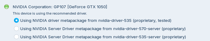

  4. My graphics card driver is "metapackage from nvidia-driver-535" (see screenshot)
The flickering issue with an NVIDIA GTX 1050 on Zorin OS 18 is a common problem usually caused by a conflict between the open-source nouveau driver and the proprietary NVIDIA driver, or by incorrect power management settings. Since Zorin OS 18 is based on Ubuntu 24.04 (Noble Numbat), it uses newer kernel and display server technologies (like Wayland by default) that can sometimes struggle with older NVIDIA Pascal architecture cards if not configured correctly.
