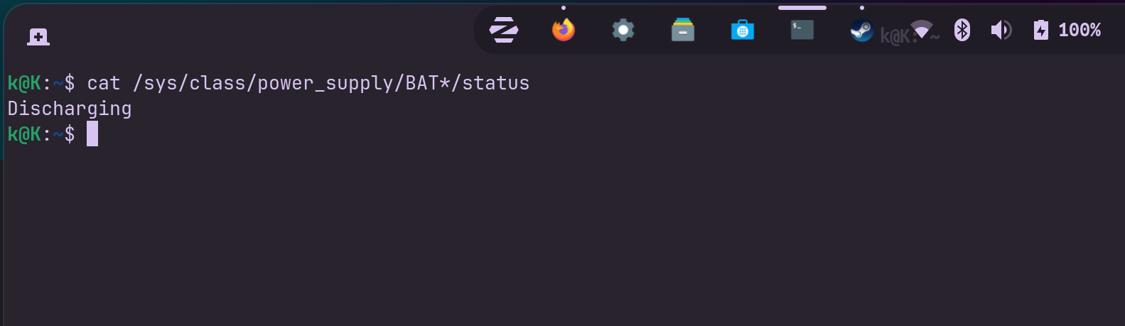

ok apparently that only somehow temporarily fixed the issue, went about using my system and the issue came back again.
EDIT:
managed to capture when system thought my laptop was charging when it actually wasn't.
